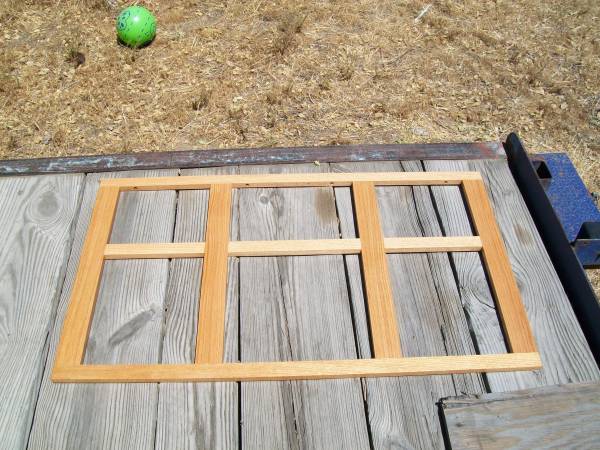

I got one coat of marine spar varnish on the red oak cabin cabinet face frame.

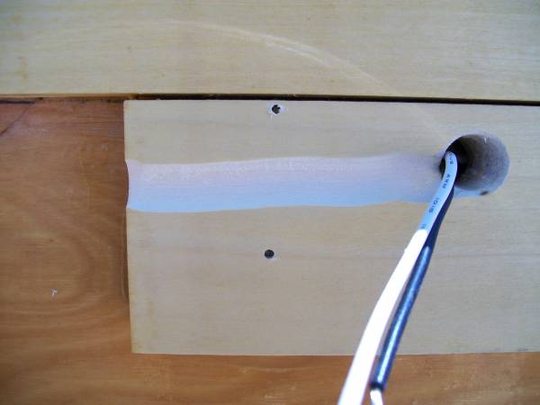

I started on the basic wiring of the fixtures that need to be installed through the outer walls so I can do more of the galley cabinets.

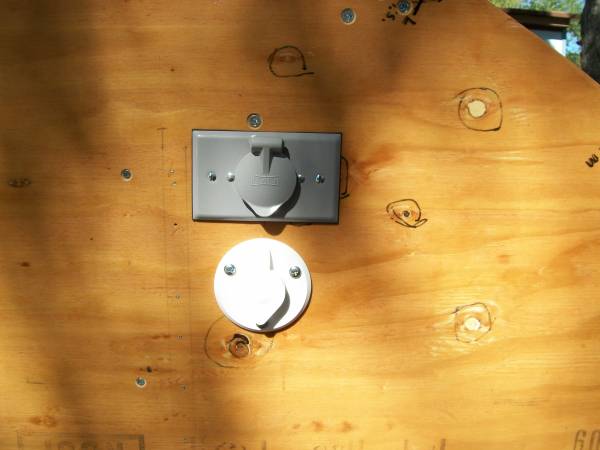

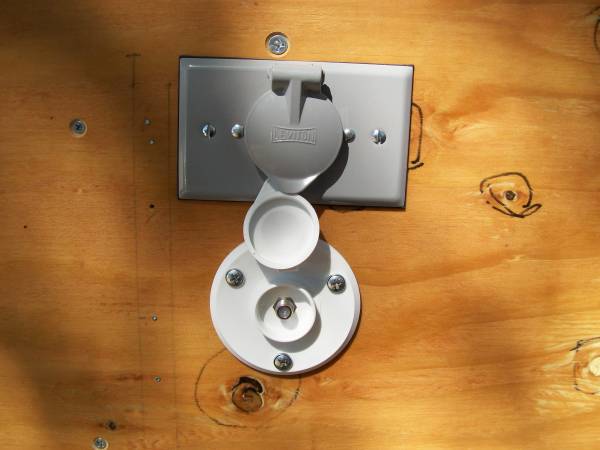

I added the cable TV fitting hook up below the 110 Volt hook up.
Here is how it looks from inside the galley. I will replace the long screws for the cable hook up with SS machine screws that are shorter, later. These screws are only for mock-up now.

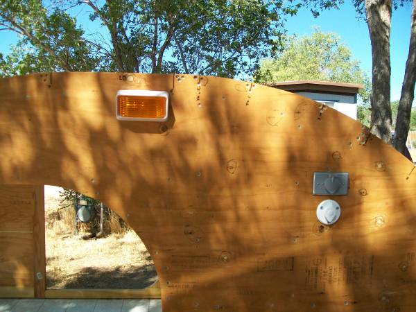

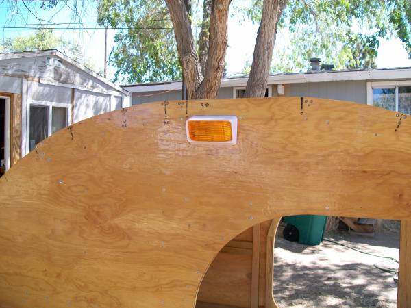

I mounted the porch lights to the sides of the TD, too.

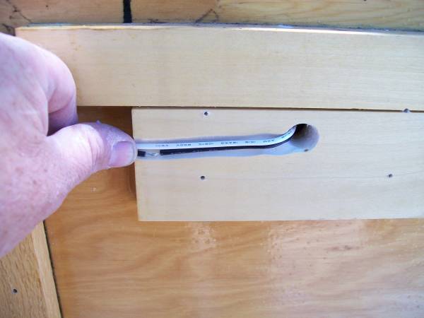

I had to route a trough in the mounting block for the porch light wires so the inner wall skins will set flush against the blocking.

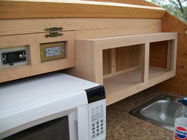

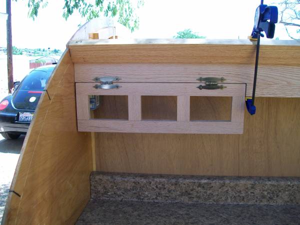

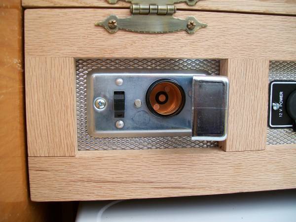

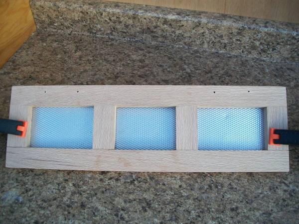

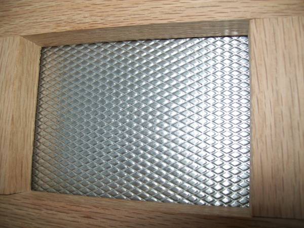

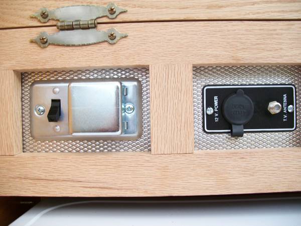

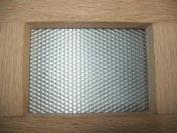

This is a small update because I was trying to make an oak panel to fit in behind the oak face frame I built to house the electrical switches & outlets for the galley. It splintered out so I used some of the aluminum that I got from that old truck camper a while back. I like the look of it much better than how the oak would have looked like. I made it so it would open up so if I need to access the electrical, I can swing it up and there it is. This is how it looks with the antique brass finish hinges installed.
It looks good with the aluminum panel behind the oak. I will cut out openings for all of the electrical outlets and switches and the 12 volt outlet and the cable TV hook up too. (The dent in the third section will be cut out for a 120 Volt outlet.) The switches will be recessed inside the frame.

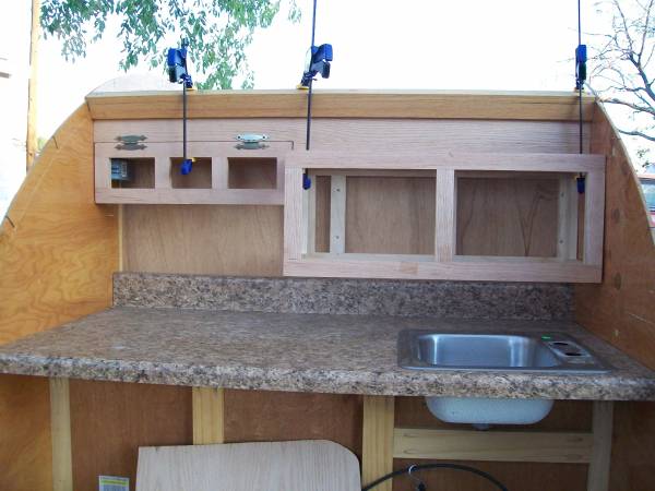

Postby down under tech » Wed Aug 25, 2010 10:27 pm

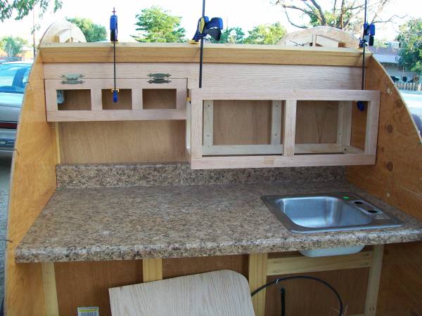

Hi out there: I was able to get the galley cabinet closer to made up today. It was a real chore to make it up so it would fit the ever dwindling space I have left in the galley. I will let the pictures speak for themselves.
Hopefully I can get the bottom shelf installed and get the cabinet installed in place tomorrow. :thinking:

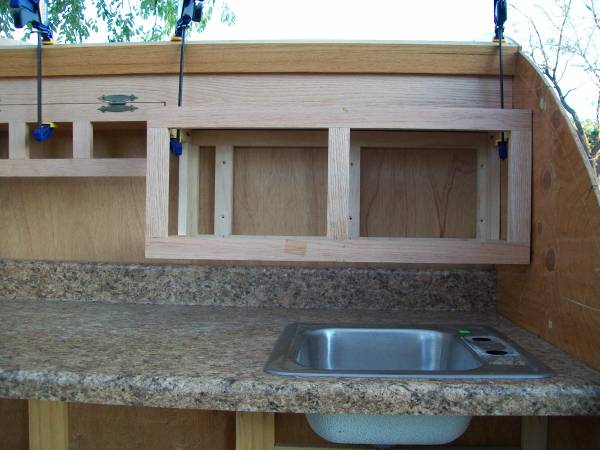

Mini Update, 8-26-2010

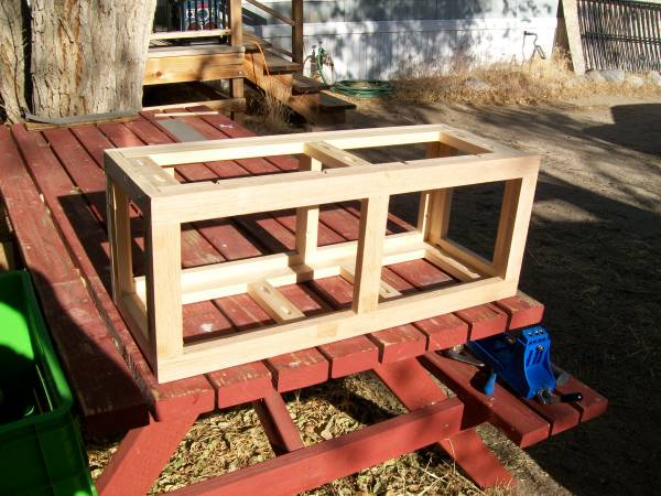

Postby down under tech » Thu Aug 26, 2010 9:52 pm

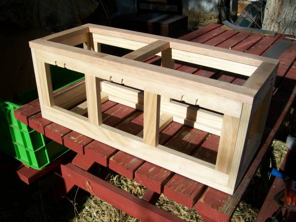

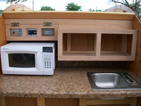

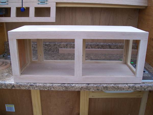

I spent a couple hours this afternoon and finished up the galley cabinet box. I still need to apply the shelf top of red oak plywood. I also need to apply the plywood to the left side that will show and the top of the cabinet that will be visible. I guess that will be done tomorrow. I left a little more than 1/4 inch overhang so the plywood end grain is covered up. This way you won't see it. I can't believe how much time it has taken to build this cabinet. Oh well, I'm glad I only have to build one for the galley.
The oak face frame is on the side facing us in the above picture.
The face frame is on the top in this lower picture. All of the other wood I used is pine. It is light weight and it will only be seen when the cabinet doors are open. I still will seal the whole thing with marine spar varnish so it holds up to what ever comes it's way.

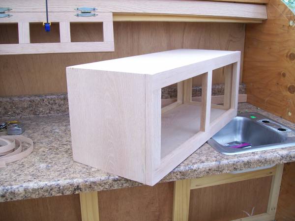

Update, 8-28-2010
Postby down under tech » Sat Aug 28, 2010 9:28 pm
OK, I spent today finishing the galley cabinet. I still need to make the doors for it, but I want to get the aluminum skins on and install the roof and so on first.

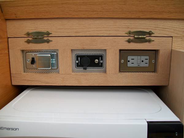

I got the electrical panel roughed in today, also. I still need to run the wiring later on.
This is the aluminum piece I got out of that old camper. You also see my 110 volt AC main shutoff switch with a screw in fuse holder. I got a 20 amp Heavy Duty GFCI outlet and this will also protect the outlet/s that will go inside the cabin.
Here is a picture of the cabinet and you can see that it is finished off in red oak plywood. I think it will look pretty good after it is varnished. What do you think???
