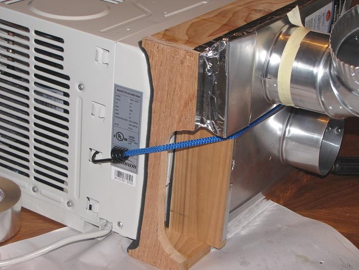

I was going to wait until I finished the project to post pictures, but in the spirit of TT&TTT, here is the a/c build thread to date.

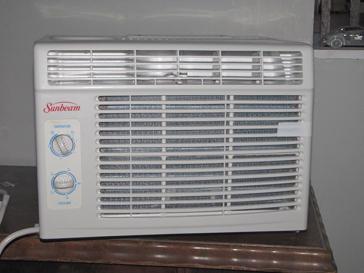

I purchased a $99.00 air conditioner.

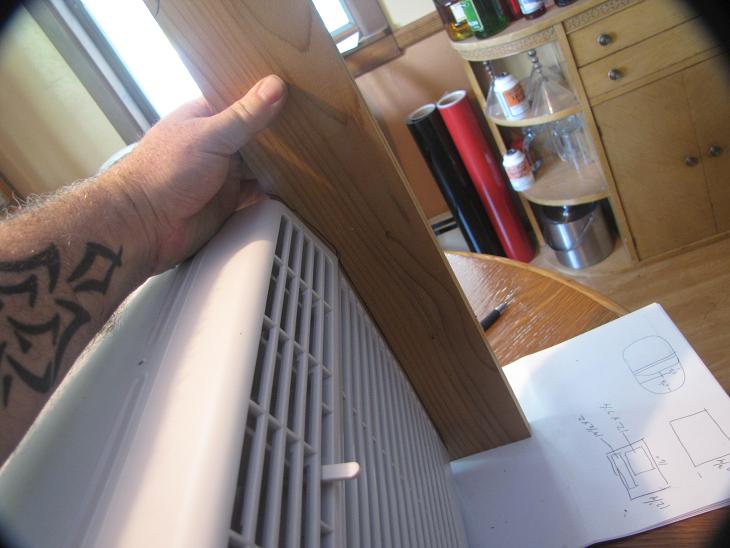

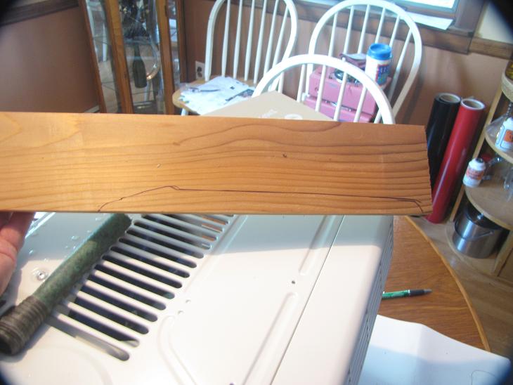

Now I need to make a form fitting front for it, to be able to vent into the trailer, so I trace a profile on some cedar I had laying around.
Now where is that jigsaw?

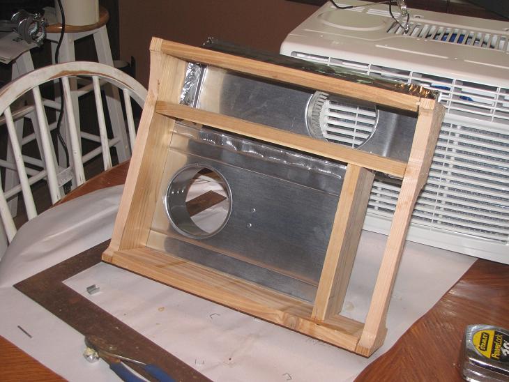

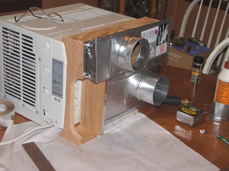

Front piece is complete, with aluminum venting installed.
From the inside, so you can see the separation of the two chambers.
Add a little foam for a better seal...
Temporarily held to the A/C unit with a bungee.
