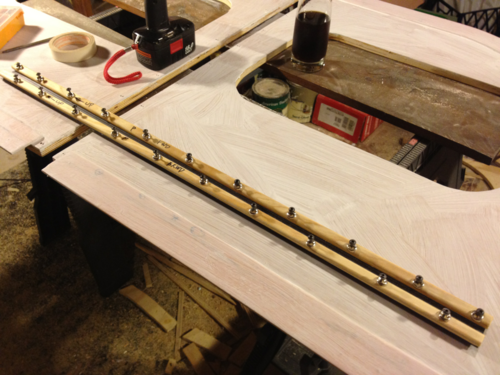

Terry...
the living hinge is working great! i used it for the galley & doors and it's had no problems at all. the only extra thing i did was use a strip of wood on each side to reinforce it just to be sure screws wouldn't rip thru.
if you didn't see it previously, like this...

I did the same thing on my galley hatch except I used two strips of aluminum and it worked out great! I see we both were smart and predrilled!

I as well,.....
86986
(ice covering included)
....and my hatch is HEAVY (50-60lbs at the handle, 150lbs where props connect)

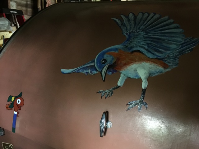

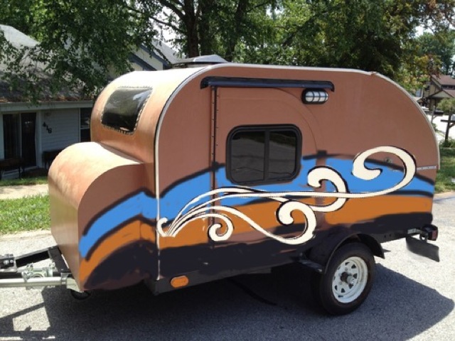

And more on topic of a build journal.. I finally painted the bluebird on the back..
We're toying with the idea of something like this for the sides..

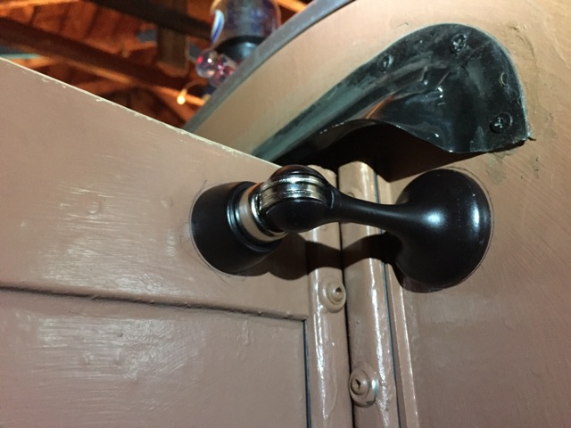

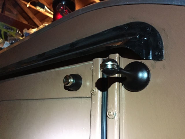

And I'm beta testing some magnetic doorstops to keep them from flopping while parked.. We're going Southwest this year so I'll let you know how they work out of the garage..
