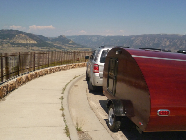

Ryan, here are a few pics of my finished product on a trip to northern NM.
Thanks for all the help and guidance. --- Bob

Postby _Ryan_ » Wed Aug 24, 2016 9:38 pm
WitsRUs wrote:Ryan, here are a few pics of my finished product on a trip to northern NM.
My pleasure Bob! I'm excited to see you are out enjoying it! I love to see these things come together so beautifully! Enjoy your hard work! :thumbsup:

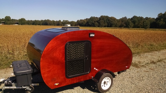

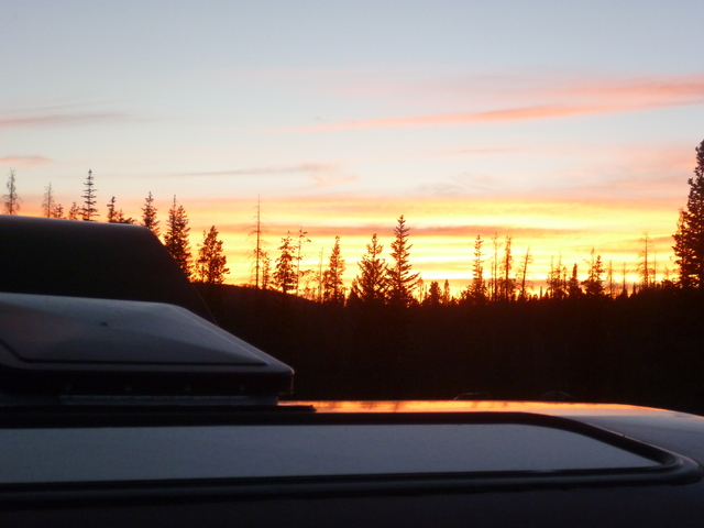

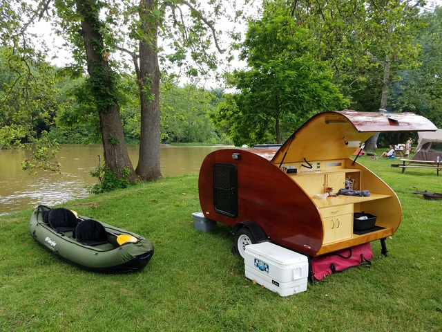

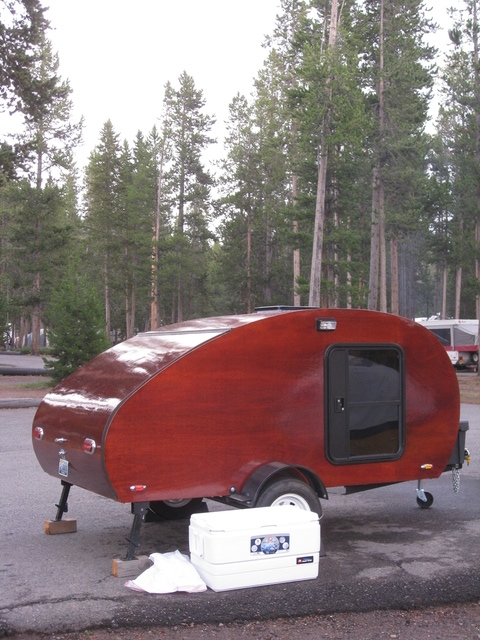

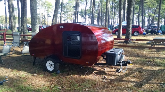

Postby _Ryan_ » Wed Aug 24, 2016 11:13 pm
So it has been 3 years and I thought it was time for an update. The Wyoming Woody has now explored over 6,000 miles and we have enjoyed some 30 odd nights with it in campsites, RV parks, and of course the wild.
For those of you who are curious about the long term durability and quality issues there have amazingly been NONE (knock on wood :D ). No leaks, loose bolts, or wiring issues besides going through 3 trailer light converter boxes! The finish still looks like new, of course I have kept it garaged between trips which makes a huge difference. Next year I plan to add some aluminum wheels and add some more coats of spar varnish to try to get out those last few imperfections. :D
On a personal note due to work we have moved to northern Virginia which has led us to do some camping on the beaches of Virginia and North Carolina which is a fun new experience after having it in the mountains. During the move we sent our stuff by truck and we took our time and camped our way across the country in the teardrop, serious fun! Wyoming Woody now in Virginia, go figure! I am looking for some gatherings out here, so if anyone has some suggestions or is near by I would love to hear your suggestions.
My plans for the Wyoming Woody on my blog have been received better than I ever expected and I have been contacted by at least a dozen builders who are building one or at least using them as a starting point for their own builds. I had such a great time designing and building it and I love to see others enjoying the same process and help out when I can. There have been a lot of good and creative modifications to by original plans that I get a kick out of following. Thanks again for all the great feedback, comments, and help over the years!
Here is are a few pictures of our adventures! Hope to see you out there!
Cheers,
Ryan

Postby 3GKnight » Thu Aug 25, 2016 12:01 pm
Nice. Thanks for the update!
For a second there, I thought that was a nekkid guy standing in the background of the 2nd to last pic. lol. On second look, it's a kid in a pink shirt standing in front of said guy.
