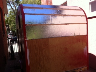

Over the weekend I finished the roof insulation, outer skin attachment, and sealed it with thompson's clear water seal.
I used 1.5 inch hard foam insulation cut to fit between the spars. I used a jigsaw to cut the insulation just for speed. Any gaps from uneven cuts were filled with spray foam insulation.

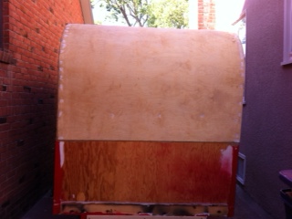

Attaching the outer skin (which is the substrate for the aluminum roof) was quite difficult. I use 3mm baltic birch, and had 3 panels that are 60x60. it was very hard to get the pieces that went over the curve at the front and rear to lay completely flat. I used PL adhesive over all wood surfaces (spars and the first few inches of the front and rear bulkhead walls) then first laid the top center piece of birch. it laid down flat and no problems. then I attached the rear and front pieces. in order to get the birch to lay flat and align as best as i could i had to screw the birch in (at about an inch in from the edge so I screwed into the framing material rather than the plywood walls). I went down the sides alternating from side to side to get things aligned as i could. This took a few hours.
I then covered each screw hole and the seem between the birch sheets with caulking. Then i sanded all and sealed with thompon's water seal. I used the router to cut out the front bulkhead window and the ceiling vent fan holes in the birch.

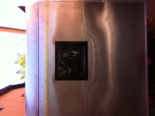

done! Over the past two weeks I was able to finish the camper. The first work was to apply the aluminum roof. I used .040 sheets one that was 60x120 for top and two 60x60 for the front and rear. I had these pieces sized so I would not have a seam in the center where the vent fan is placed. As some others suggested I used Henrys urethane based flexible adhesive along the perimeter and to join the aluminum at the seams. I toon a lot of time to plan so that I was placing the seams over a spar so that the molding over the seam could be screwed into the spar. This took a lot of measuring and remeasuring but it worked! I also have bottom edge and side trim molding. All molding was bought from vintage technologies. Putting on the aluminum and getting it to lag flat over the curves was difficult ad a two person job. I used two long ratcheting tie downs (27 foot each) to go from front to rear to help hold the aluminum down over the curve. I kept just enough slack to get the molding under it at the seams. all molding has rv putty under it. Then I put a bead of silicone caulk along the length of both sides of the molding. I worked my way from bottom front to the rear screwing in the molding. The screws also have a drop of silicone caulk to waterproof around them. Without question the hardest part of this build for me was the skinning. Getting it right just took a lot of time and small corrections, it was also a challenge to work with the large sheets of material.
Anyway it got done. After the aluminum and molding was on I cut out the whole for the vent fan on the roof and the front window. I first drilled holes large enough for the 1/4 flush trim router bit to go through. I drilled from inside to out. The router didn't work. Either It heated too much or the aluminum wore down the blade to quickly. A jigsaw with a blade for metal cutting did the job very well. This phase was pretty easy. The fan and window fit perfectly. Each has rv putty and silicone caulk as with the molding and is screwed in.

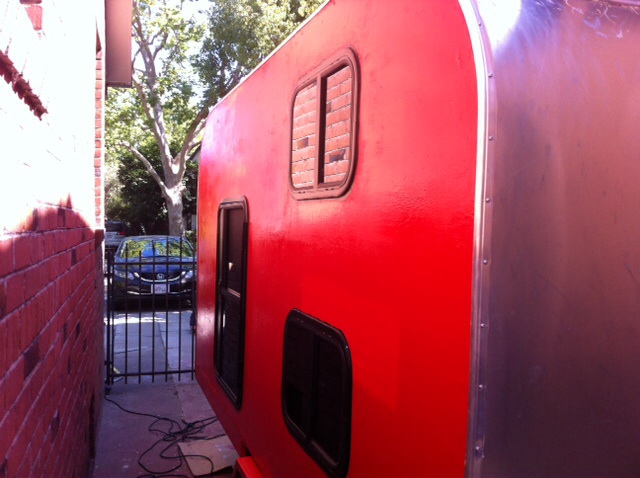

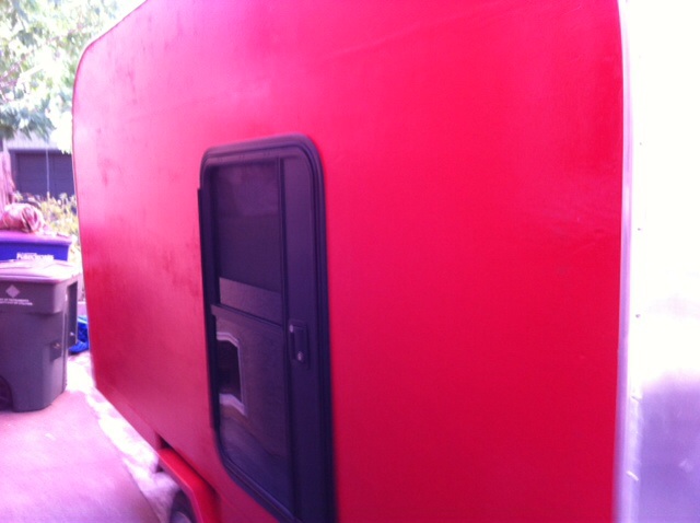

Some exterior pics.

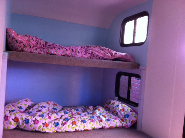

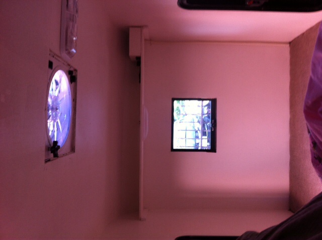

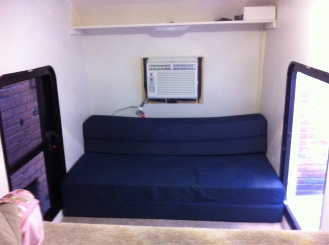

Interior pics.

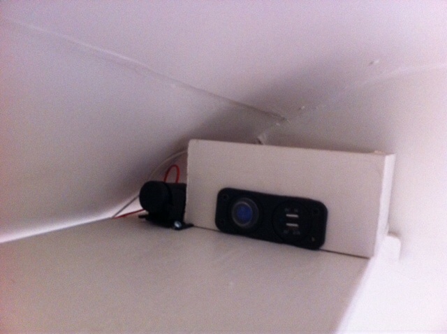

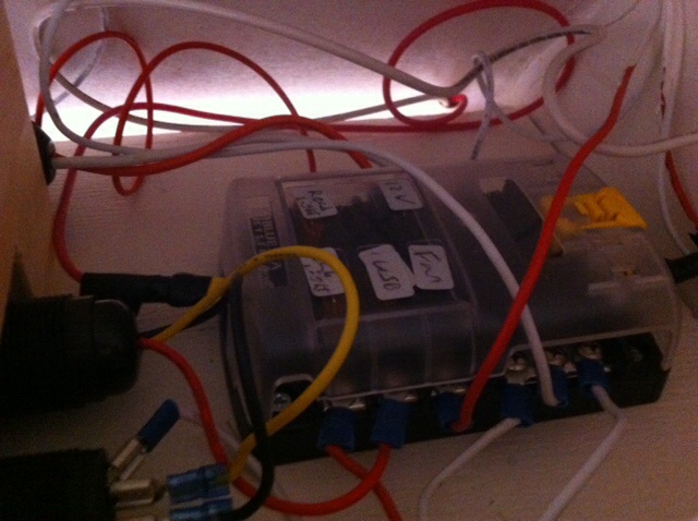

12v DC electrical. Fuse block with pos and neg bars, housing on shelf with dual USB port and rocker on/off switch, and seperate cig lighter style socket. Installed a 1x6 board in the tongue for the battery which has its own box drilled into the board. I installed the board so that it is placed inside the c-Chanel's of the tongue and held with 6 heavy duty zip ties . I'll post more detailed pics.

I would keep an eye on those zip ties. The white ones generally aren't UV resistant (the black ones are) so they can degrade or be cut by the drilled holes over time; I'd rather see bolts securing the battery tray.

KC, yes thanks for the advice. I bought a couple of U-bolts with squared shoulders and will install that to secure the wood plank into the tongue.
I'll add pics when done.

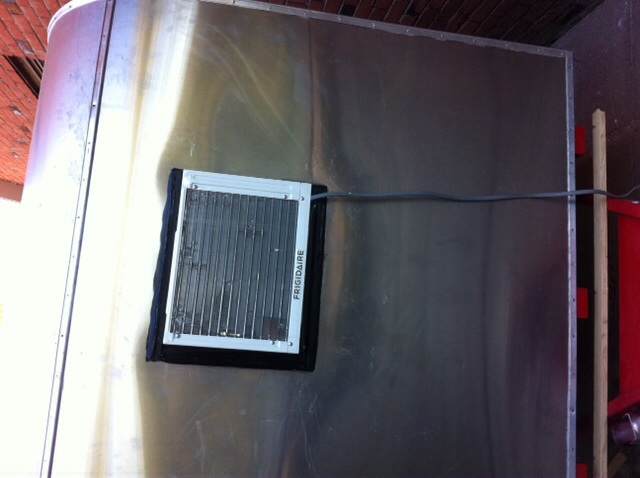

Postby mariannf » Mon Jul 18, 2016 9:36 pm

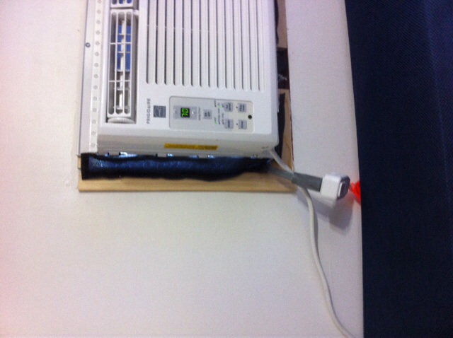

I put in the air conditioner for our first night sleeping in the camper. See my previous posts about the window and ac I bought. I installed molding around the window frame cut out and to add support for the ac. I cut 1x4 down to about 1and 7/8ths for the bottom lip of the window frame. The width of the window allowed for the ac unit and just enough space for an extension cord to run through. It would look better if I did the super simple electrical or even cut out mouse hole extension cord port, but this is as easy as it gets. I sealed off the sides of the ac unit with foam. Also I put in the folding foam sofa bed. It is queen size and fits at 58wide with just a little compression here is the one I bought http://milliardbedding.com/product/mill ... en-78x58x4½-removable-cover/

Postby mariannf » Mon Jul 18, 2016 9:41 pm
Ac installed
