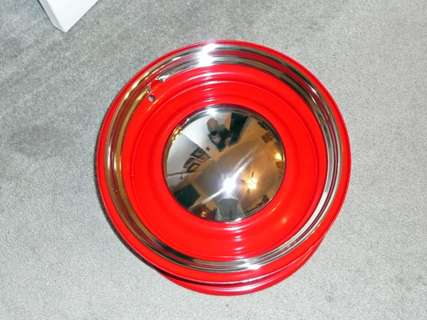

aggie79 wrote::D No work done, but look what the UPS guy brought today:
Wow, that would look good on my tear! :yes: :thumbsup:
Gig'em, Tom :thumbsup:
Man, that is NICE! :applause: You should have gotten 2 of them!

Postby WayneFromMo » Fri Feb 26, 2010 4:49 pm
WOW!!! :o I want a set of those on my truck, those are sweet. :o Can I get'em in blue? ;)

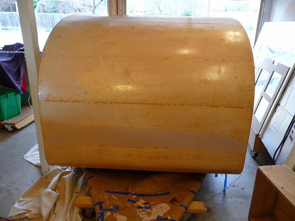

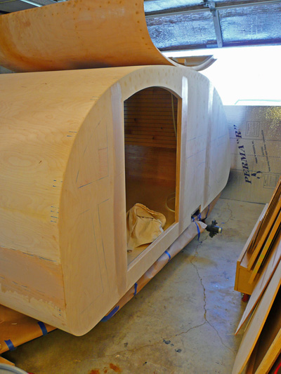

Well, I broke my string of consecutive weekends working on the teardrop last weekend, but got back after it this week.
There was a little bit of mismatch where some of my exterior plywood panels met - about 1/32" to 1/16" in some places. I'm sure the aluminum would have spanned the differences, but it was bugging me. So, I mixed up some epoxy fairing compound and applied it to all of the plywood seams. After curing and sanding the fairing compound, I felt better.
My teardrop was now ready to get a coat of epoxy to seal the plywood. I probably would not have used epoxy, but had some left over after doing my floor. Here is a picture of my teardrop after epoxying.

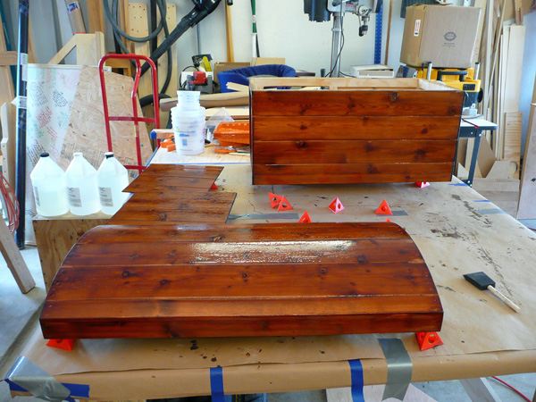

And while I had the epoxy out, I decided to put the first coat on the cedar tongue box I built to house the Petcool.
