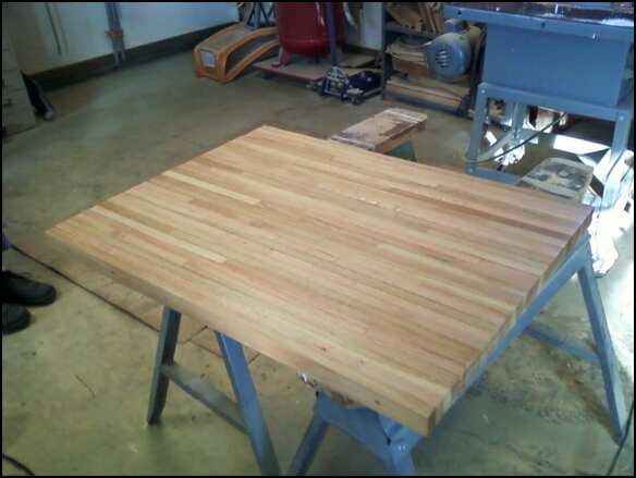

Well, a new year is here, and I finally made some:
Actually, most of that is from making a butcher block countertop for Mom:

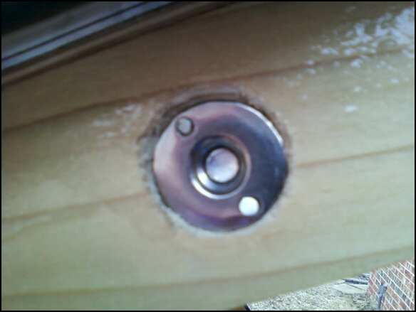

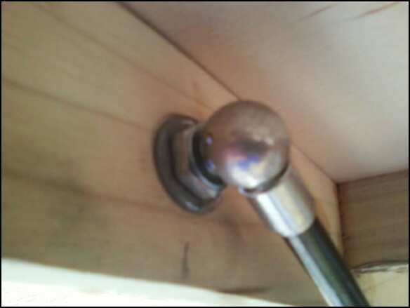

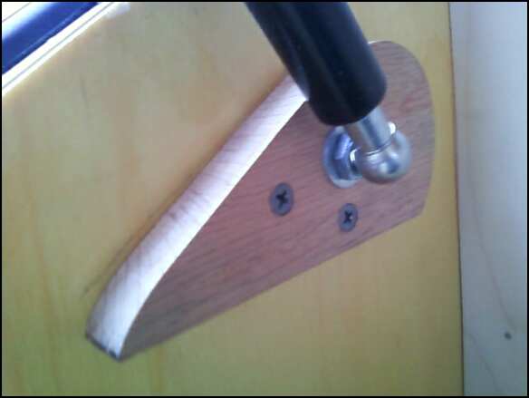

However, I did get some work done on the Kampster. I fixed (hopefully permanently) the hatch attachment points. Here's a view from the back and front sides. Sorry for the blurry pictures, I took them from my cell phone.

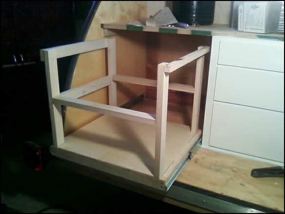

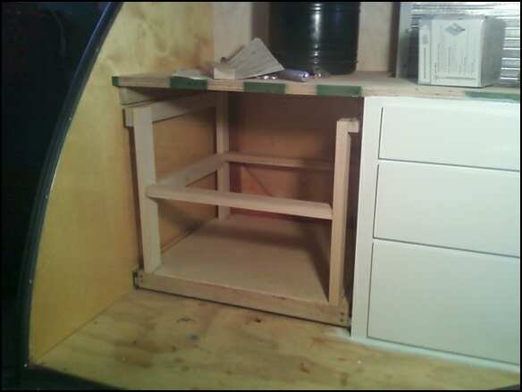

I also got some of the cabinet framing done and a drawer made. There will be a face frame on the cabinet that is not in this picture.
The right side cabinet (again, without face frame):
Next week I hope to get the face frame on, rest of the drawers built, and started on the sliding/folding/extending cabinet on the left side.

I too, found out that wood was not good enough to hold my gas shocks, so I reinforced the connection point with a pair of .125" steel hangers sed in construction. Works great now!

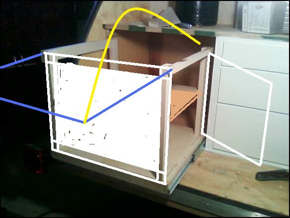

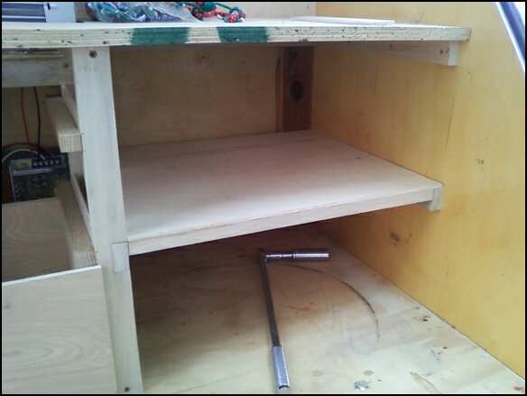

Some progress from today: all fixed cabinets and drawers installed and painted. I also framed up the sliding and extending cabinet. Here's a sneak peek:
There will be a paneled face on this cabinet so it looks similar to the paneled door on the other side of the galley.
Then it will slide out like:
Then, you can fold out the countertop and access the cabinet shelves via the side door. This fold out counter will give a total of a little more than 30" of extra counterspace.

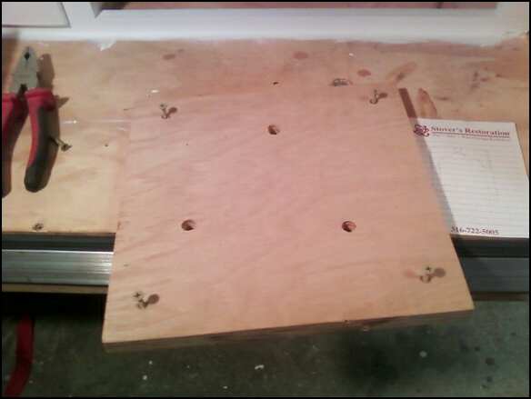

I also made up a "Dutch Oven Holder" I just took a scrap piece of ply and marked the legs of the dutch oven on it and drilled them out. After screwing this to the bottom of the right cabinet, I'll have a place for the dutch oven to sit and keep it from bouncing all over the place while going down the road.
Next up is getting all the doors made. I already have two for the inside cabinets cut and ready to put together. They'll be a rail and stile frame with a beaded board panel.
