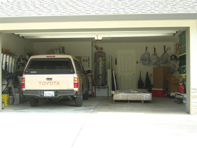

Mike: It's a 5x8' Red Trailer model that they aren't selling anymore. Well, the trailer is black but the company name is 'Red Trailer'. :lol: It just seemed to be a bit sturdier than the Harbor Freight. (A little more weight and a little more cost, too.) You probably know that Red Trailer sells from the CT, PA, OH, and CA states.
PS. I wonder if my garage will ever look that clean again. :o It is so-o-o covered with wood, parts, and sawdust now! :roll:

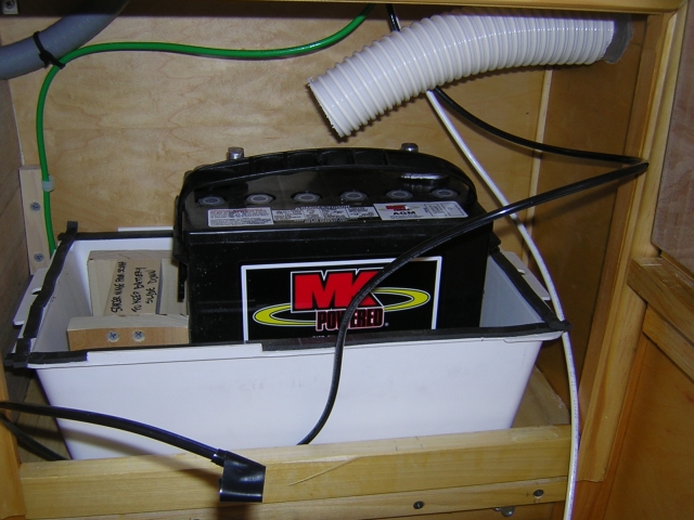

Sharon, forgive me for not checking in sooner! I am very impressed with how well-thought-out your wiring is... and too with how well conceived the whole trailer is!
Did you buy an AGM battery yet? If so, what brand and size?

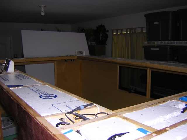

Postby S. Heisley » Sat Jun 26, 2010 7:23 pm
mikeschn wrote:
Good job on your build so far... did you try laying down on that bed? do you fit?
Yes, Mike, I tried the bench beds. The 4" high density foam is very comfortable. Also, I planned in versatility. The benches will make into two cots or a twin, full, or nearly queen-wide bed. The length of the beds is 6'1".
When I planned the cots, I researched the width of sleeping bags and sleeping pads. I measured the two sleeping pads that I was currently using and the 22â€

Postby S. Heisley » Sat Jun 26, 2010 7:51 pm
Hi, Chris.
Thanks for your kind words. I purchased an AGM 55Amp MK battery. I went with the smaller size to keep the weight down. This one only weighs 38 lbs. Before I purchased it, I called a local wheelchair facility and asked them what they used. Even though they didn’t stock the one I needed, they raved about the MK batteries, telling me that those were the only brand that they stocked and that they last the longest and have the longest shelf life. They said that one of their customers actually had an MK last for 10 years.
Earlier in this thread, I listed my requirements with a planned usage of less than 7 Amps per day. Based on that, 42 Amps would be needed for a weekend trip. However, that was probably more than I’ll actually use. Except for evening book reading, I tend to be skimpy with light usage. Therefore, I think I’ll be able to get the equivalent of 4 days from this battery without running it too low or having to recharge it. (Maybe next year, I can add a little solar panel!)
