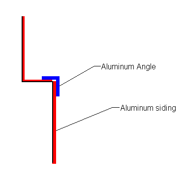

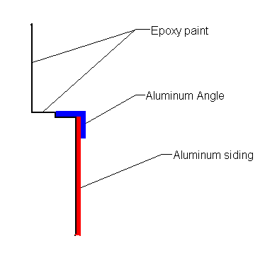

What I suggested to Gary was that the shelf be painted with epoxy paint. Then put aluminum on the side, and put your aluminum angle over that... I would rabbit the edge for the angle...
Here's a quick sketch thru the shelf area...

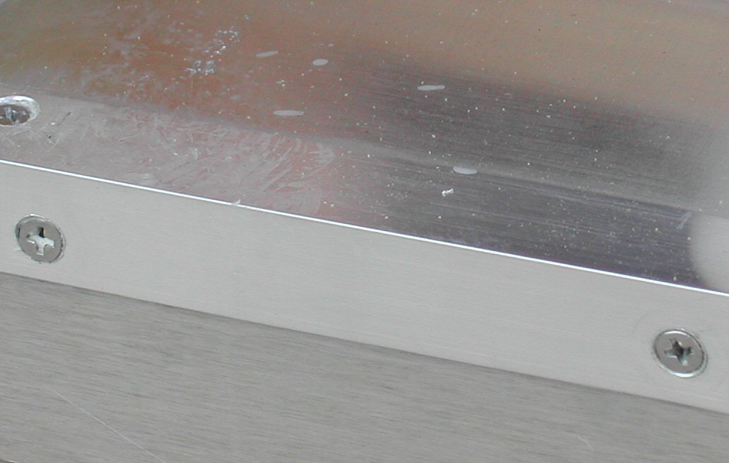

Postby mikeschn » Sat Sep 26, 2009 8:19 am
You could also break the top piece where it meets the shelf, and then cover that joint with the angle. You'd want to use real thin angle though...
P.S. It would look similar to this I would think!
