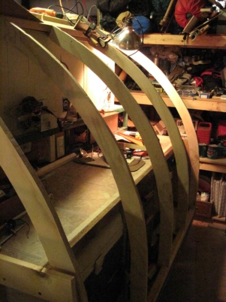

The galley hatch ribs are now installed along with most of the blocking. Here are the 5 ribs prior to the blocking install:
The hatch build seems to be going good so far. Not as difficult as I had anticipated. I like using a template and then router cutting with a pattern bit. That works better for me than free-handing with a jigsaw. I then shimmed the two end ribs in place (using lots of clamps) with appropriate clearances for weather stripping, hinge and sidewall clearance. Added oak top and bottom framing and then blocking.

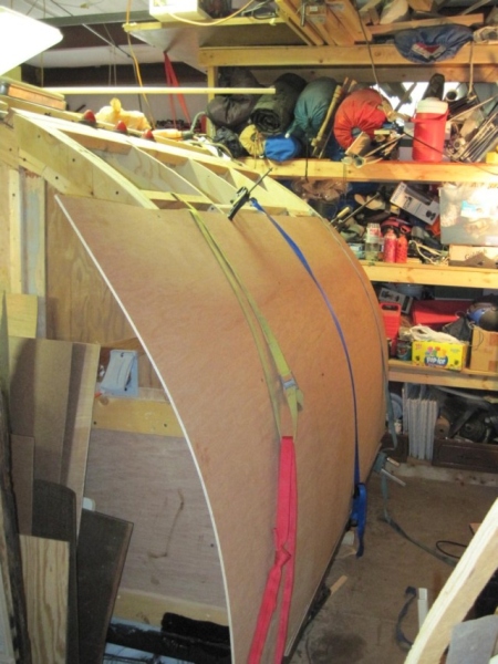

With the endwall and hatch framing completed, it was time to raise the hatch in order to resume work on the galley and endwall interiors. Worried that I might rack the frame, I applied a luan skin to stabilize it. Another set of hands would've helped.
My plan called for beginning attachment of the skin at the hinge end but after wrestling with that, I opted to start at the bottom. I didn't have any suitable clamping areas at the top and was working solo. That will mean I will have to add seam blocking later, but that's ok.
Acres of sun and rain protection! A proud moment.
I am happy with my mini-rib "sandwich", the recess area will provide lots of room for weatherstripping and the overhang will be added rain protection insurance.
Hatch supports next, a prop failure would be ugly. :lol:

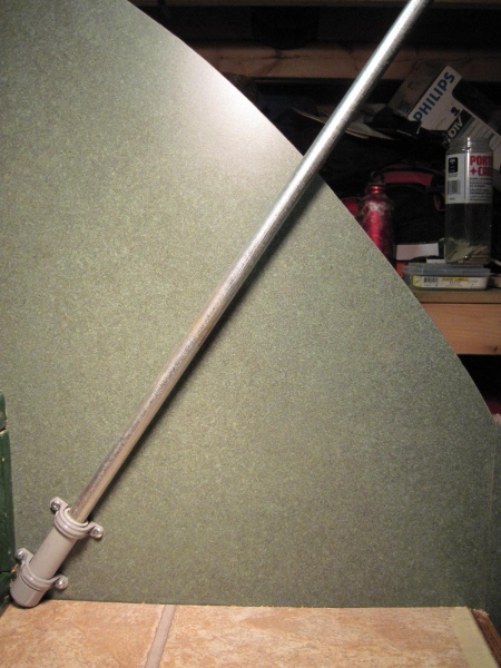

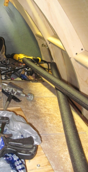

The hatch props are now installed and work pretty well. I might tweak them a bit later. The design features I desired were:
1. Plenty strong to support the large hatch.
2. Raising/lowering would need to be a one-person job.
3. Pinned at each end to avoid wind lifting.
4. Raised hatch height would allow suficient head clearance.
Many of the designs used for teardrop builds were unsuitable due to the monstrous size of my hatch and the solo positioning requirement. I decided on using a gravity-drop method, securing the props to the hatch, so they would fall into near position when the hatch was raised.
They are plenty strong.  The only hassle is when stepping underneath the hatch to seat the props in the base "cups".  As I walk further underneath the hatch, the "ceiling" becomes higher due to the hatch curvature.  I'm at about the max. of my reach when manipulating the props into position.  That will be the tweaking part, moving the base cups closer to the countertop edge so they are within closer reach while I'm still holding the (lower) bottom hatch edge.

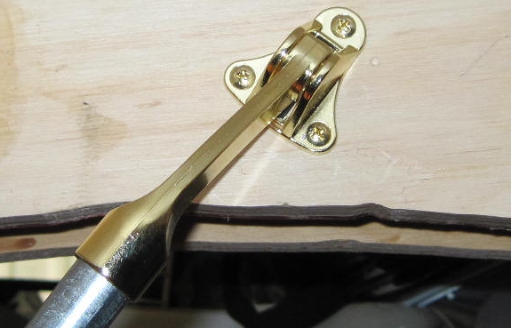

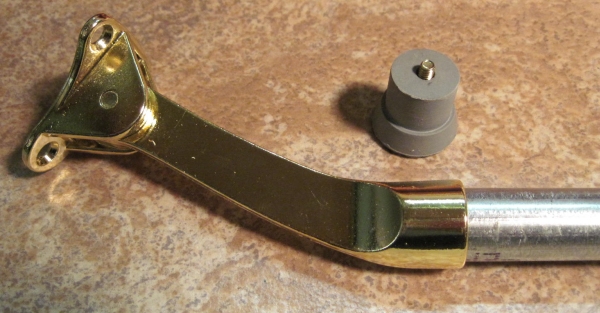

I used kick-down door stops and after removing the rubber foot the 1/2" EMT conduit fit perfectly inside the rubber foot cup.  That was a nice surpise, I had expected to cut/grind the stops in order to insert the conduit. I drilled and bolted the conduit to them (no pic):
Base cups were fashioned using 3/4" grey electrical conduit (perfect fit for the 1/2" EMT conduit, large enough and not any slop) and secured with machine screws/nuts/straps to the endwalls.  A cap was used on the end.  The curbside "cup" is 4" deep and the streetside "cup" is 3" deep.  When raising the hatch I insert the curbside prop first, then with it captured I insert the streetside prop:

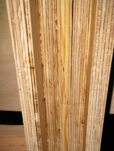

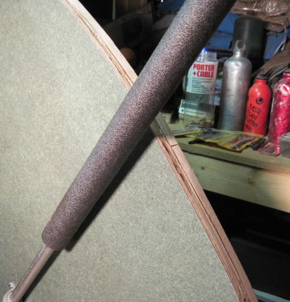

The door stop was screwed to the hatch rib.  (Don't know WHO cut that crooked rib,,, yikes! Might add a hatch liner after all.) :lol:
Foam pipe insulation was added to the conduit:
When lowering the hatch, I raise it up and the props come out of the cups.  Then, I swing one toward the countertop, then the other.  As the hatch closes, they slide across the countertop.  I might add a couple of spring clips to the underside of the hatch so I can clip them in place, haven't decided.  The folded, travel position was checked for clearance.  Ok.
