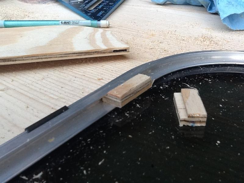

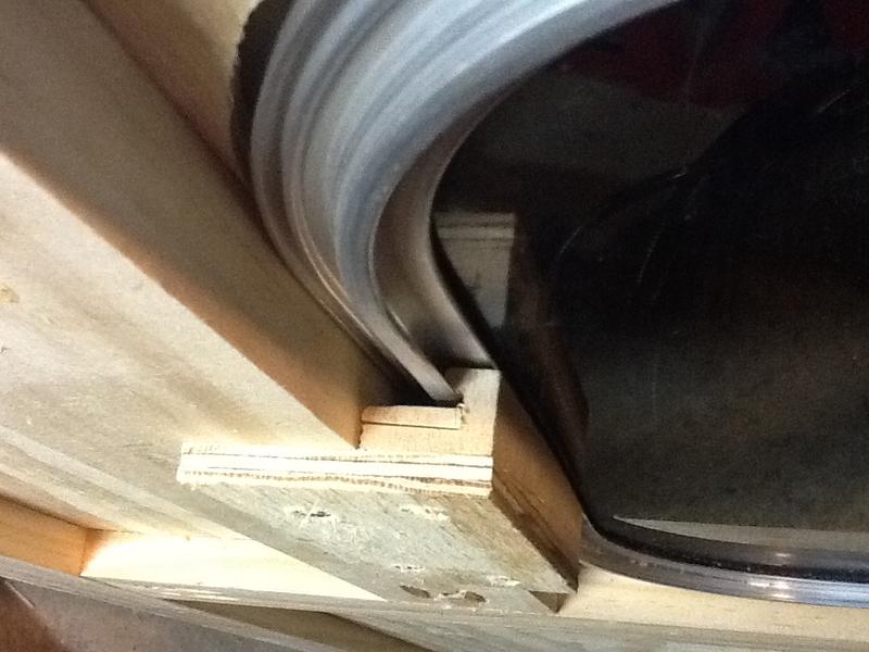

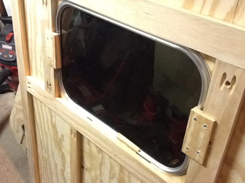

Here are my prototype clamp rings, version 1.0.
The outer plywood square is the same thickness (1/4 inch) as the inner door/ wall skin, so imagine that it is continuous over the whole surface.
The J-shaped wooden clamp rings hook over a lip on the inside of the aluminum window, and can be sandwiched in between the wall skin and the window, and secured in place with screws. The tightness, or how much it draws the window in, can be adjusted by changing the thickness of the wooden clamp ring, and the screws pull it (and the window) inward.
These two little prototype pieces actually hold the window in place all by themselves, at least here in the workshop. For the final version that will experience the rigors of the road, I will make a longer strip of wood that fits each straight window edge, so it's clamping every surface except the rounded corners. I guess I would make 4 cosmetic wooden corner pieces to hide the aluminum window corners, so it would look consistent from the inside.

Postby noseoil » Sat Sep 12, 2015 10:29 pm
Looks like you've figured it out & the trim parts should work very well to hold the window firmly. Watch the tension on the wood edge, as it could break across the grain if it's pulled in too tightly, but the locking action seems to be what you need to hold things in place. The wood trim could serve as an accent piece & hold the curtain rods in place as well. A contrasting stain perhaps, just slightly darker than the walls?
What type of bedding compound will you be using for the seal of the window edge to the skin? A butyl rubber tape or sikaflex type of caulk would do the job, grip well & set up firmly. Once the seal is made, the window should be there to stay & the wood trim is just holding against the wall. Really shaping up nicely now.
Good feeling to solve the small stuff in a positive manner, isn't it? Well done! :thumbsup:

Postby lfhoward » Sat Sep 12, 2015 11:39 pm
Thanks, Noseoil! It is good to be able to figure out some of these details like how to install doors and windows, since they have been on my mind. Nothing like a good rainy day in the shop for creative solutions.
Now that I am looking at my post, I'm actually thinking about improvements. I could potentially have a trim ring that goes all the way around (not just the straight edges) if I make it out of several layers of plywood instead of boards. It might look nicer, being continuous. Do you think TB II would hold the plywood layers together well enough (and the window in) over the long haul?
To answer your question, I have been considering the butyl tape to seal the windows and fantastic fan. (And the roof edge moldings too?) I've heard good things about Sikaflex (probably from you, ha ha!) so that sounds like a good option too. I will need a flexible sealer for the seams where the aluminum sheets overlap (4' wide sheets, 5' tall cabin) as well as at the bottom of the body where the aluminum ends as it meets the steel trailer deck. Would Sikaflex do the trick there? Or is PL Premium a good enough sealer for what I need to do?
For windows and roof edge moldings I have also been given the advice to use RV putty instead of butyl tape because it is more easily removed and repaired down the road (without destroying the edge moldings). What are your thoughts about that particular idea? It seems like butyl tape is a more commonly used method.
Have a great evening, and THANKS!

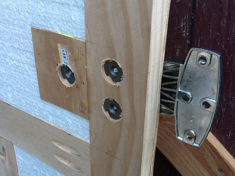

For the door hinges, since they will take more loading over time & are somewhat picky about gaps & sealing, I would think about using "T" nuts installed from the back side (inside the wall) if at all possible. If the inner skin isn't installed yet on that wall, take a look at potting inserts in 5 min. epoxy as a permanent fastener solution. That way you will have machine screws threaded into a metal "nut" bedded in the wall. I use a 3/4" speed-bore bit (paddle bit) to set them flush in the backing block (3/4" thick plywood or frame in my case) so the skin doesn't bulge where they're located. If you wait to install the inner skin on that wall, you can just drill through the aluminum from the inside with a smaller bit than the diameter of the screw itself. Then use the correct size bit to drill from the outside for the aluminum. Watch out for screw length!
If the inner skin is already in place & you need to pick up the fastener holes, a cardboard or 1/8" plywood template with the holes in place can be made with a center-line marked on the jamb & template. A block nailed & glued to the back side will index the depth or offset from the edge, then the holes can be located & transferred to the aluminum from the outside.
I buy the "T" nuts & screws from a fastener store here in town, as a store hardware sells them at absurdly high prices. In general, they're much cheaper in bulk or by the "each" at a supply house.
The jam can either have a rabbet joint to act as a seal or have an inner panel applied form the back side to provide a lip. In either case, before you do this joint spend a little time figuring out what type of seal or gasket you will use to make the joint water tight. There needs to be sufficient clearance built into the design to accommodate this gasket before you do all of the work on the door. Doors are picky things...

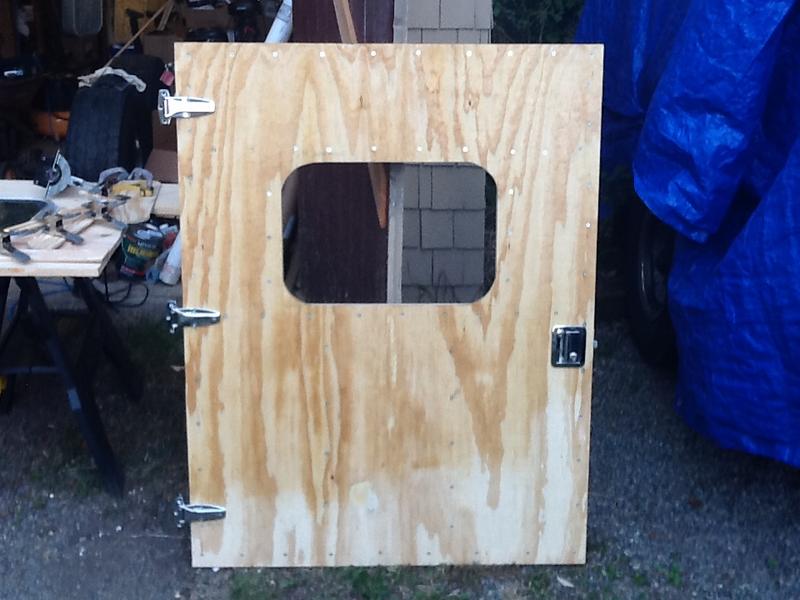

- Routed out the space in the back door for the RV latch. Since I practiced on a fake "door" earlier, the process went really smoothly and the RV handle fits really well.
- Routed out the latch holes in the utility doors and installed the door latches. These are the same latches you see on aluminum truck boxes.
- Installed hinges on all three doors using tee-nuts and machine screws. The tee-nuts will be hidden inside the doors, under the interior skin.
- Attached the utility doors to the trailer. The utility doors don't have back-stops yet so they swing too far in, but they look good in place!
- Wedged the back door in place using 1/4 inch shims. I need to beef up the thickness of the door jambs with an extra 1x3 on the inside before drilling for the hinges, but the door looks darn good sitting there where it is supposed to go!
None of the door hardware is permanently on at this point. It all has to come off for aluminum skinning, but it is nice to know it fits! And I can drill perfectly placed holes in the aluminum from the inside-out through the tee-nuts. Thanks for that idea, Noseoil!

Postby lfhoward » Wed Sep 23, 2015 5:39 pm
Some progress this afternoon!
We have a back door with a latch and hinges!
The hinges are held on with tee-nuts, recessed slightly into the wood. The interior skin will cover these up. Thanks, Noseoil!

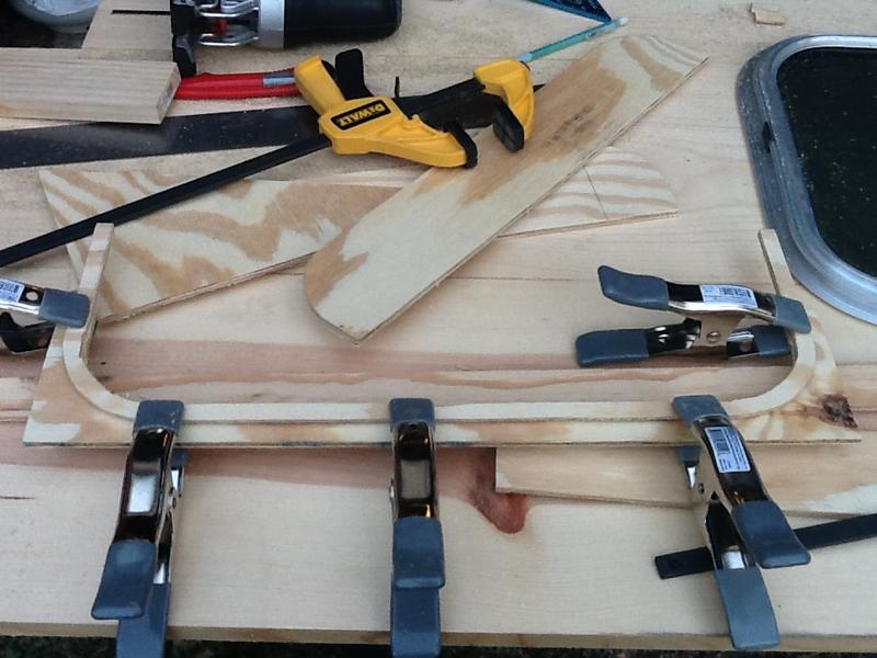

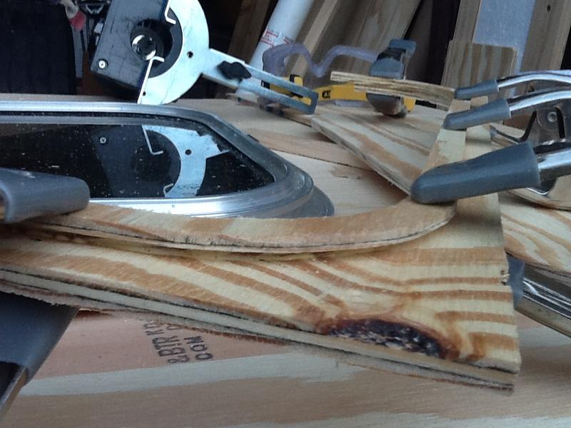

Clamp ring update!
I'm making them out of plywood using the same principle in my prototype, but this will look much better. I think it will hold the window much better too, as there is more surface area holding the window on, and no grain in the wrong direction that can snap off.

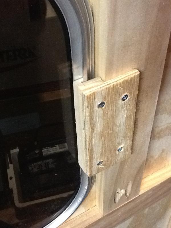

Here's a close up of the wood pieces that will hold the window by its interior lip.

The trim ring test-fits well. It will be permanently installed after skinning the door with aluminum and backing it with 1/4 inch thick material that matches the interior of the trailer. (We haven't picked out what we want on the inside walls yet.)
There are two trim rings left to build, for the front two windows. Those window frames are different (deeper) than the frame on the back door, so I will need to modify my trim ring design slightly. I will keep you updated!
