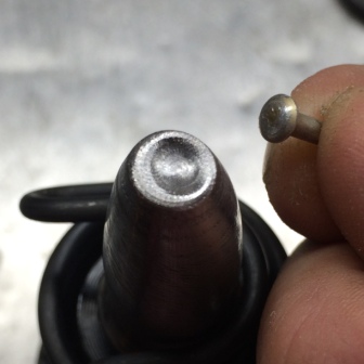

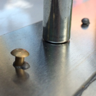

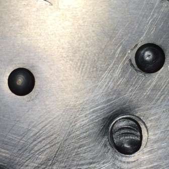

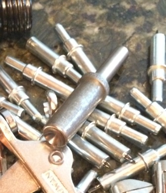

still a very slow grind on project Y. work, weather, and lack of hands ---but still fiddle-faddling with rivets. i had to modify the rivet hammer because the rivet tops were so small the hammer would have done nothing but dent the aluminum. i stuck the bit on the lathe and took a grinder to it as it spun--then touched up the dish with a dremel. i found that the slightest imperfection transfers right onto the rivet-cap. also----air pressure is very important. it's easy to tell which rivet i drove with the highest pressure (about 100 psi). the nicest looking one was set with about 70 psi, and after i practiced a few times. they are so small that the slightest error in angle of approach or a heavy trigger finger results in ugliness.
here's the rivet hammer
rivet tool orig.JPG (50.68 KiB) Viewed 2440 times
here it is after some fixin
rivet tool mod.JPG (31.65 KiB) Viewed 2440 times
guess which is my first attempt ?
rivet test.JPG (62.17 KiB) Viewed 2440 times

For me it would be the left one. Then I'd get cocky and do the lower right ;)

Greg M wrote:For me it would be the left one. Then I'd get cocky and do the lower right ;)
Ditto

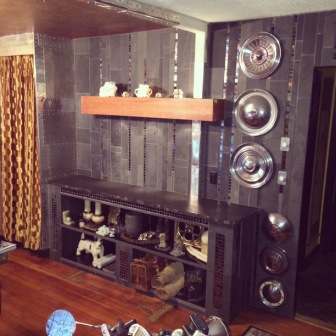

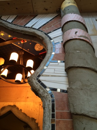

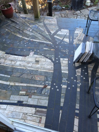

yup a tiler---45 years old and still grovelling for money !! been tiling for almost 25 years now. i do have a router, but have never really used it. i prefer grinders and drills. not sure why i never got into the router but it's there when i'm ready......on the tile front, and i'll try not to muddy up the build thread again---here's where i'm at with it these days around the house--
the 'goth mahal'.....step out the bedroom door and i'm under that light.
tile 1.JPG (53.22 KiB) Viewed 2271 times
the back deck.

the 'barffice" it's an office--it's a bar
tile 3.JPG (44.61 KiB) Viewed 2271 times

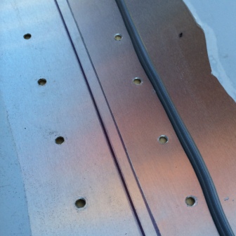

that's GE silicone 2. good stuff i think. not much more to say---3/32 holes--deburred. 7/8 spacing. about the same from the edge
laid a bead.JPG (42.01 KiB) Viewed 2387 times

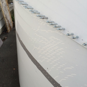

very light anodizing comes off and is a good indicator of set-ness. great silicone placement--it spread well in all directions although less cleanup along the edge is preferable

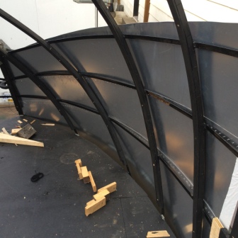

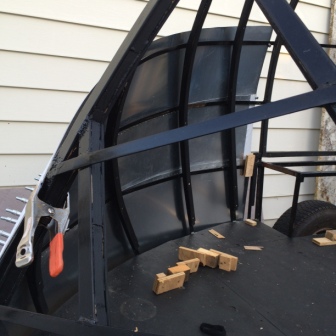

about three quarters of the way down, the skin will be curling under the chassis. not apparent here are the five or six places i screwed the skin to the frame---either end in the cut-off zones and the top edge---where the hole will be covered if it is not removed. also happens to be where the skin and frame touch. i will remove these screws when the skin can drape over the spine, and re-consider the anchor points
row 3.JPG (33.5 KiB) Viewed 2387 times

lots of anchors for the spray on insulation to grab
skin inside.JPG (45.68 KiB) Viewed 2386 times

The tile work looks great. I like the snow flakes (small white squares) on the winter deck scene, and the decorative treatment with the hubcaps. :thumbsup: :thumbsup:
