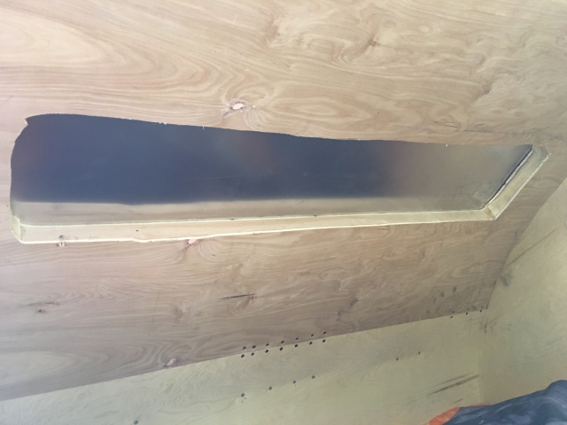

So this is what the inside of the camper looks like where the stargazer window would have went.
Now I'm thinking about a custom peice that would be a CNC'd cut name plate with the name of the camper ingraved into it. I think that would look really cool. I think I'll use a 1/2" piece of Purple Heart to match the rest of the camper.
