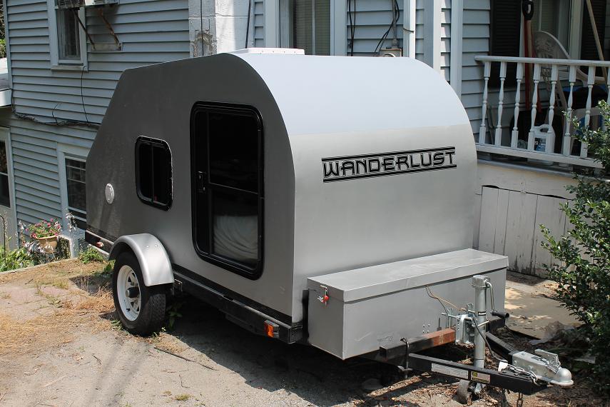

I'm getting my trailer in top shape for the trip out to Wyoming next month. My first step was to update me entry door. The RV hatch door worked flawlessly, and kept out water, bugs, and other miscellaneous varmints, but after my trip to Maryland, I became very jealous of Zach's doors, so I bit the bullet, and laid out the cash for one. It is the same width as my hatch, but gives me four more inches of clearance for my head when getting in and out.

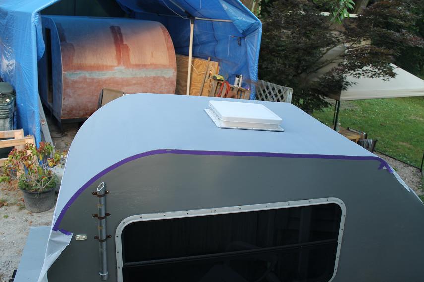

While getting the mattress out of the way of the jig saw, I noticed a slight discoloration of some of the luan, right at the very front edge. After installing the door, I jacked the nose of the trailer up as high as I could get it, and added additional undercoating to the front edge. There was a section that I could see the wood, so I must have missed it during my initial build. I also examined the rest of the trailer, and noticed where some of the screws were in the roof, the resin was showing hairline cracks. No Good!
I got some Upol Gravitex which is a flexible chip guard, and coated the top of the roof (6 coats with a foam roller) after sanding it all down for a good bite.
I got up at 6:30 to finish the roof, and by 8:00am the heat got to me, so I came inside to do a little something in the A/C. The result, was a new decal for the front of the trailer, matching the name on the back, but bigger. I'm trying to justify the money I spent on the 32" vinyl cutter. :D

Looks real good Paul. I bet the new door makes the interior feel different with all that glass. New graphics are great too. :thumbsup:

I'm curious as to what the square tube u-bolted to your tongue in front of the tongue box is for.
Re: Wanderlust Build Thread - Updates after two years!
Postby parnold » Sat Jul 07, 2012 5:07 pm
If I had your welding skills, it would be cut and welded instead of willy nilly bolted on with huge U-bolts. :lol:
It is for the tongue jack. If you mount the tongue jack on one of the two rails that lead to the tongue, the harbor freight steel has a tendency to twist. Mounted to the cross bar, there is no twisting. One of these days, I'll take it back off, blast it, and get it welded, and then paint to match everything. It was put on in a hurry a last year, and was something I never got around to fixing properly.

parnold wrote:It is for the tongue jack.
Ah, I see it now. I was looking at the end of the tube and thinking it was a bit heavy for storing tent poles and fishing rods! I understand that not everyone has welding capabilities. It is somewhat of a specialized craft.
You know, Paul, Jersey isn't that far away from SE CT. If you wanted to make a weekend camp trip up this way, or even a day trip, I'd be happy to help you with a more elegant jack mounting solution, do whatever welding you need done for it. Take another look at the way I did mine, see if you like that, or fire away with what you would like to do if you could weld. We can make pretty much anything happen.
