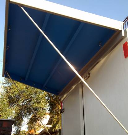

I finished building the roof for the toilet unit. It is tall enough to stand under the ceilling without hitting it with head, but still just a bit higher than a trailer. When removed, it fits inside cabin supported against the wall, allowing us to sit inside comfortably in a day version of interior. Outside I installed a small LED lamp for night toilet use.

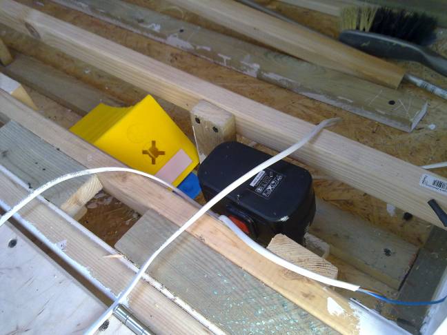

I installed a source of electric power. Instead of buying a car or boat battery, I used a broken power drill. Cut its handle with a battery lock, fitted to the trailer floor under the seat and let cables go out. Battery gives 12V and light works perfect.

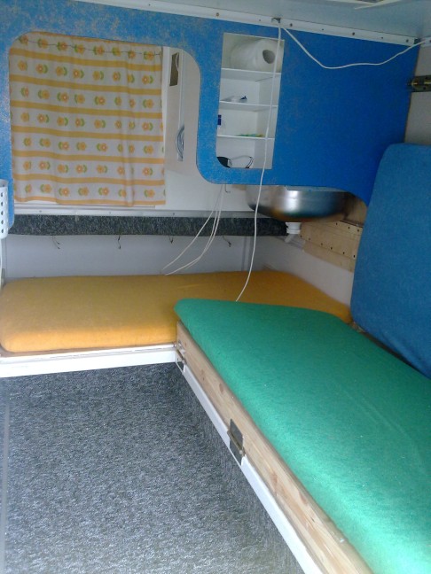

About my own feelings: it is a superb trailer. We can sleep in it with so much comfort. We can prepare food just after we park. After installing a rear roof and a tent wall we have a small toilet unit. During the travel the roof fits perfectly in a trailer and is locked at the right side wall. It is also serving as a comfortable back support (can be seen on a picture called 'Day version').

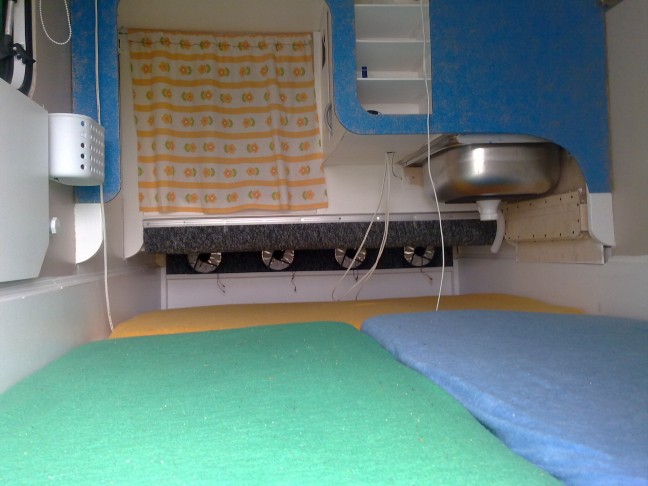

Hello again. Just a small update of my caravan build. I finished the floor and lower part of walls with a carpet, also improved ventilation- removed grilles from vents, installed a mesh to protect us from mosquitoes and then installed 4 super silent computer fans that blow a lot of air into the cabin. There are also small LED lamps on each side of a night version of the bed and a car lighter sockets/ USB charger.
