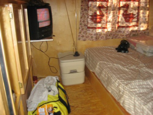

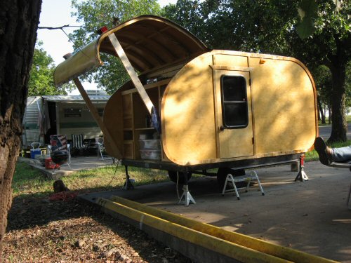

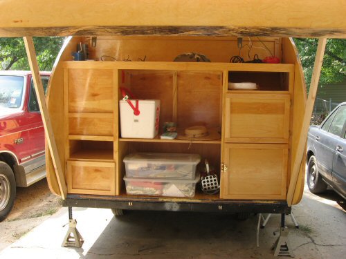

I guess I better post the finish photo's here too.
The galley
The inside
The rest are in the album and photobucket.
It has been a trip and I thank the whole forum but especially the people on this thread who encouraged me along the way.
