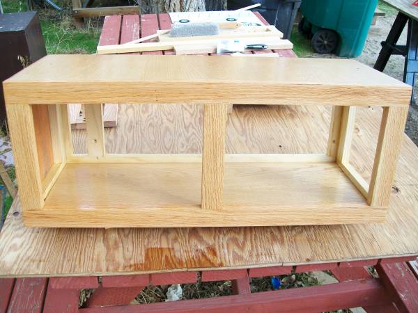

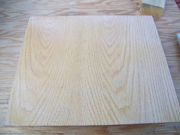

I took some pictures of the varnished cabinet and face frames.

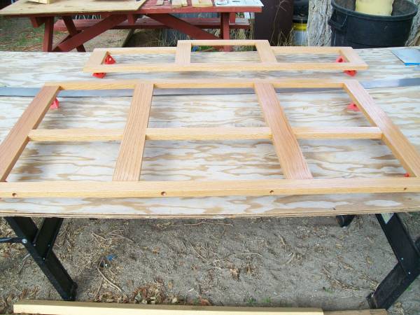

This is the galley cabinet. It has a red oak face frame and it has 1/4" oak ply covering the rest of it where it will be seen.
I used "Painter's Pyramids" to coat both sides of the red oak frames so I could get them finished up last light. I coated the back sides and flipped them over on top of the stands. Then I varnished the other side that will be visible. It saves a lot of time.
This is the insert for the front overhead cabinet RV stereo. It goes in the top frame in the above picture. I still need to lay out the stereo opening for that and cut it out.

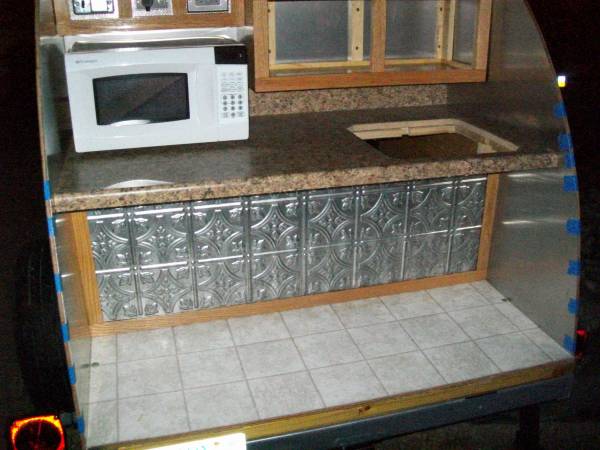

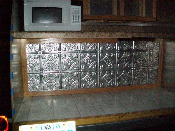

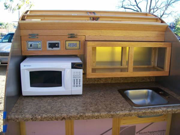

Today, I worked on the TD and permanently mounted the galley cabinet and the upper trim pieces after I waited for the third coat of varnish to dry from a few days ago, as well as the electrical control panel. I worked on the under counter area (Parnold, you wanted to see what was going to happen there) and I got that started even though it is not finished yet, I took some pictures for you all to see. What do you think?
The cabinet and trim looks good with varnish on it.
I used stamped tin panels (really it is plastic) I got at Lowes to dress up the under counter area. It is used as back splash in kitchens. I trimmed it with 1/4" x 1 1/2' red oak trim I made up.
I still need to cut it out for around the sink area but it has been a while since I posted an update, so here you go.

down under tech wrote:I used stamped tin panels (really it is plastic) I got at Lowes to dress up the under counter area.
I really dig those tin panels - They remind me of the ceiling panels I have seen in many old buildings from the 1920's. Very retro cool!

Postby down under tech » Sun Oct 31, 2010 11:00 pm
Sharon: Thanks for your reply. I think I may have a Teardrop by next spring. I am surprised I have gotten this far on it since I am always busy with something else. I am used to working a lot of hours in a day, so next weeks schedule will not be new to me. Like they say, "Just do it".
Alfred: Thanks, but I am not through using these panels in my build. I will be using these for my ceiling inside the cabin, but a different color though. This is called oil rubbed bronze and will contrast with my interior colors that I plan on using. I used the silver ones in the galley because of the aluminum trim there and for the "Silver Nugget" theme.
They make these in either 18" x 24" or 2' x 2'. The ceiling panels are 2' x 2' and the back splash ones are 18" x 24". I got the smaller ones for under the counter because the height I needed was 15 1/2". I saved a few bucks this way.
