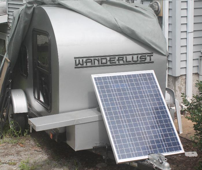

One last little addition. I purchased this panel for the new trailer, but since that is not ready, it will be used for this trip.
80 Watts of power, should keep me topped off with my minimal use of electricity.
ieheg2 wrote:Paul, what you want to connect to a solar panel? Or just charge the battery ...
