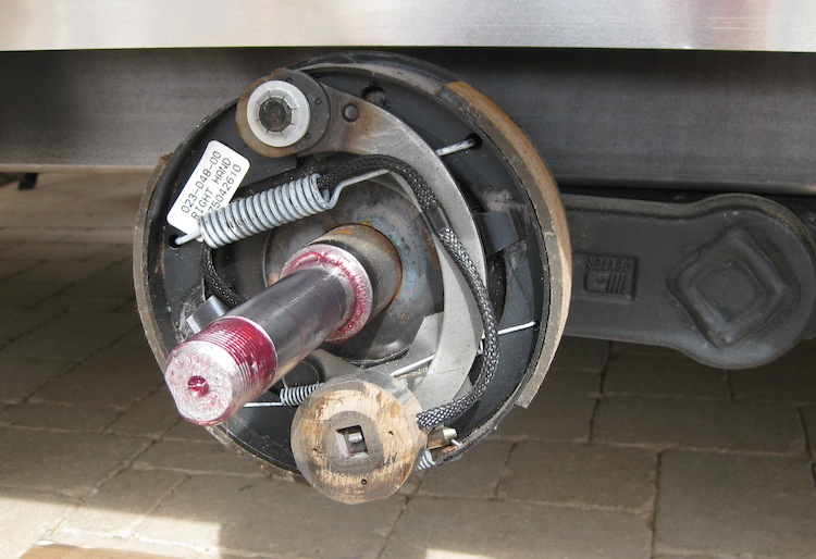

Mystery solved. Back when we tested the electrical connections from the 7-pin plug, everything worked except the brakes.
It seemed as if one solenoid was engaging but one did not. We heard no click coming from the brake drum.
Today, Gerald and I pulled the drum from the suspect wheel aided by his 3-ton hydraulic jack. Gerald doesn't just have tools; he's got a 3-ton hydraulic jack. How many folks have one of these industrial grade contraptions lying around in the garage.
Back to the brake. Take a close look at this picture and you won't see a solenoid. However, that circular piece of iron toward the bottom is an electromagnet. Mystery solved. Apparently, the electromagnet rides on the inside of the drum held there by a spring so when the current is applied to it, it really doesn't have to travel any distance at all so there is no thump or click.
This makes me wonder about what is happening in the other wheel. Perhaps the spring is missing or too weak to keep the electromagnet pushed gently against the hub. We'll pull that wheel later and take a look.
We went looking for a defective solenoid but found an electromagnet. But, we should have been looking for an electromagnet, because a solenoid is really an electromagnet.

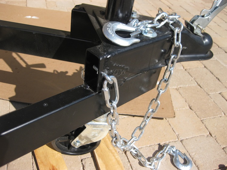

Here is the safety chain installation. The U-bolt, chain, and connector came in a kit from Reese. Interestingly, they did not include the hook to attach the chain to the tow vehicle. So, I had to get a pair of hooks at Lowe's.

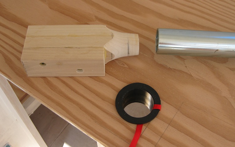

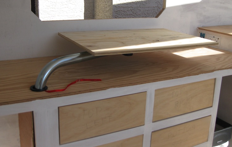

The moveable table is supported by a pipe. Using Gerald's lathe, we turned a support for the bottom of the pipe and later attached it inside the cabinet directly beneath the hole that you see lined with a grommet. There is too much slop between the grommet and the pipe so I'll have to do something to make the fit tighter.
Here's the pipe and a table top rotated over the sideboard.

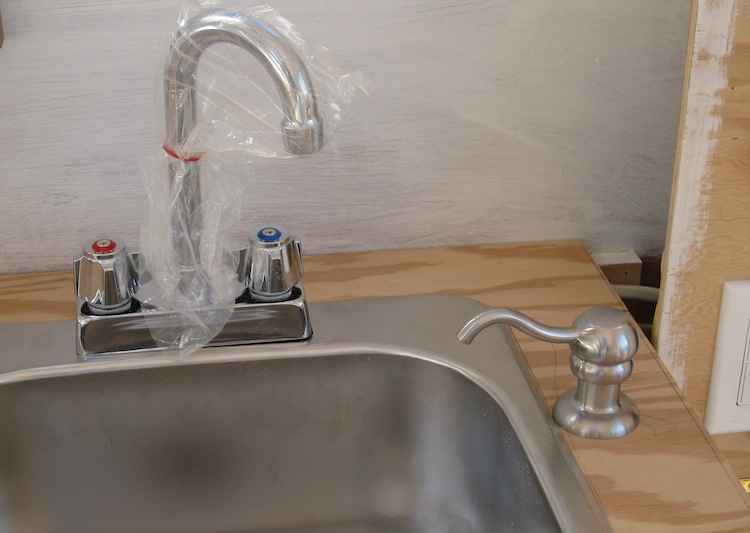

I had a soap dispenser lying around so I chose to add it to the counter. The bottle is beneath the dispenser plunger.

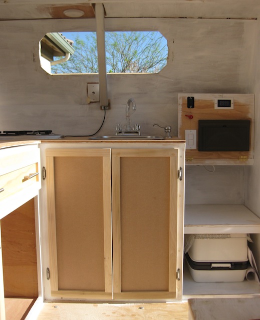

Here's another look at the galley area showing some of the equipment in place.

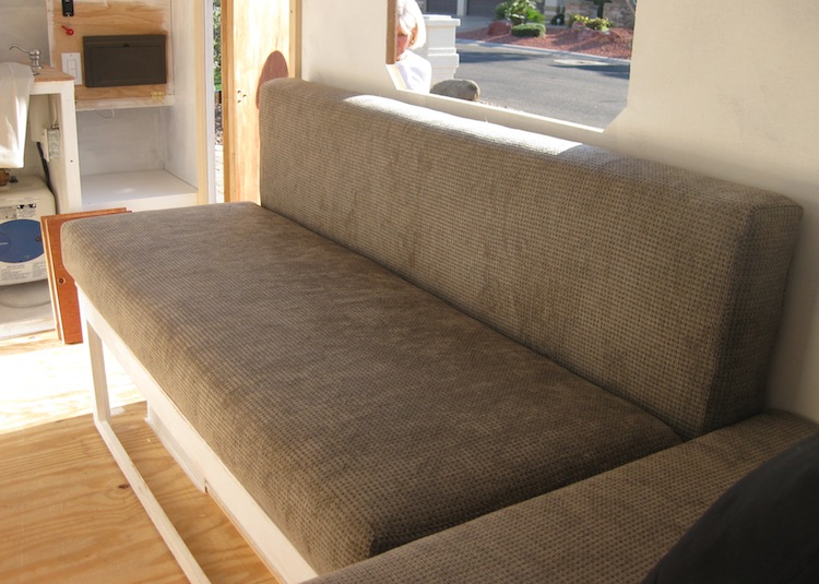

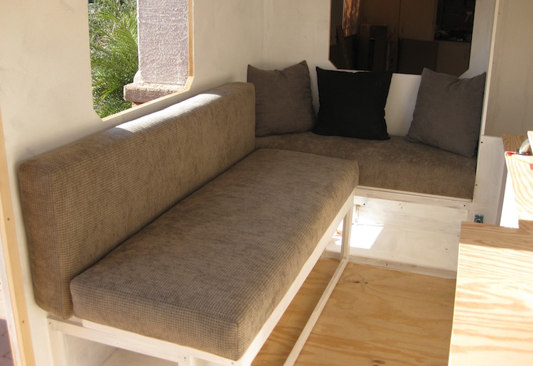

Today, our upholsterer brought the finished cushions for the settee/bed.

Postby S. Heisley » Wed Mar 23, 2011 9:12 pm
WOW! That upholstery looks terrific! How will you finish your counter top?

Thanks, Sharon. It looks even better in person. I'll cover the counters with Formica either pure white or something that complements the fabric.
Update: My wife and I checked out the offerings at Lowe's and decided that white formica was the best option. So, that's what I will do.

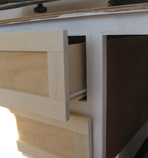

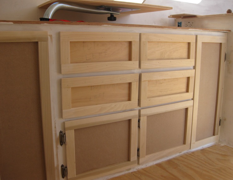

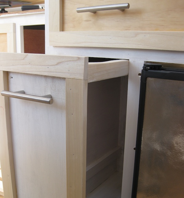

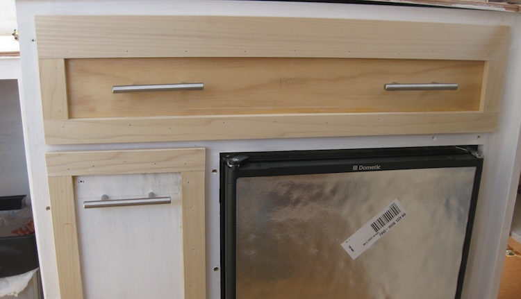

Finishing the drawers and cabinet doors has been pending for quite a while. I've purchased all the wood for this trailer from Home Depot, but couldn't find any sized wood suitable for either drawer trimming or cabinet doors.
So, I stopped by Lowe's and was pleasantly surprised to find half-inch poplar pre-cut in short lengths. Rather than adding a thick, solid front to the drawers, I now had the option of adding half-inch by one and one-half inch trim that I overlapped by a half-inch.
I may not put handles on the small drawers, but the large one over the fridge and the pantry both beg for some hardware. I like this type for its simplicity and for the fact that I can hang a dish towel from the handle conveniently.
After a bit of adjustment of the slides and some trimming on my overly tight fitting pantry drawer, it all works freely now.

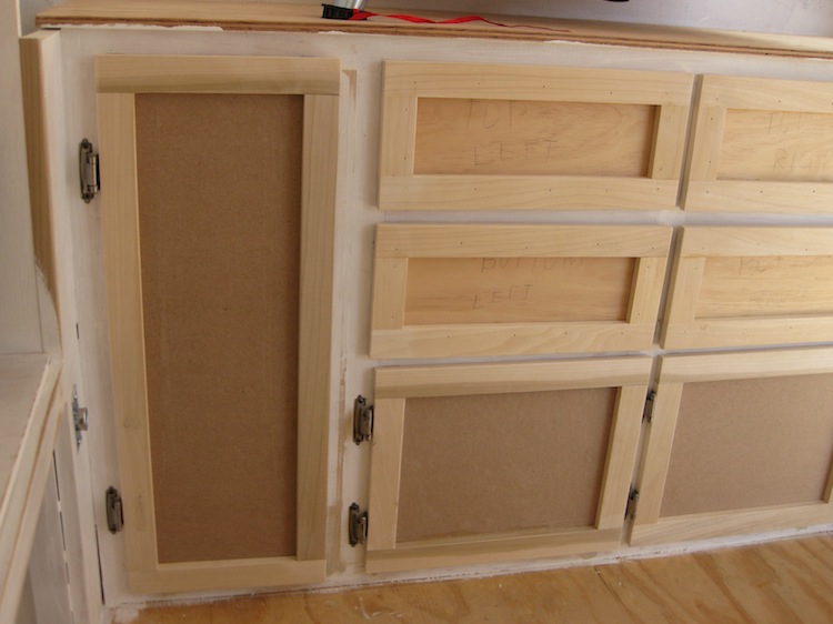

I finally found material to make the door fronts on six cabinet openings. It's sort of 1/4-inch MDF or pegboard material. Its major virtue is that it is flat.
So, here are the doors in place.

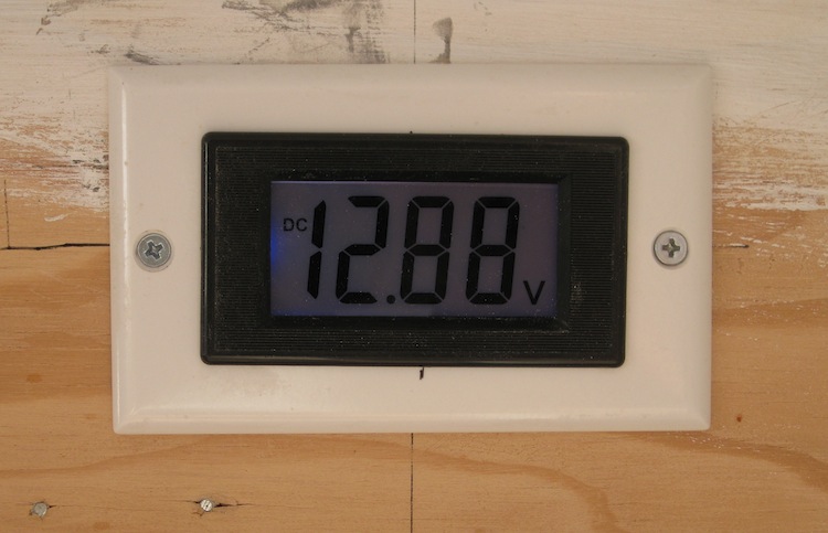

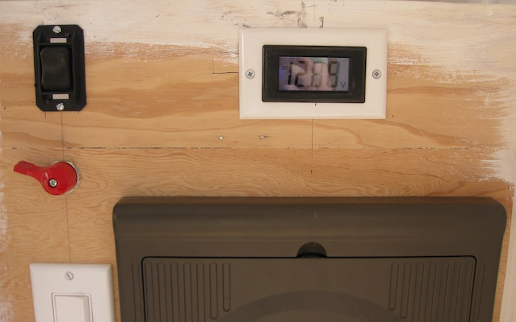

A while back I bought a digital volt meter on eBay for $1.00. The shipping from Hong Kong was $4.00. Then I spent three hours fabricating this cover and the hole in the electronic panel. Good thing my labor is free.

I went through quite a few elcheapo 12v panel meters from eBay before I got the same one you have. It's lasted a couple of years now. You can adjust it by turning a pot on the back so I set it to the same voltage my Fluke meter showed at the battery. You might consider switching it so you can turn it off as it's pretty bright at night.
