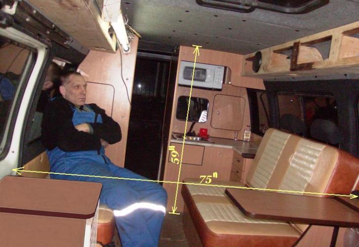

The size of my camper like yours!
In the photo, the result as I built.
Sincerely Sergei. Tomsk.

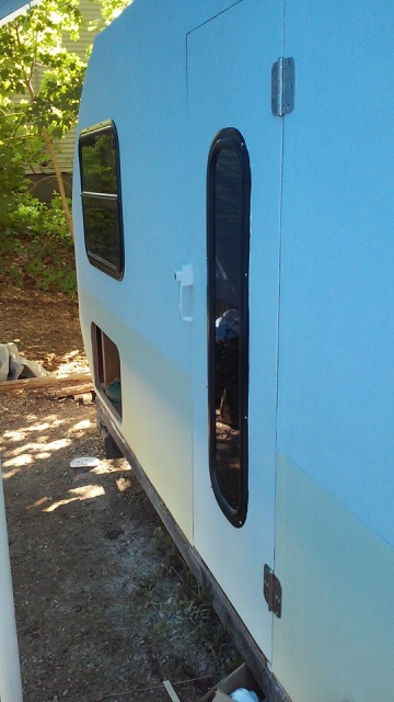

Here it is three years later and I finally got back to work on my trailer. I was discouraged by some little problems I had, and since I have my teardrop to camp in, it just wasn't pressing enough for me. After opening it up from it's multi layered plastic cocoon I notices a very small amount of water damage, which were repaired in short order. I put about another 5 coats of polyester resin on the whole trailer after I finished taping all the edges. Time will tell whether I made a good decision, but I used joint tape instead of fiberglass cloth. I used two layers, and it is actually made of fiberglass, and much, much, much easier to deal with that fiberglass cloth strips. I sanded the trailer each morning and applied as many coats as I could during the day. Yesterday morning I sanded a little more aggressively than usual and now I am in the process of applying the paint. I am using Karnak white roof paint. It is an elastomeric paint, but not quite as thick as roof coating. I had great success with the elastomeric paint on my teardrop roof.
It's still early in the day and I have tons to accomplish, I'll try to post some pictures later. My goal is to get it all painted, roof vent, windows, hatches, and door installed today!

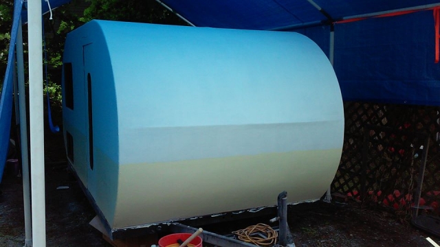

I worked on the trailer Wednesday through Sunday. Saturday and Sunday were brutally hot, but I persisted. I applied six liberal coats of polyester resin to the entire trailer, with as many as ten coats on the tape joints. Every morning I sanded the entire trailer to get a fresh surface for the polyester to bite into. Sunday morning, I sanded the entire trailer, more aggressively to prepare for the paint.
By the middle of Sunday afternoon, I had the trailer three coated with paint. Because I was using Karnak white elastomeric paint, I could not convince the guy in HD paint department to tint it for me, so I tinted the yellow myself using food dye. Unfortunately, I ran out of yellow before I realized I didn't paint the bottom of the door. I will stop tonight and buy a third gallon of the paint, so I can give the entire trailer an additional coat.
Once the paint dried thoroughly I mounted the door, and windows. I have yet to add the trim to the door to make it watertight. I'm still going back and forth on the best method to achieve that end.
One thing I learned, on an eighty degree day, you can easily apply a quart of resin with a paintbrush before it starts to gel. On a ninety plus degree day, I had all I could do to apply the quart. I literally slapped that stuff on to get to it before it started to harden in the plastic cup I was using.
I went through 36 3" paint brushes with the resin, and so far eight more with the paint. I bought the cheapest chinese brushes I could find. I used very close to three gallons of polyester resin, and a little more than a gallon and a half of the paint so far. I went through about 175 feet of joint tape.

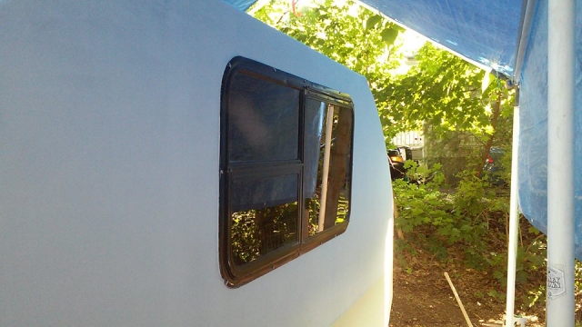

I still have two holes in the sides of the trailers where the hatches will be mounted. I need to slightly enlarge both holes to get the hatches to fit.
I have a planned camping trip in three weeks, so once the hatches are done, my big goal is to get the stop/tail lights installed along with the side markers. I'm ordering my memory foam matress and some drip caps today or tomorrow.
