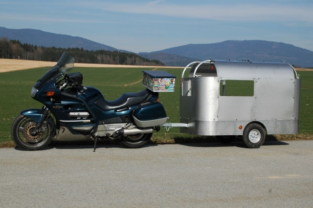

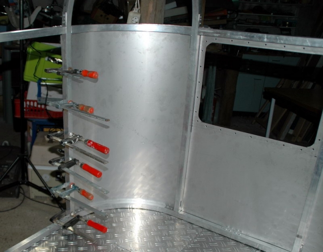

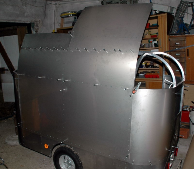

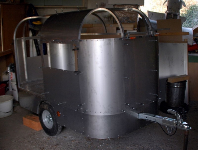

ST1100 wrote:Best weather here in Southern Germany so I used it to spend my Saturday in the garage.

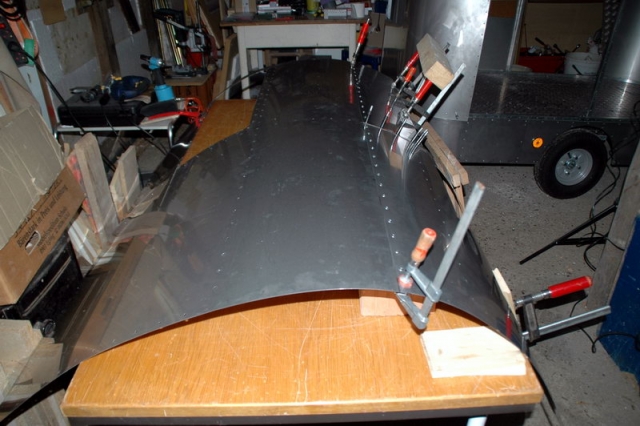

I closed the left sidewall with a big sheet 1440 x 1000 mm and drilled and deburred a lot of 4 mm holes.

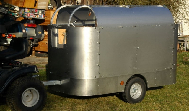

Set all together and made a first rollout into the sun.

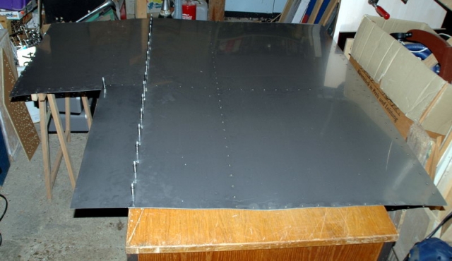

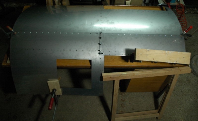

Then I cut another smaller sheet to enlarge the big sheet so I can close the rear part of the roof with the connected sheets.
