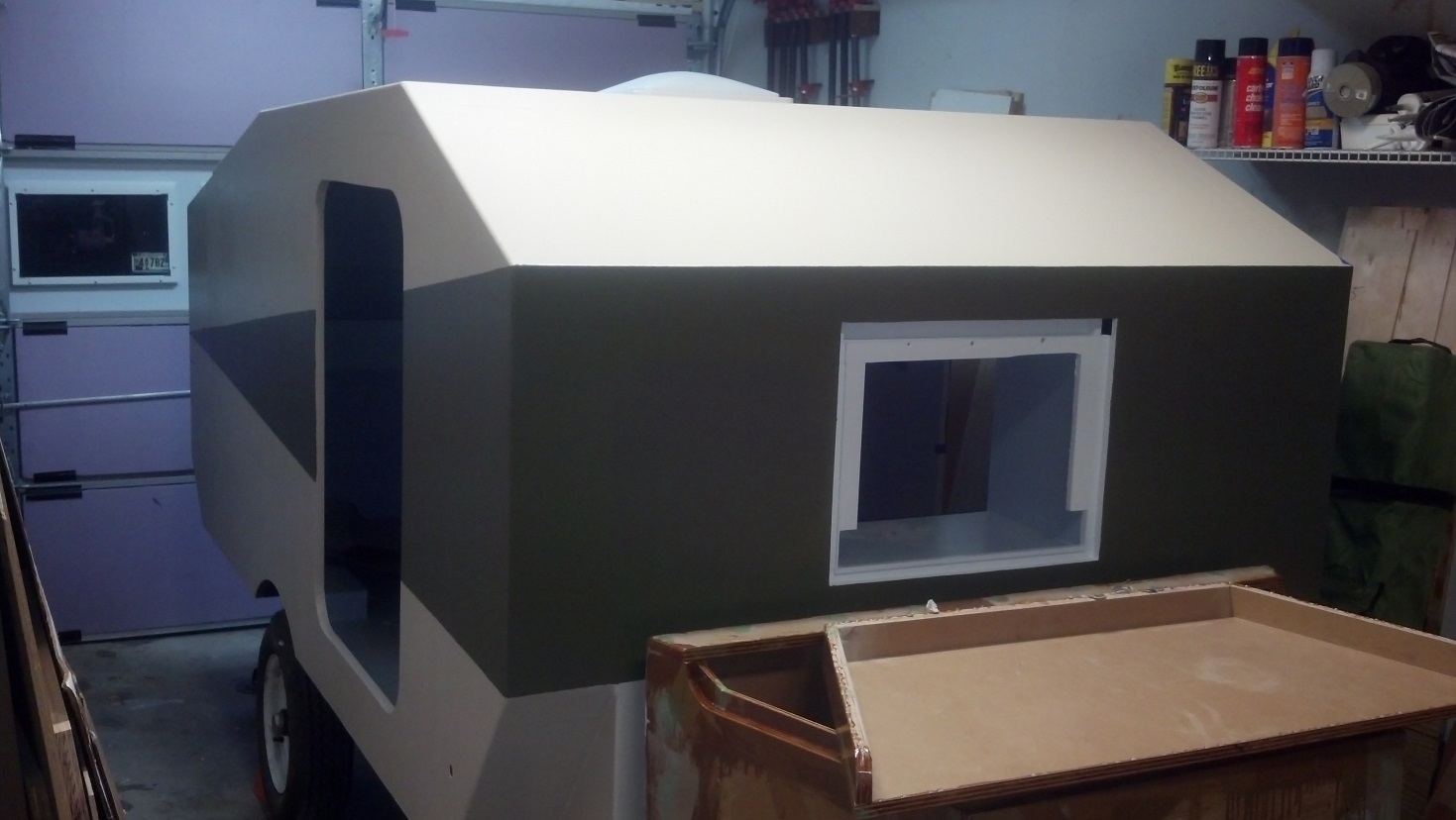

Today's weather has been great so far. I started off by epoxying the tongue box's lip, the lid, and sealing the patch on the hatch from my little incident. Then I put the first coat of paint in the galley and the green on the accent.
20140914 accent and galley small.jpg (148.33 KiB) Viewed 2038 times

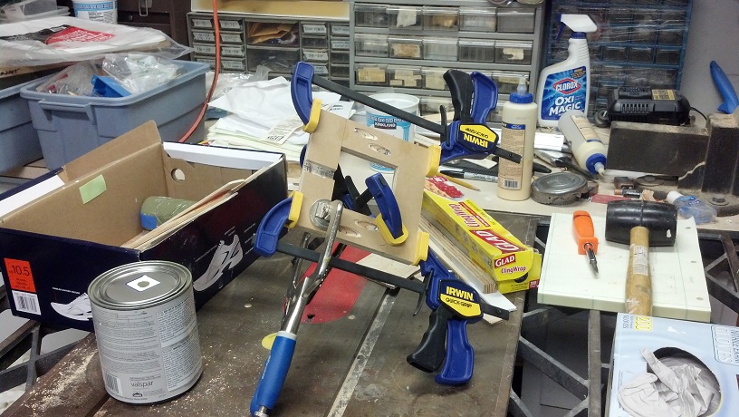

I also cleaned the shop a bit (it really needed it :lol: ) and made a riser for the hatch light, since the one I bought is designed to be surface mounted and have the wires brought in from behind. So I made a ring out of 1.5" boards and dado'ed a space for the wire to use.
20140914 hatch light riser small.jpg (188.1 KiB) Viewed 2007 times

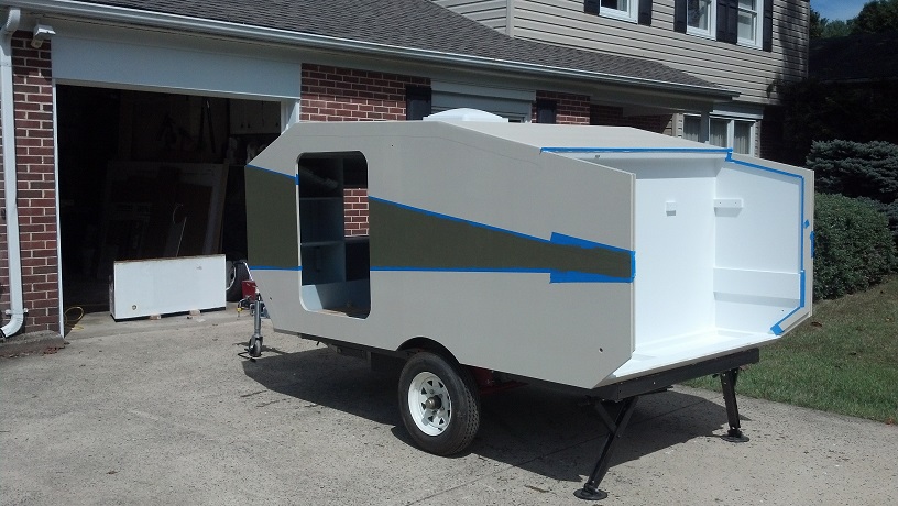

I pulled the tape off the front and the curb side this evening, I didn't feel like getting suited up to sand the epoxy on the lid or tongue box this evening, maybe tomorrow.
20140915 tape off small.jpg (203.64 KiB) Viewed 1971 times

I found four places that I'll need to touch up on the accent, mostly where my hand or roller brushed the tan region. I also had a problem with a little of the green bleeding under the painter's tape, but since it is consistent and along all of the edges I'm just going to live with it vs try to get a razor-sharp edge.

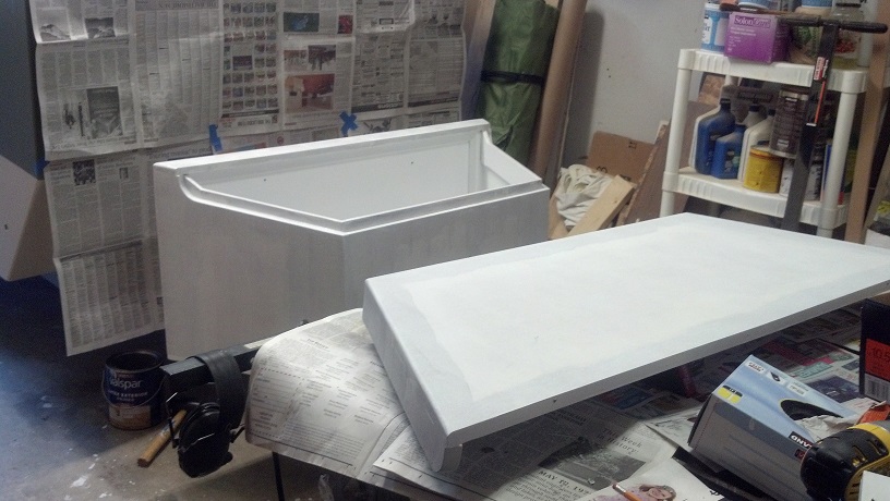

Postby Kharn » Fri Sep 19, 2014 9:35 am
I made a critical oversight in my paint supplies and ran out of white paint last night, but not before getting the first coat on the hatch, lid and tongue box interiors, the lower hatch and one of the side tables. So today I've switched to priming the exteriors, and I'll run out for more paint and a few miscellaneous things later today.
20140919 tongue primer small.jpg (135.09 KiB) Viewed 1785 times

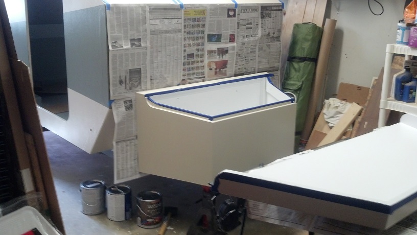

Postby Kharn » Sat Sep 20, 2014 11:17 am
Yesterday was a marathon day, two coats of primer and two coats of paint on the tongue box, lid, hatch, and lower hatch exteriors. This morning was the final coat of white on the interiors of the same and the side table tops. Now I just have minor stuff to paint like the electrical rings, the side table bottoms, hatch prop, etc, and touching up a few areas that need attention. :P
20140920 tongue box paint small.jpg (106.34 KiB) Viewed 1740 times
