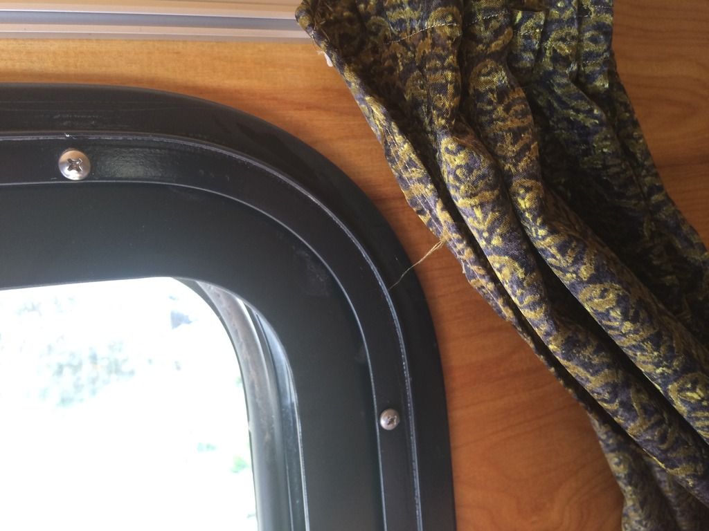

Postby tony.latham » Thu Sep 24, 2015 10:35 pm
noseoil wrote:Tony, did your trim ring "pucker" at the corners or did it lay flat?
Nope. They're flat.
Edit: I just walked over to our 'drop and snapped this.
Now I'm tempted to walk back out there, get in, turn the fan on, and take a nap. You may have made my day. 8) It's a nice Indian Summer day up here.
