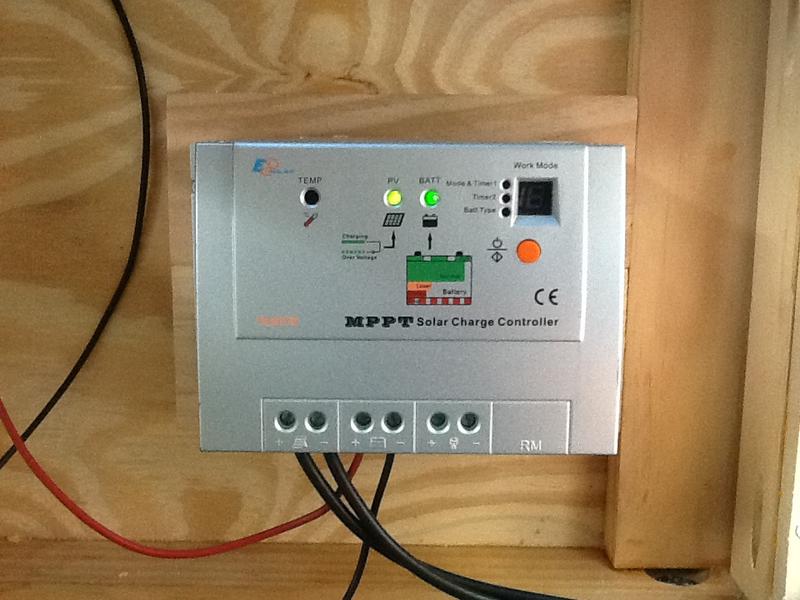

With the side utility doors open, I found it was bone dry inside. :thumbsup: Very glad of that, since the electronics are in there. I did a couple of small projects with the electrical:
1) I hooked up the 1000 watt pure sine wave inverter using 2 gauge cables. It works great! About 30 seconds after turning it on, the automatic transfer switch senses the current and then turns the power on to the household 120 v AC outlets. My multimeter showed 128 volts at the outlets, so there is plenty of AC power! The inverter is now wired and ready to go.

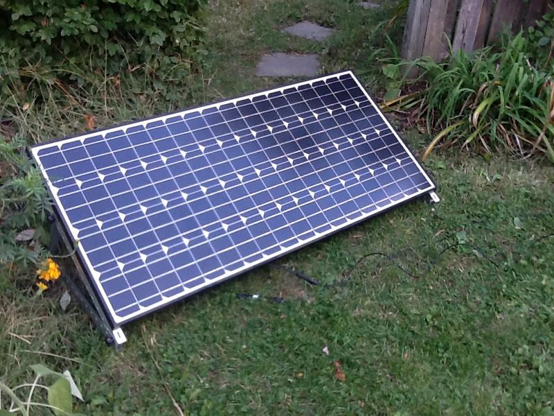

2) I built the aluminum frame that will hold the solar panel to the roof, and bolted the solar panel to it. The solar panel can now be positioned at a ~40 degree angle, which is about ideal for this latitude when it is pointed south. The frame can also be collapsed and secured flat for travel, or for when the trailer cannot be parked pointing south.
3) I hooked the panel up to the Tracer charge controller in the trailer for the first time (wires out the door and solar panel sitting on the driveway). What I found was even on this cloudy, drizzling day, the panel outputted 28 volts. The batteries registered 12.52 volts before connecting the panel, and 12.68 after, which means they are getting positive juice from the system. It will take a much sunnier day to charge them fully, because that would take 13.5+ volts. I believe something like 12.8 volts registering from the battery after it has sat a while and equalized is a full charge.
After playing with the electrical for a little while, I disconnected the solar because I didn't want to charge the batteries long enough to accumulate explosive gasses under the tarp. (I need to buy a hole saw of the right diameter so that I can install the battery box vents soon. Until then I will only charge the batteries when I can vent the whole trailer.) Next, I buttoned up the tarps again and secured them with ratchet straps. We are still going to get 40+ mph wind gusts and scattered showers from the hurricane offshore, and I want the trailer to be ok overnight. Maybe tomorrow afternoon I can take the tarps off and dry everything out.
I'll report on the condition of the roof at that time. Thanks for reading!

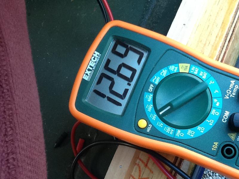

Postby lfhoward » Sun Oct 04, 2015 5:13 pm
This afternoon I took the tarps off the trailer and there is no water damage!!!

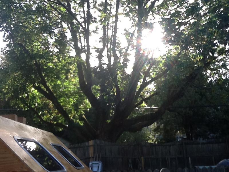

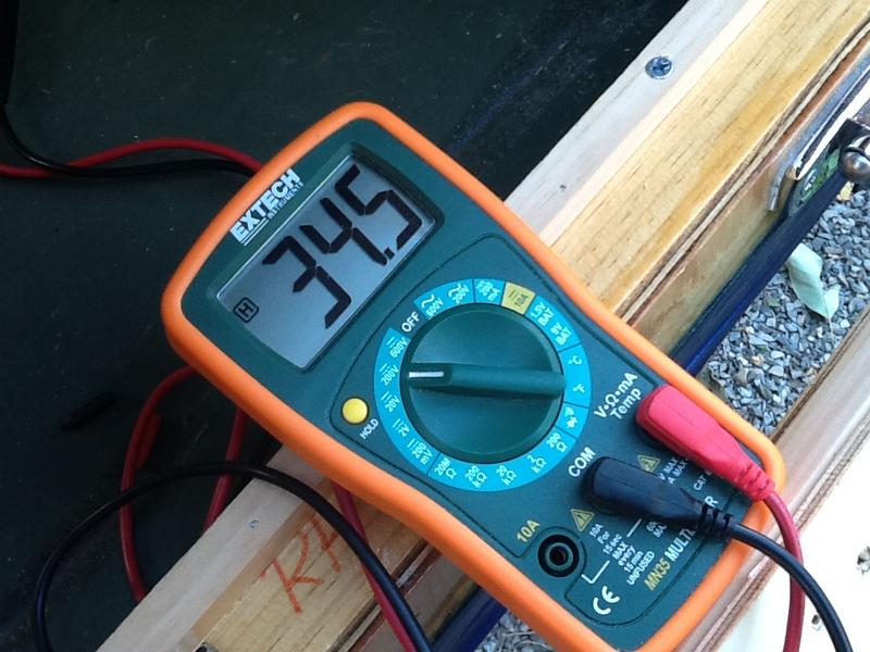

I also put the solar panel out again to see what kind of output I could get from it.
The light was diffuse because of my neighbor's tree, and it was about 4 pm so the sun is low in the sky.
Even in this situation, the panel cranked out more than 34 volts!
The battery, which was at 12.4 volts or so when I started, got up to about 12.7 within an hour or so. It seemed to equalize there, probably because the sun was going down.
Here is the trailer, chilling in the yard with wires from the solar panel. And the Tracer looks happy.

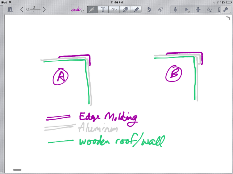

Thinking ahead to skinning with aluminum, I have a quick question. It is hard to explain, so I drew a picture.
In "A", the aluminum sheets meet at the corner, and the roof edge molding covers the gap between the sheets. That molding, plus butyl tape and some screws from the top, makes the waterproof seal.
In "B", I have the roof sheet bent over the side sheet before covering it with the roof edge molding. Thus, the roof edge molding isn't solely responsible for waterproofing the seam, and is mostly cosmetic.
Which is the better method?
The advantage of A is that it would be easier to make the aluminum fit the edge, especially if the trailer isn't exactly square (which would be important factor for the fold in B to be positioned properly). The advantage of B is no water gets between the wood and the side aluminum if the roof edge molding seal ever fails.
I have seen method A on this forum, but never method B (so far). My neighbor, who is a roofer and someone who has made trailers before, suggested method B tonight. I thought I would run it by you all for feedback.

I did the "A" for mine. The width I have to deal with (due to the frame I found), is 60 5/8" or 5/8" larger than the sheet size of aluminum available to me. I split the difference on both sides, put butyl rubber tape on the trim & screwed it down. So far so good, but the tarps are in place & it's starting to rain this morning. Will have to see once it's out from under the tarps, but I think it will be fine. With .040" aluminum & 1/8" tape, there's plenty of room for it to mush down & seal.
Don't worry, your plan with the "A" detail will be fine. The "B" plan has too many places for problems as I see it. If the sheets are not made perfectly at the fold, it won't work & you will be cutting off the bent section and back to "A" anyway.

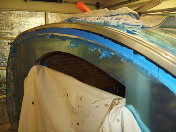

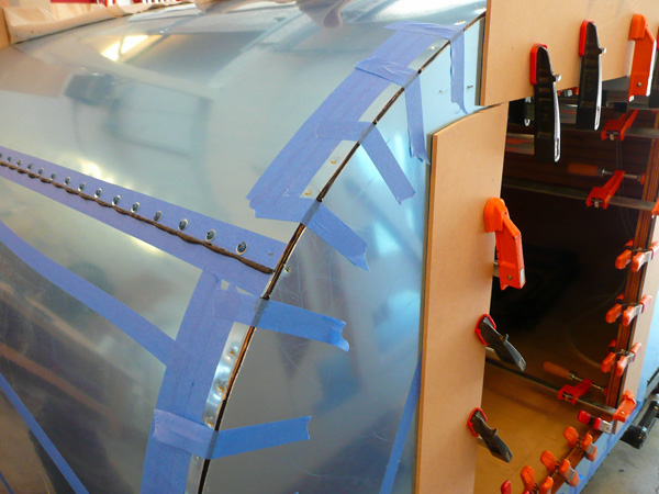

If you are using .040 aluminum, it can be quite stiff to bend 90 degrees.
I used the "A" method with an additional step. I used sealant between the aluminum and the plywood along the outer edges. Then I bedded the trim in sealant. All fasteners were pre-drilled, sealant injected in the holes, and the fasteners were screwed into place.
Picture showing sealant squeeze-out prior to installing trim:
Trim bedded in sealant:
