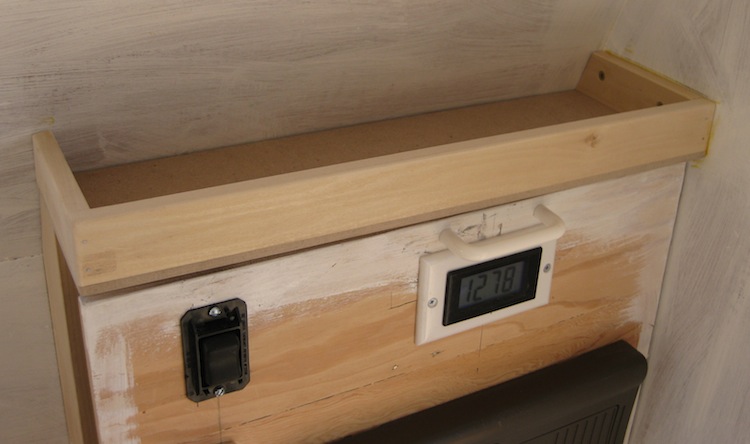

I went through quite a few elcheapo 12v panel meters from eBay before I got the same one you have. It's lasted a couple of years now. You can adjust it by turning a pot on the back so I set it to the same voltage my Fluke meter showed at the battery. You might consider switching it so you can turn it off as it's pretty bright at night.
Thanks, Bruce. Good advice. Didn't know that it was adjustable. As for the light, I'll treat it as a night light. The electrical panel is over the porta potti, so I'll have a beacon to follow when nature calls.

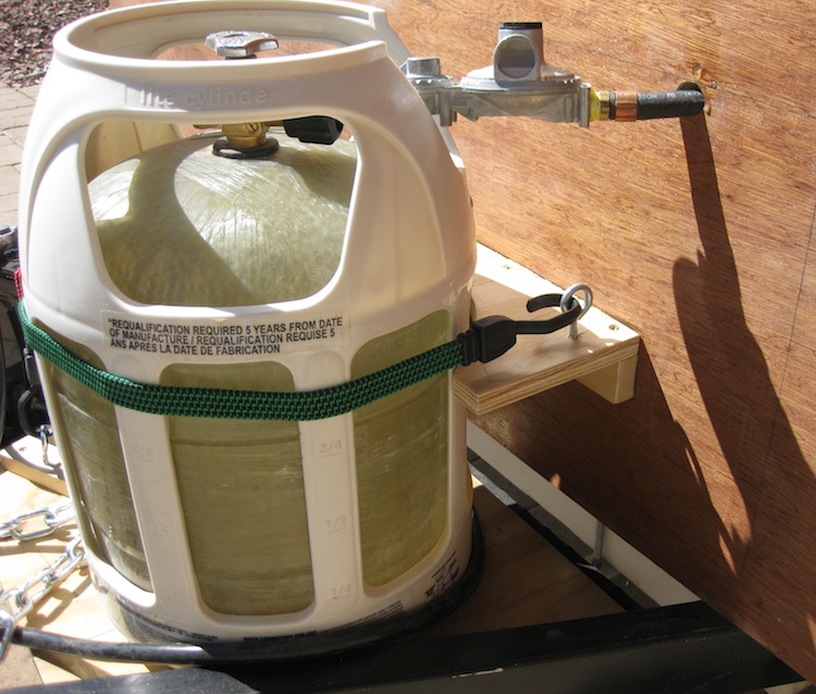

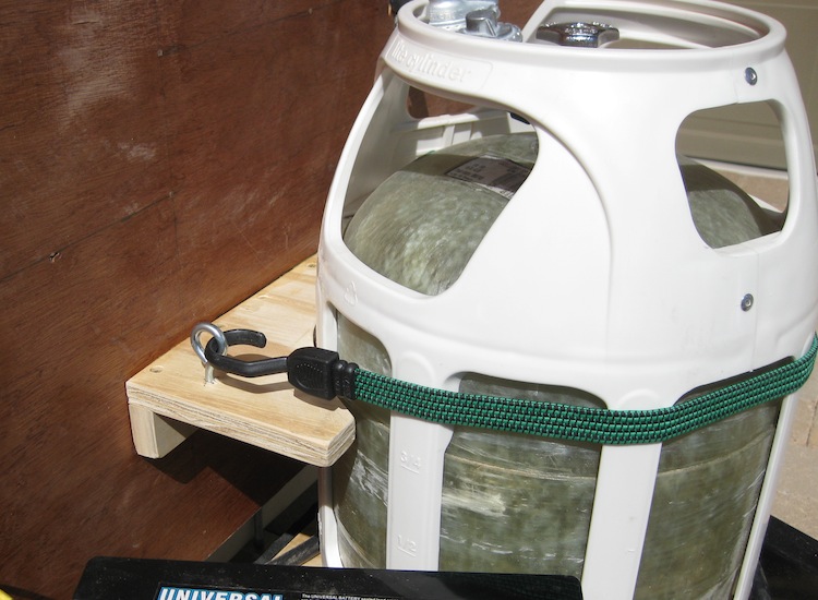

For example, here is a bracket I fabricated to hold the propane bottle in place with screw eyes to attach a 30-inch flat bungee cord.

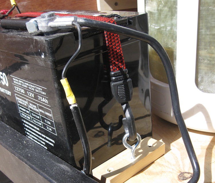

I used the same idea to tie down the battery with a 20-inch flat bungee cord.
The masonite or MDF door material serves as the base for a nice little shelf for keys, wallet, flashlight, etc. over the electrical panel. You'll also notice a plastic handle above the digital volt meter that I can use to open the panel.

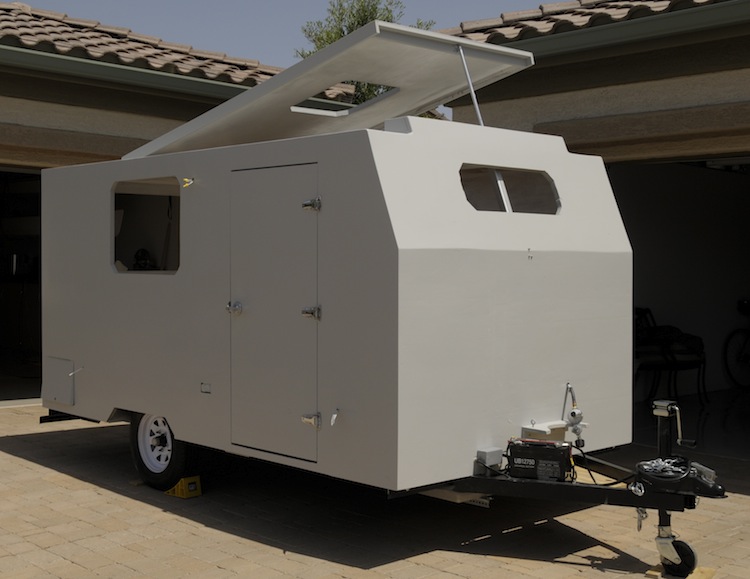

Postby myoung » Thu Apr 14, 2011 2:29 pm

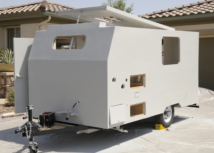

Yeah. Juan has come to paint my trailer. It's a silver grey from ValSpar in a semi-gloss finish. With 5 gallons, Juan was able to give it four coats.
Got some touching up to do and now I see a few places that need some additional filling. Not unexpected.
So, tomorrow I'll begin putting lights, vents, fittings, and maybe even windows in place.

Postby myoung » Fri Apr 15, 2011 6:54 pm

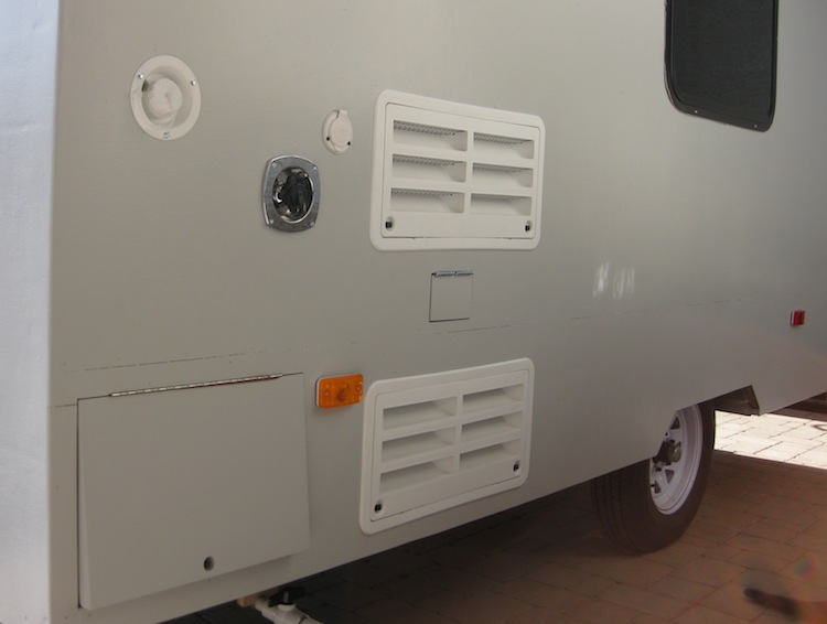

Now that the paint has had a day to dry, I can install the various lights, electrical plugs, and water intake connectors. Also, with the help of Gerald, we were able to install all five windows too.
This is fun. Seeing the pieces all come together to make my concept a reality.
Tomorrow, I hope to trim the door and perhaps the cargo doors. Next, the diamond tread plate trim can be added.

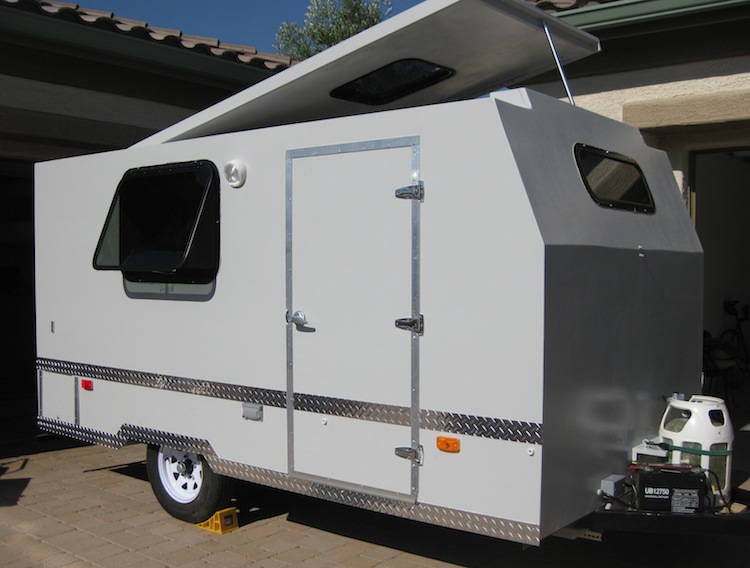

Postby myoung » Sat Apr 16, 2011 8:56 pm
StandUpGuy wrote:Awesome job! Nice clean solution on the pop up. I like how it is tucked behind that build up in front for when you are under way. Nice and secure.
Thanks. Now that the mechanism is in place, I see that the slot could have been even smaller. It will be easy to add a rubber flap to the top to keep out the rain.
Mike Young

Postby myoung » Sat Apr 16, 2011 11:21 pm
StandUpGuy wrote:I see in looking again that the lift mechanism is indeed electric. Pretty cool.
I also see you have a grey water tank underneath. Did you run a vent stack up and out? How have you done it as I am building a pop top with a black water tank. I have yet to figure out how exactly I will vent it.
Actually, this is a grey water tank. Venting isn't or shouldn't be an issue because there is a gap around the sink drain pipe and the inlet grommet in the top of the tank.
The linear actuator can lift 150 pounds but in this case there probably aren't more than 40 pounds at one end. It only takes about 20-30 seconds to extend the full 18 inches. For even more coolness, it could be activated with a remote control switch but I just use the rocker switch manually.

Postby myoung » Sun Apr 17, 2011 6:45 pm

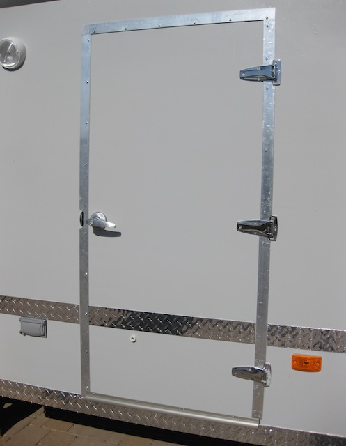

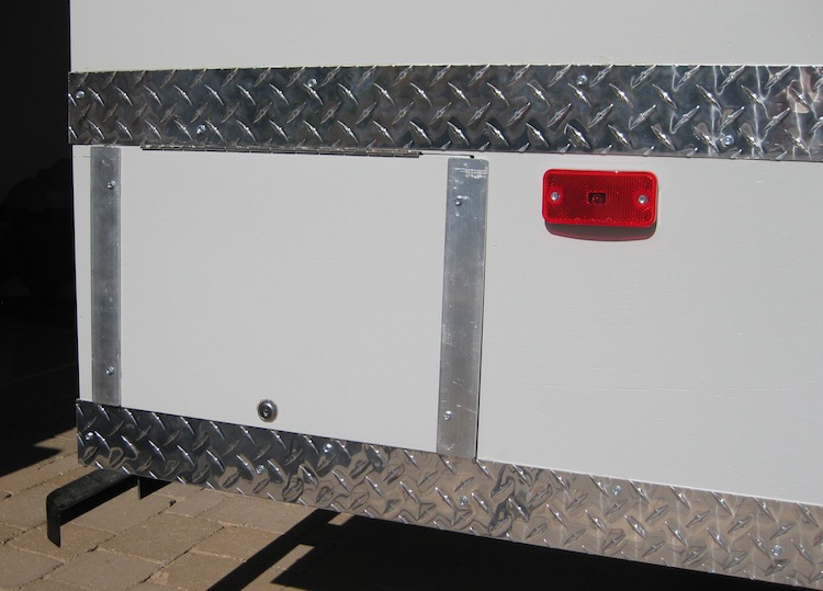

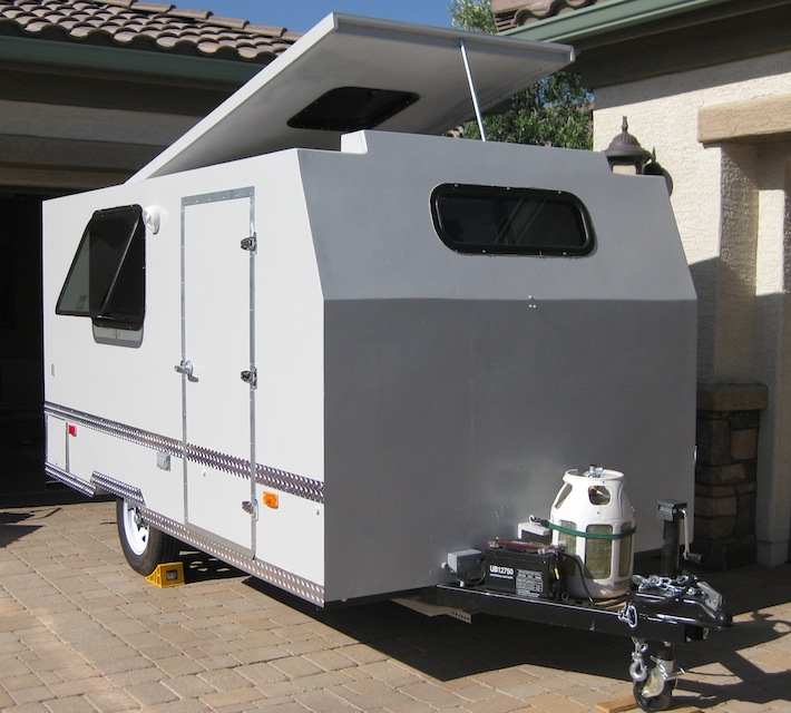

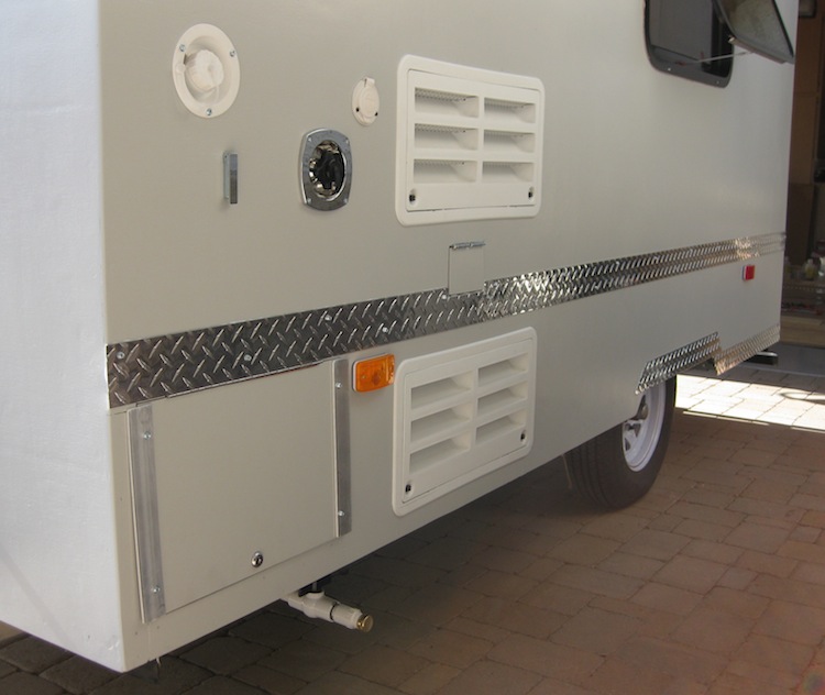

Saturday and Sunday were spent fitting trim pieces around the beltline, the bottom edge, the cargo doors, and the entry door.
Look closely and you'll also see a couple of door stops to prevent the entry door from crushing the forwardmost side light.
Tomorrow, I'll fit the last of the trim pieces along the bottom edge. After two days of 96+ degree temps, I couldn't summon the energy to finish today.
The two cargo doors are trimmed with 1-1/2-inch flat aluminum stock to overlap the sidewalls. There is also a keyed lock that needs a little adjustment.
The entry door has the same 1-1/2-inch stock around it. Fitting the pieces around the hinges took quite a lot of fitting, filing, fitting, filing, etc. but I think it was worthwhile.
The front of the trailer will have a full-width 2x8-foot sheet of diamond plate folded around the battery and propane bottle. That should more or less complete the exterior.
