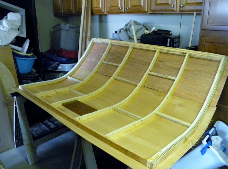

Well things happem and did not get enough done on the tear but one thing............................................................... HATCH IS SKINNED!!!!!!!!!! Did it differently thanmost by doing the small half first 18"x 67" and clamped it down and had it setting for most of last week then Saturday I put the hatch on the tear and the hatched had straightened a lil. Didn't get to work on it rest of night so put it off til next morning when I glued half of the rest of the skin on the hatch and screwed it down with #8 x 1/2" screws every 4" down the hatch spars and cross pieces. This was the main curved section and when I finished left it to dry in the hot garage til today. I pulled the hatch off set it on the saw horses and checked the glued edges on the spars and they were all good and tight :D. So I then pushed the bottom section down and started glueing from inside of the hatch and started one side with the skin straight and tightstarted screwing from the stop point to the bottom hatch full cross piece thus taking any slack out and smoothing it as I went. I guess you could say I wetted the skin from the sweat tha was pouring out :oops: but thats working in a garage when its 96 degrees and your dumb enough to forgrt to turn the fan on! Needless to say by doing it this way it ended up stretched ting and layed flatter. Only thing I will need to do to finish the hatch is to glue strips across 3 sections of skin at the seam where there was no cross pieces and you can see thru the seam. Hopefully I can do that tomorrow evening as I will be out of area working rest of the week. If so Friday night will be filling holes with putty and the epoxy and taping this weekend! Doors are on hold until I can figure the gap needed for Vintek Tech T mold and seal and door jambs. Thanks for reading guys and the encouragement maybe can have ready for a gathering in September!

Becky its easy to bend mostly on the curves but so far finding a way to keep it fastened has been fun. Grant said to use carpet nails and so far neither of the box stores has any of them. Screws poke out to much and brad nails eventually pull out. I picked up some brass screw nails and will try those sometime this week. I did find out that between the t-molding and the edge/jamb molding you have to have atleast a 1/4" for the t weather stripping I got from Frank. Ths means you have to have atleast 1/2" gap between your door and wall in the opening, whic h has left me doing alot of shaping on the door with a sander :lol:. Sometimes just to fix some of my earlier fixing! The hatch has come away with the skin glued good but I need to add extra support so I can reglue the seam.

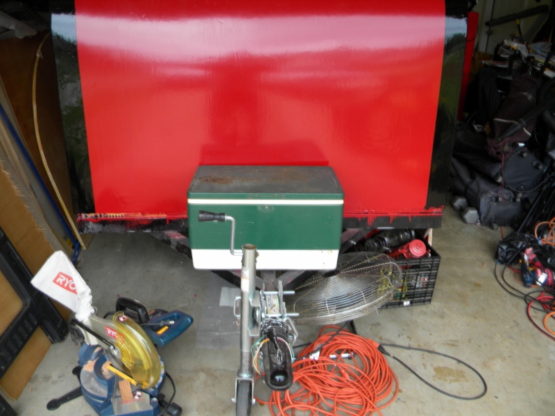

I will try and get that this week as I will be home every night this week and should be able to get some more done on the tear. Just as a side note, this is a cooler a friend gave me and after I paint it this may be its final home:
Its a 6/77 coleman steel belted cooler that will become a battery/stabizers box on the tongue.

I know how you feel about your trials and tribulations building your hatch. Believe it or not, I had problems with mine when I built it. Mine was sprung too much when I skinned the outside of it. I had made a template for the proper curvature before I started it. I used some cargo straps and bent it to the correct shape using the template as a guide on each side when I did the inside skin. I used PL Premium to adhere the skin to it and screws that I removed later. I left them on there for a whole day before I released them. I was glad that it held the right curve when I released the straps. I just filled the screw holes with wood filler before I epoxied the hatch.

Thanks Johnny I'm too worried about the hatch because I may make a shim to use on one side that should shift the hatch to bring the other side down to where it needs to be. I will try that this weekend and start puttying some of the holes in the sking now to get it ready for epoxying.
