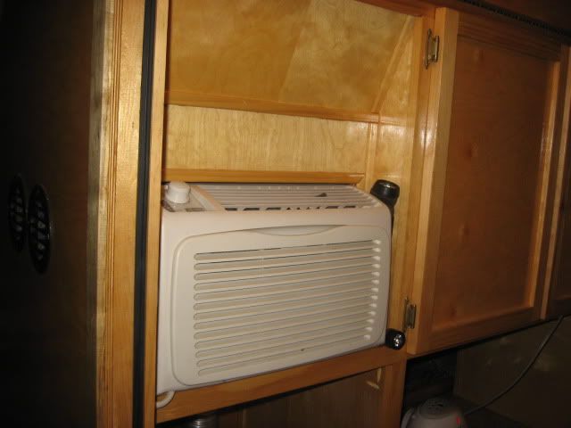

Well I finally got out and took pictures of the finished air conditioner cabinet.
This is the inside cabinet built for the air conditioner.

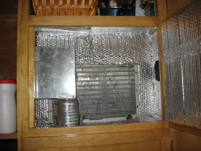

This is the back of the top cabinet, I put bubble insulation to separate the intake from the out. There is a vent to the galley and the outside for intake that is not visible here. These are the exhaust ports.
This is the cabinet under the air and the tubes go to holes in the bottom. Takes out an amazing amount of heat. The plumbing parts have screw in caps for winter storage.

Thank you Miriam! You reminded me to put in my drain tube!!! Does yours work ok for you? No overflow?

Postby Miriam C. » Fri Apr 17, 2009 9:21 am
2bits wrote:Thank you Miriam! You reminded me to put in my drain tube!!! Does yours work ok for you? No overflow?
The overflow works great. We have very high humidity here and a quart of water is not unusual here. If you can see it the overflow just hangs in the vent tube and out the bottom of the camper. It is longer than the vent tube so we are not making mold. 8)

I was also kinda worried about the overflow overflowing the drain pan itself. I have heard stories about when you get up in the morning hook up and take off, water from the pan flows over onto the floor. Any issues with this or is the tube taking care of it ok? Sounds like it is.

Postby Miriam C. » Thu May 28, 2009 10:11 pm
Guys I put 3 coats of epoxy in the box for the air and ran it about 2" up the wall just in case. One of the other things you can use is shower pan liner. Comes in a sheet and can be seamed the way pvc pipe is.
Scott, I have the over flow hose in the air exhaust tube. It is the clear tube in the bottom right corner of the picture. It just hangs there. If you find you are not getting enough water out fast enough you can always tip it. My air sits at a slight angle too.
Postby 2bits » Thu May 28, 2009 10:24 pm
Thanks Miriam!
I see now that you have two air exhaust tubes! One out of the fan and one natural flow where the drain tube is. I was confused before. I mounted my AC unit at a slight angle back too, I would rather overflow go back into the exhaust box rather than into the cabin. I will do the same thing and coat the floor of my exhaust box with something and add a tiny drain hole. I like silver "bubblewrap" insulation too, I have some of that exact stuff left over from a car restoration that I think I will use. Thanks! :thumbsup:
