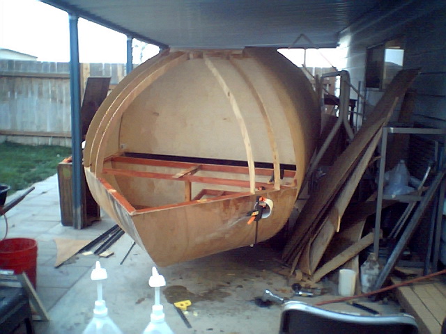

Worked on fiberglass today, I hope this heat breaks soon, so the fiberglass it not going off as I put the last of it on.

To start I have an engineering question, the spars that give the skin shape. What forces are being applied to these. Is the skin trying to push them in, and/or out. Are there side to side forces being applied to them. All this to ask how securely do I need to tie them to the skin. With the current heat (40c or 100f) fiberglass is a challenge. So if I am to work on this over the summer I need a alternative.
Doug would primer and paint seal the wood. Living in the middle of a desert humidity is not a huge concern.

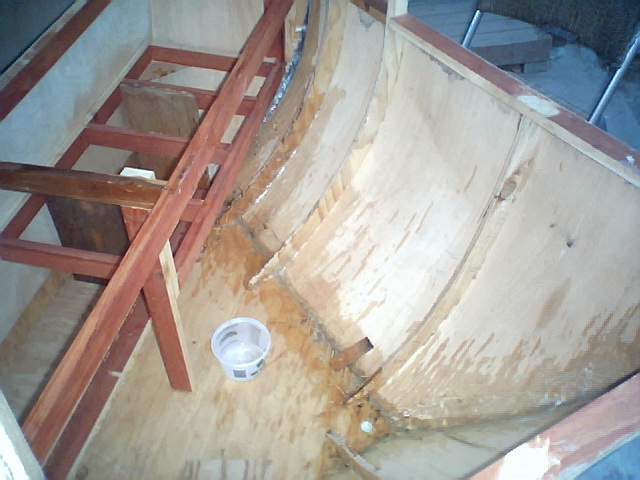

Postby del » Sat Jul 14, 2007 11:46 pm
Yesterday I did as Doug suggested and rolled resin on the inside of the galley. Looks the same as before only with a glossy finish, but will be more difficult for water to soak into.
Today I drilled a hole for one of my tail lights, and started to install the pipe that will make it frenched in. After the resin dries I will trim it off flush with the body, and finish glassing it in.
Then put an end on it that allows me to mount the tail lights, complete with blue dots of course.
