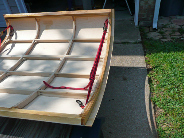

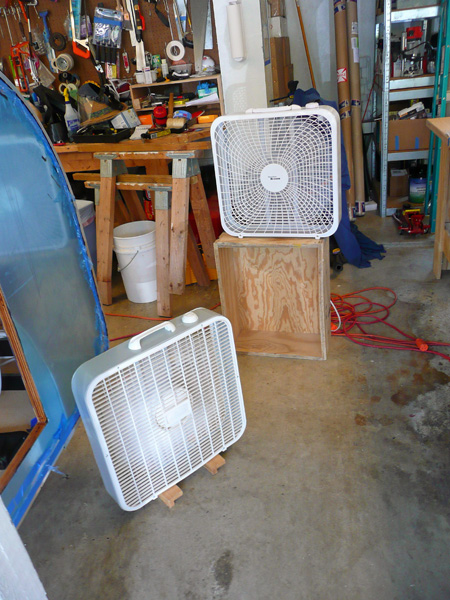

Pressing onward...sort of. I haven't had much time to work on the SB in the last two weeks, but I did manage to get time to do some epoxying.
First up - epoxying the inside edges of the hatch.
Then I added a second coat of epoxy to the tongue box that will house my Petcool.

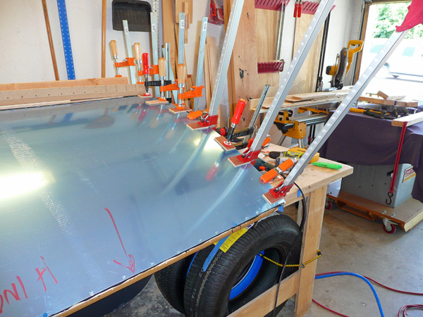

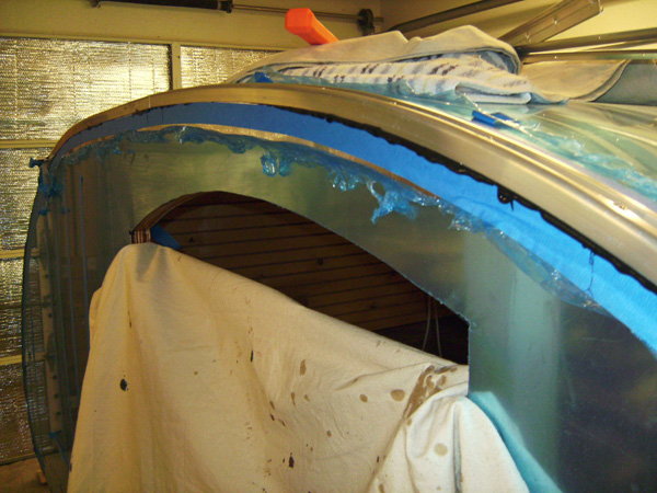

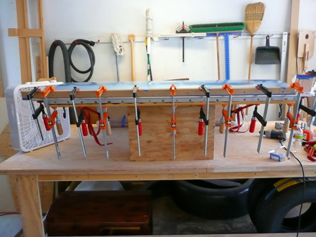

The "skinning" of the Silver Beatle continues. First up, I added aluminum to the underside of the hatch edge. The aluminum is adhered with 3M 4200.

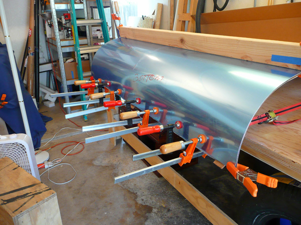

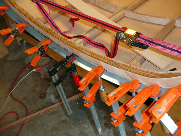

After a little set time, I flipped the hatch over and began applying the skin. As it turns out, I need to use two sections of aluminum on the hatch. The first section as applied to the bottom of the hatch. I used 3M 4200 around the perimeter, tacked the skin in place with staples, and clamped the assembly.
I then turned the hatch around and added the second section of aluminum. The aluminum is overlapped to form a seam. Screws are used along the seam edge.

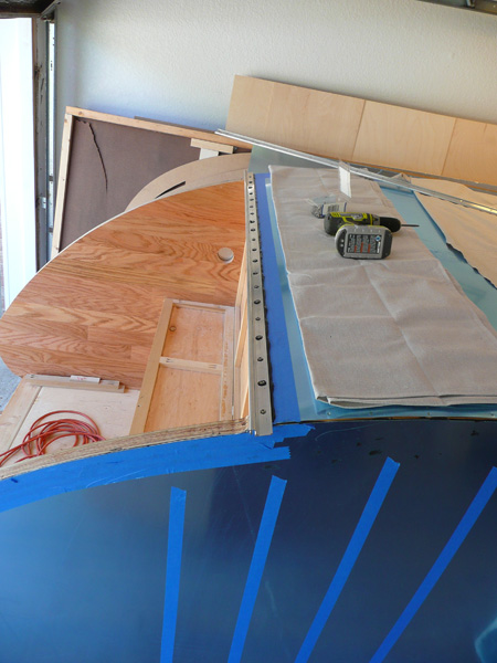

Next, I installed the hatch hinge sections on the teardrop and the hatch.
Then I finished the day, by starting to fit the edge trim.

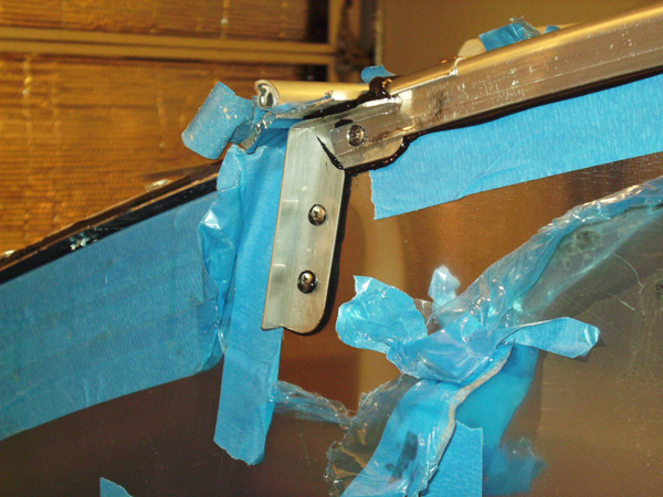

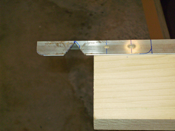

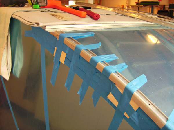

My procedure has been to test fit and then install. I was putting off fitting the edge trim for the hatch. I don't have a picture of it (lost my camera on vacation) but I used a piece of plywood cut to the profile of the hatch to bend and shape the trim. I then placed it on the hatch to drill holes for the rivets that will fasten it in place. I used 1/8" plywood as spacers.

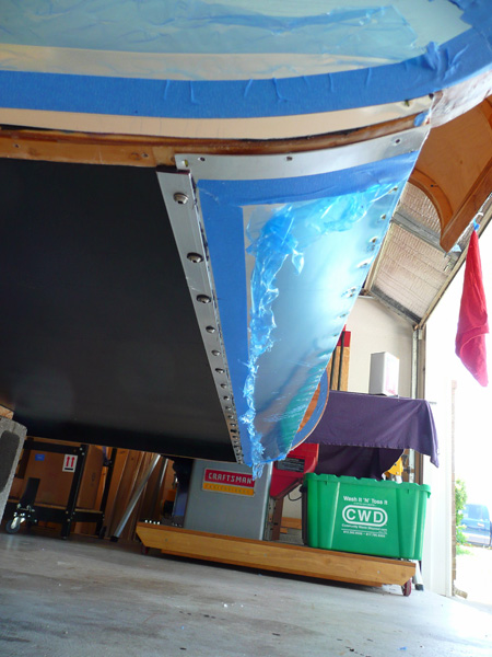

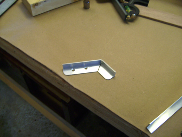

I made some rain diverters for below the hatch hinge out of 3/4" aluminum angle.
Then I started permanently installing the trim. I used 3M 4200 as a sealant under the trim.
First the rain diverters:

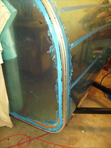

Then the front sections of RV edge trim:
Then the roof sections of the trim back to the galley hinge:
This weekend, I'm going to install the hatch trim and the trim along the bottom of the sidewall, and hopefully get my doors going.

I guess I like watching paint dry because those photos are good to see! When I did my roof trim, I just pushed mine slowly around the angle and used my knee to help shape it. I wish I had my dad's "bender" that he made. He does solar screens and uses it to bed the trim sweetly. I think your method is good though because your side overhang looks to hang over more than mine does.
I love the rain diverters. I need to epoxy my one poxy hatch corner to seal up that exposed area then make me some rain diverters too, I think driving in the rain opens up leaks more than sitting in the park where you can protect it. Thanks for reminding me!

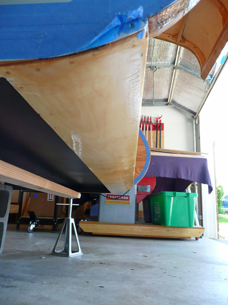

Since it couldn't be seen, I was going to paint the lower back roll pan (below the galley lid) black instead of skinning it with aluminum, but I knew it would be one of those things that bugged me if I didn't do it. So...
It is now in place. (I think I feel better.)

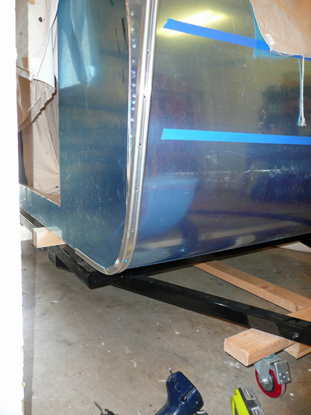

Then I finished all of the trim at the bottom of the teardrop sidewalls. (The heat must have been getting to me because I didn't get any pictures.)

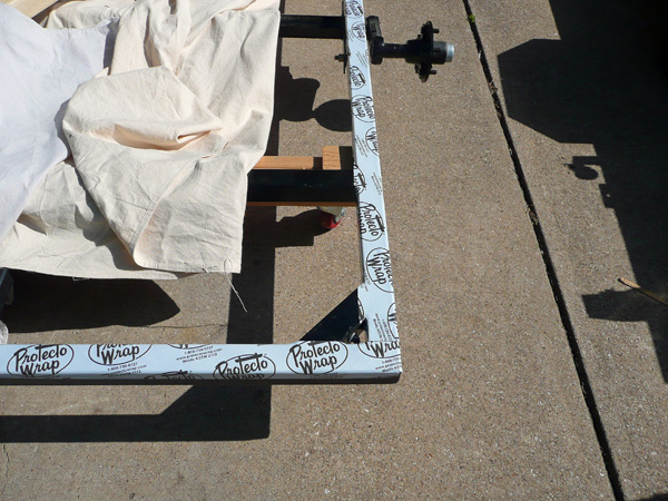

With the bottom trim done, I can now set the teardrop shell back on the frame. But before I did, I covered the top of the frame with window weathershield wrap. (I'll be using deck screws to attach the shell to the frame, and thought the wrap would help prevent any water intrusion.)
This stuff sticks like mad anyway, but with a black frame baking in the heat it almost welded itself to the frame. I then put the teadrop shell back on the frame. (It will be screwed down later.)
