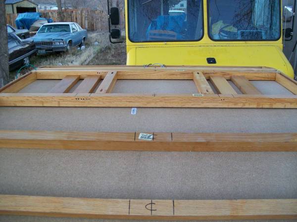

Postby down under tech » Sat Feb 12, 2011 10:21 pm
GuyIIFrye: I had already gone to HD early this morning before you posted on my question about luan or pressed hard board. Thanks for your suggestions. I went with the 1/8" press board.
Cliffmeister2000: Thanks for your suggestion, too. I started working on the TD before reading your reply. I am going to cover the press board anyway with the plastic faux tin panels on the ceiling.
Miriam: Thank you for your approval on my build so far. It is taking forever.
Sharon: It feels great to have the inner walls up and done with. Check my next post to see what I got accomplished today. They are calling for "SNOW" on Tuesday... Tomorrow I will return it to the storage unit so it will be cozy and dry.

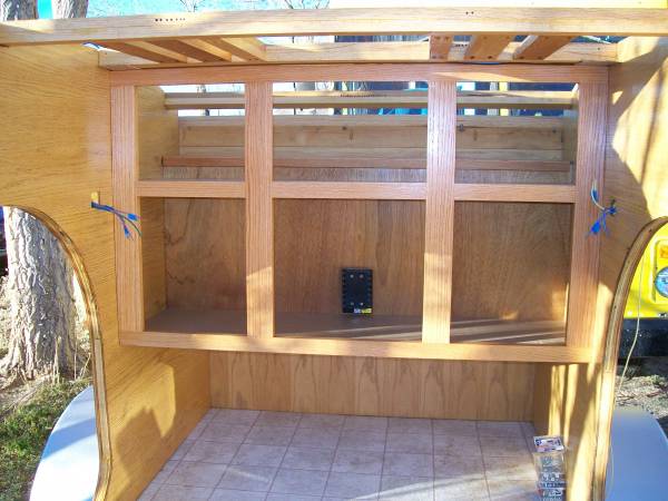

Postby down under tech » Sat Feb 12, 2011 10:39 pm
Today's update is a big one. I got up early and got to work on the "Silver Nugget". We have been having spring time weather here (63 degrees and sunny) and I can really go to town when it is warm outside.
I installed the cabin cabinets and the shelves.
I cut the press hard board inner ceiling pieces and fit them inside even though I was not ready to attach them because Mr. Sun went behind the mountains before I could attach them I had to make two of them because they weren't long enough for one piece to make it all the way from one end to the other. I will secure them at a later time.
Have a good Sunday and a very nice Valentines Day on Monday...:ilovecamp:

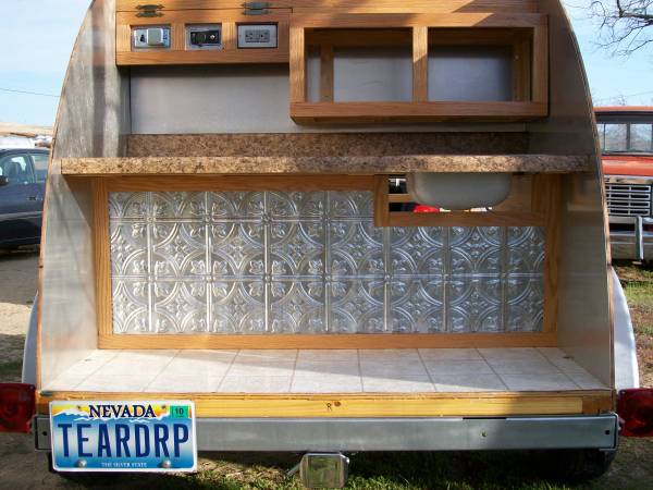

Update, 04-12-2011
Postby down under tech » Tue Apr 12, 2011 9:34 pm

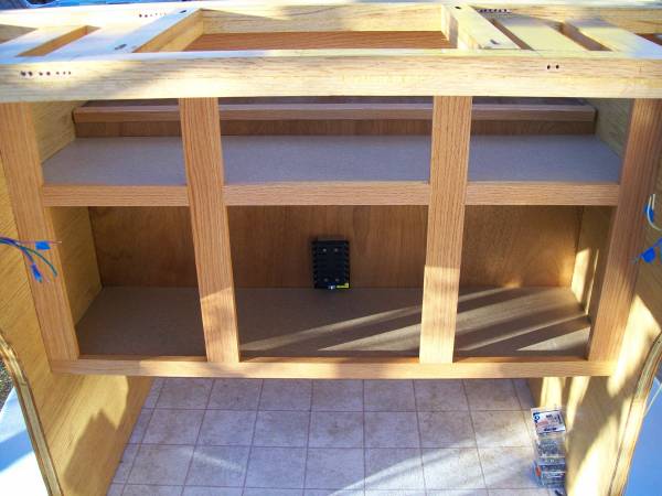

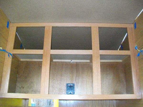

Today was spent working on the "Silver Nugget". I made up the dividers for the lower cabin cabinet and I got them installed. The center space will be open so I can place a small TV in there.
The part that really turned out looking exceptional is the section under the counter. I finally installed the faux tin ceiling panels trimmed in red oak. I really love that look. That jazzed up that area. What do you think?
I will see what I can get done tomorrow. They are calling for a chance of rain in the afternoon. I hope it will hold off so I can get a lot more done.

Postby Cliffmeister2000 » Tue Apr 12, 2011 9:48 pm
The faux tin looks great! I wonder how much will be visible when you are loaded up to go camping?
