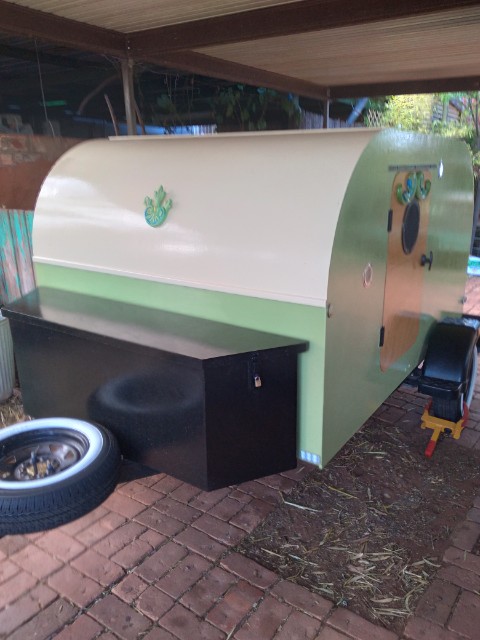

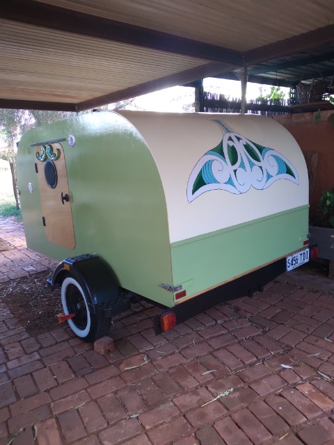

Postby MickinOz » Sun Nov 20, 2022 4:25 am
New Owner has personalised her camper.
1st outing to her daughter's birthday

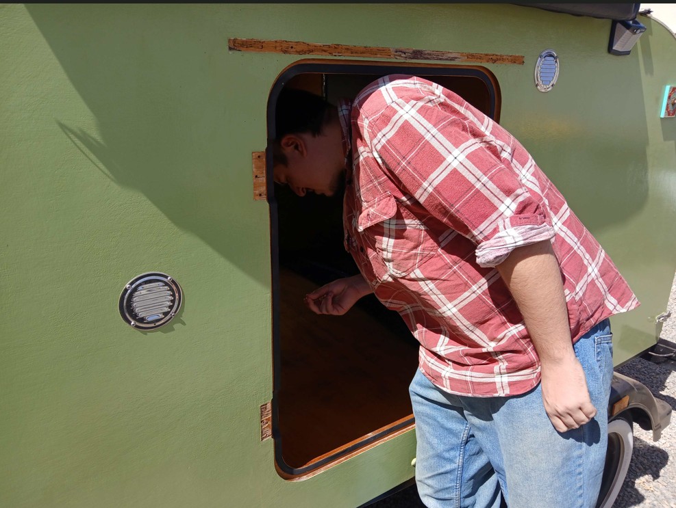

Postby MickinOz » Mon Mar 17, 2025 5:15 pm
The little trailer has come home for a visit.
The lady owner decided she'd like to splurge on Aussie Traveller doors.
I'm pleased to say my door cut outs accept the new doors perfectly.
#3 son and I cut the door jambs out yesterday. Rough cut with jigsaw, followed by trimmer bit in the router.
Trial fit was perfect.

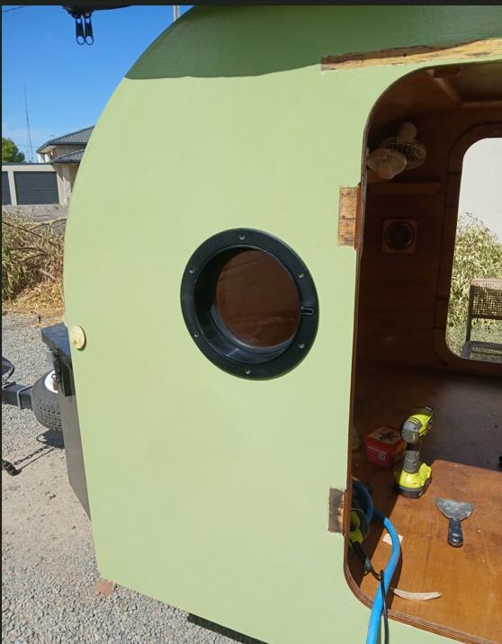

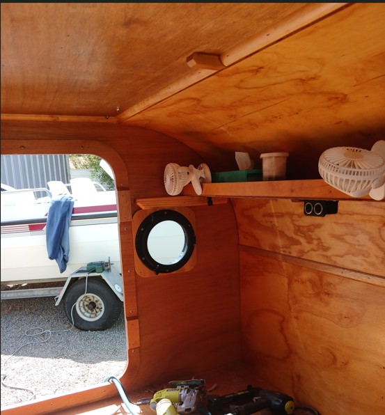

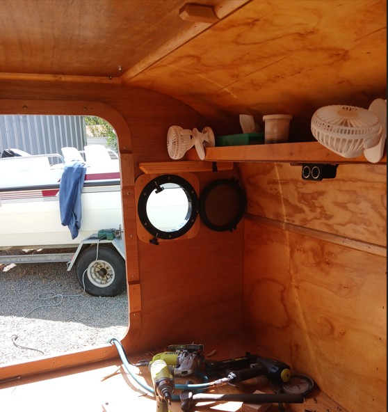

Postby MickinOz » Mon Mar 17, 2025 11:44 pm
Got one port hole transferred from the door to the cabin wall today.
It's just after 3 pm. Reckon I might get the other one done before I knock off for the day.

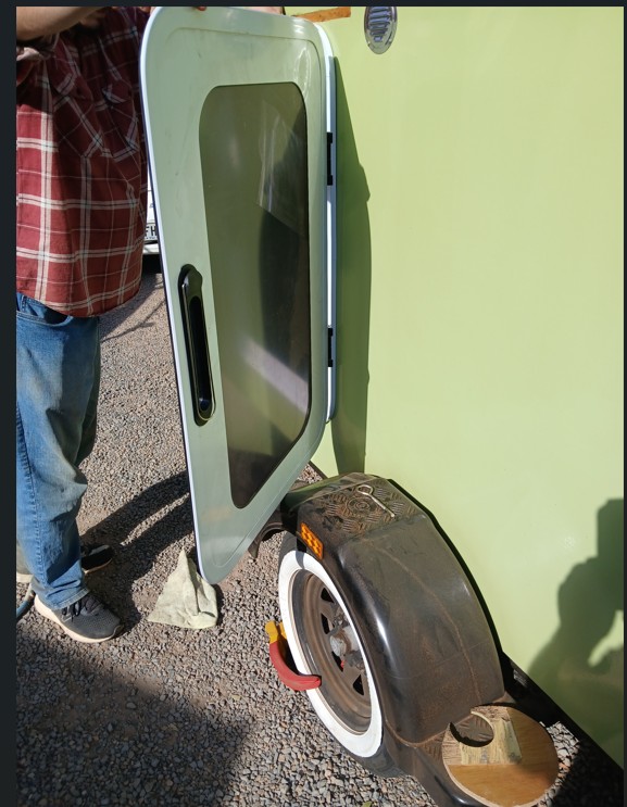

Postby MickinOz » Tue Mar 18, 2025 2:44 am
You know how they say no good deed goes unpunished?
Yep. I agreed to fit the lady's new doors for a very small sum considering the time it was likely to take.
Then they called and wanted the portholes taken out of the old doors and fitted to the trailer, to which I reluctantly agreed.
So, I've fitted one and made a start on the other.
Now, the husband has called and said he wants the doors fitted "suicide style".
i.e. with the hinges toward the rear so the doors open backwards.
This is so the glass door doesn't obstruct the view out of the port holes if they are lying in bed with the doors open.
I just sent them a picture of what will happen if the doors open backwards.
They will hit the mudguards. Pretty sure they would hit the tyre if there was no mudguard.
I find my mood somewhat deflated.
It's hard to do good work if you disagree with the goal of that work.

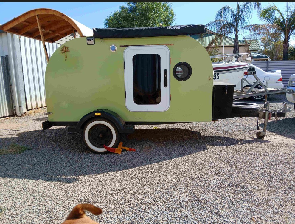

Postby MickinOz » Tue Mar 25, 2025 7:57 pm
Job done.
I took a while, and probably undercharged, but I do like to think it came out OK.

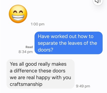

Postby MickinOz » Sat Mar 29, 2025 10:14 pm
The lady owner and her husband came over from Iron Knob to collect the trailer yesterday.
I showed them how the locks work but forgot to show them how to separate the glass door from the screen door.
They immediately set off for an overnighter in the Southern Flinders Ranges.
She brought a little pot of paint with her to do the touching up while they are camped.
She says she's happy with the work.
