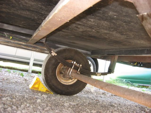

Just got it weighed so I can redo the springs. :? :shock: Came in at a whopping 1,680 pounds loaded...HEAVY... I know I kept saying 1,500 to 1,700 but I was hoping for lighter.... I am guessing the battery, air and CI at a couple of hundred... ;)

Postby Miriam C. » Thu Oct 21, 2010 6:28 pm
:oops: Seems some of the experienced folks said they looked like they were flattening out some. Now 3 years later they allow the camper to hit the floor enough to wear the tire....time for some new ones... :roll:

Postby Miriam C. » Thu Oct 28, 2010 1:52 pm
Not only were the springs flattened but one of the U-bolts had a crack. Mech. beefed them up too...
Postby Prem » Thu Oct 28, 2010 8:38 pm
:thumbsup: M, looks good. How much clearance now from the top of the tire to the trailer floor? Looks like 2.5".

Postby Miriam C. » Tue Nov 09, 2010 10:56 am
:lol: Prem, the tires are 8" but not jumbo. I got them from a farm supply and they are normal. I also have some airplane tires I might put back on. They will hold 3000 pounds... 8) :twisted:
Postby Prem » Tue Nov 09, 2010 12:22 pm
:thinking:
Not ST215/60-8D.
but the smallest? 4.80/4.00-8?

Postby Miriam C. » Tue Nov 09, 2010 2:17 pm
Nope didn't know about the bigger. I have 5.70/4.00 8". They are only rated at 910# so I am thinking of something rated higher. :thinking:
And thank you cause I am ordering some 215/60-8D Rated at 1100.. 8) The MO highway patrol can relax for another few years...no airplane tires... :lol: ;)

Postby Prem » Tue Nov 09, 2010 4:04 pm
Wider rims with the wider tires?
