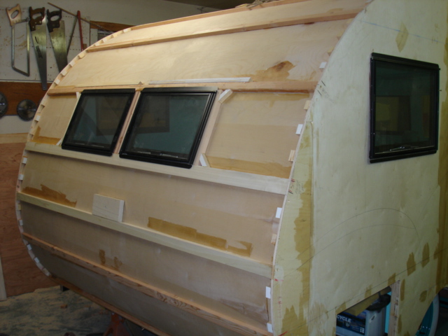

Here's the Sunday update...I bombed out with the hub cap thing...so the search continues. Picked up all the exterior roof skin, 1/8" luan. I know it's not necessary, but I get humongous pine cones that drop here and will dent the aluminum badly if I don't back it up with something.
I got the rear closed up and the windows cut in. Bed deck and mattress rail is done and painted. Most of the lights are backed up and mounted. Radiused all the corners on the windows and fit them all. I still need to do the interior corner trims and on the seams, as well as windows.

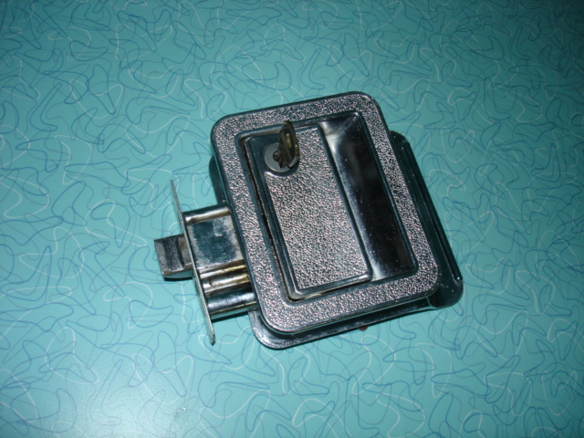

Went down to Steve E's on Saturday. He had picked up a free mid 80's slide in pop top camper that he's parting out. He really scored with it! He got a working 3 way fridge, furnace, lots of hardware and fittings, fuel tank, water tank, pump, yada yada yada...He was generous and gave me the paddle handle latch for the door! Woohoo! works slick, after some cleaning, fits down to a 1.25" thick door. Even had the key...I'm set. Big thanks Steve...I'll get you a case of your usual beverage! Doug

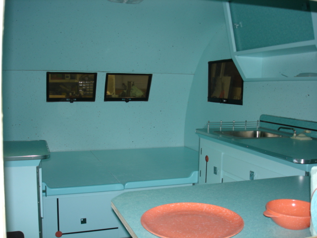

Postby Miriam C. » Sun Feb 21, 2010 8:14 pm
:o Oh so where did you get the orange/peachy dishes????

Thanks all....Auntie M...dishes were an E-bay deal that ended up with many of them broken in shipping...

Doug, What are you going to skin it with?

This one gets all aluminum, painted. I'm not into something that will be a high maintenance thing, ie polishing. I'm looking into getting the 3" break on the sides, but that's pricey and a days roundtrip to Hollister to pick it up. The guy at Cardo says he can roll or has 4" ones. I'm waiting till he gets in the table trim and I'll go down and have a chat with him on it. Doug

Postby Dean in Eureka, CA » Sun Feb 21, 2010 10:46 pm
Looking real good Doug!!! :thumbsup:
Did you radius the corners on the windows?... Kinda looks like they're radiused, but can't tell for sure, my eyes are kinda tired tonight.
