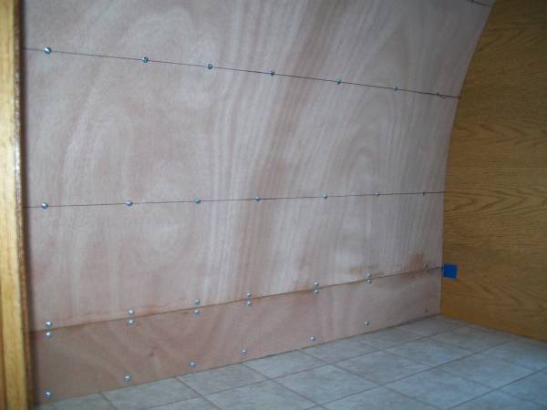

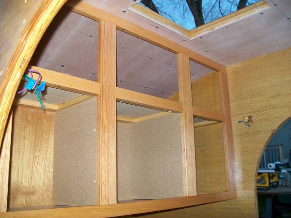

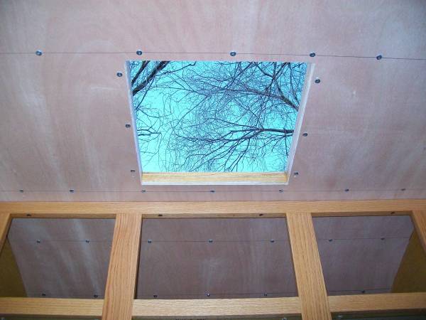

Hey You Guys: I was able to get some things done on the "Silver Nugget" over the last few days. The weather has been windy and rainy for the last week. I put in time as I could when the weather broke. I spent this afternoon on it. I now have the inner ceiling plywood/luan glued and screwed in place. I was going top use hard board/press board to apply to the inner ceiling but I am going to cover it with the tin celling panels like I used in the galley, under the counter. I think the construction adhesive will hold better to the wood grain than the glossy surface of the hard board. I cut out the vent opening with my laminate trim router. The face frame for the inside is now finally mounted permanently as well. This is one of those milestones that I am glad I have completed.
I will remove the screws after the PL premium dries in a few days. I had to use two pieces to cover the inside. You can see the small piece at the bottom front near the floor. The lines will be used later when the oil rubbed bronze tin celling panels go in.
The opening for the Fan-Tastic Vent Fan.
The red oak face frame is there to stay now. This TD is getting really solid now.

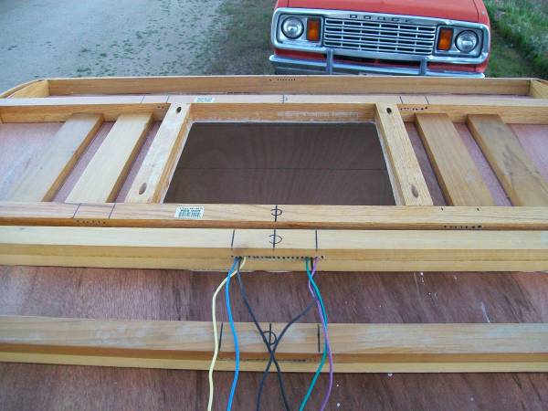

Next is the insulation and to run the wires through the spars and to their termination points. It looks like tomorrow's weather will be a good for "tear drop time" as well. I hope so !!!
