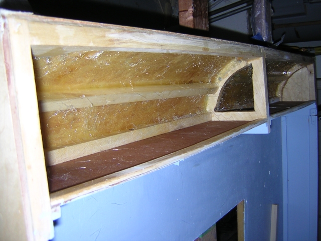

I'm still working on the trailer but it’s another boring part. I filled all the plywood seams on the outside of the lifting roof with epoxy filler and then applied fiberglass tape to the plywood seams. Once I had that done, I flipped the roof over so I could strengthen the eve. I couldn't get anything to make the sharp curve, so I applied fiberglass and epoxy laminate resin to its backside. When I bought the fiberglass sheeting, I had to choose between woven and not. I chose 'not'...bad choice. That stuff is messy; gets into and onto everything; and, after it is applied, it "attacks" the applier!
Word to any rookie, looking at this, choose woven! Below is a pic of the loose stuff, before clean-up. It seems to clean up okay and will probably look okay once it is painted. It definitely made the eve stronger.
I have fixed my Firestorm orbital sander again and have enough parts to fix it one more time. Hopefully, it will get me through the finishing of this trailer. Tried it and found that the sander sheets get caught on the fiberglass tape edges. So, I'm going to sand the edges down just a bit by hand and then try again. I bought a goggle/mask set for fiberglass and a Tyvek jumpsuit. I plan to put all that on and then hit all the fiberglass tape in one day....have to wait for a day when nothing is happening and the temperatures are not triple digit. Hopefully, the heat wave will end soon.

FYI, fiberglass mat is stronger than fiberglass cloth by thickness because of the random cross-lay of the strands. To clean it up, press down the strands sticking up, you can heavy plastic sheet/garbage bag sprayed with WD40 and apply pressure with a narrow foam roller. If you also use a narrow foam roller to apply epoxy to fiberglass mat it doesn't get all over the fabricator/applier, just the applicator. :R
That’s why I chose it but application was a bigger hassle than I expected.
Thanks for that. :thumbsup: Maybe I’ll add another layer of the stuff and try your tips.
What do you suggest be used to remove the WD-40 so the paint will stick afterwards? How do you know you have gotten that WD-40 oil off all the intricate edges?
It's there forever. Don't use it if you need to put anything over it, like paint, more epoxy, etc. It's only for the final layer of mat IF you don't have to finish it. I was thinking it was just hidden and only for strength, not for a final finish to be seen.
So what you do in a situation where you need to strengthen AND paint the area is:
1) Wet the wood with epoxy mixed with a little acetone for good penetration into the wood.
2) While the first coat is wet, lay on the fiberglass mat and roll to saturation with more epoxy mixed with a little acetone for fast penetration into the glass.
3) Lay on fiberglass cloth for the final coat and roll with thick epoxy. A second coat *may* be required to fully cover the weave.
4) WHEN FULLY HARDENED, wipe repeatedly with a rag saturated with acetone to remove the gummy amine layer that comes to the surface of cured epoxy. Wear a heavy rubber, dish-washing glove for this. Nitrile and Latex gloves disintegrate from acetone fumes.
5) Paint. (2-part epoxy paint is best. Always add a dash of acetone to get a good bond.)

Your instructions, above, will help anyone who is planning on fiberglass and paint. Those instructions are pretty much what I did, but without the acetone. I think I'm going to apply another layer of 'glass but first, I'm going to practice on a junk piece of ply, to test/try covering the epoxy and fiberglass with waxed paper or other such product before I press/smooth it down. I want to see if that will work or if it helps at all. :thinking:

I've had epoxy actually stick to waxed paper, but give it a test. Any acetone in the resin will mess up the waxed paper. Experiment with pulling the waxed paper before the resin completely hardens and after the resin hardens. See which works.
I've tried heavy plastic sheet also. Even without acetone in the resin, the plastic stuck to the hardened resin. Proof positive that epoxy resin really is the ultimate glue.
I originally used petroleum jelly. What a mess. Diesel fuel was going to be too nasty (although it works well as a release agent on MDO plywood for concrete wall work), so WD40 was the more convenient compromise.
