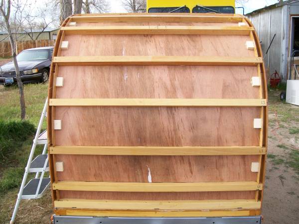

I got the insulation for the roof today. I found out that I forgot to add the blocking to the edges by the roof to support the ceiling at the sides between the spars by the walls. The Kuffel Creek plans said to do this. I glued them in place with PL premium. I guess the insulation can wait until tomorrow.

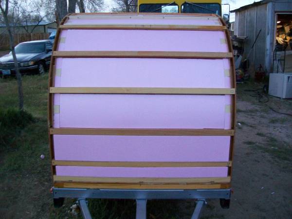

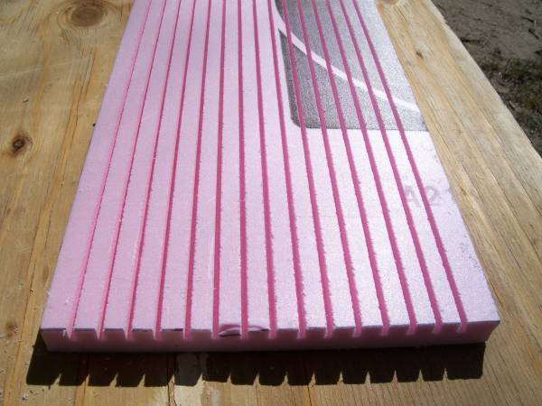

I spent today working on the TD. I installed the first of two layers of 3/4" insulation in the roof. I cut it out on my table saw and I made curf cuts about half way through the insulation so it would easily bend to form to the contour of the Cubby profile. I need to put in the wiring through the spars before I put the second layer of insulation in. That is what I plan on doing on Tuesday after work if the weather cooperates.

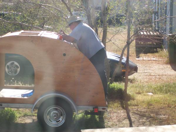

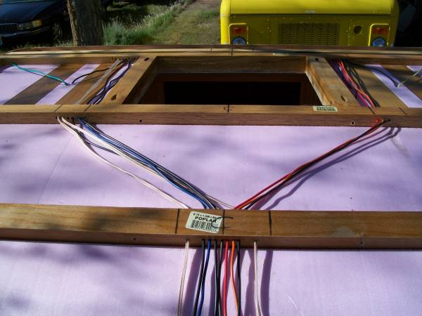

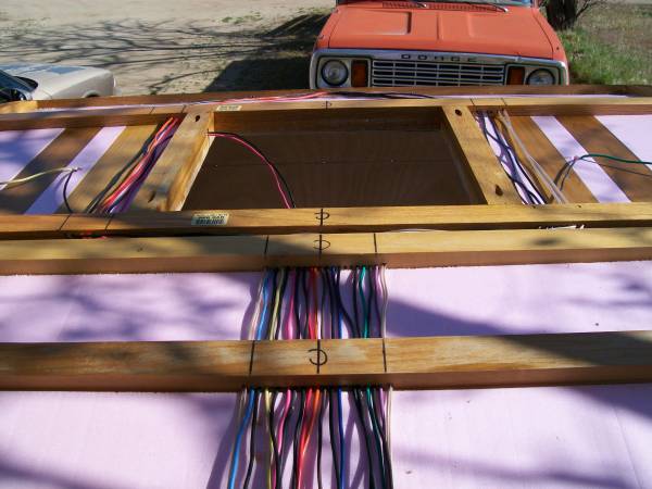

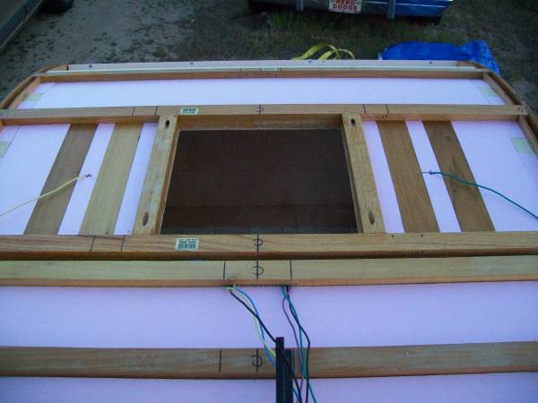

OK, I finished running the needed wires through the spars yesterday & today. I made up a wire schematic that I will keep inside the TD when it is finished for future reference if needed. I realized that I have one more circuit to run. It is for the water pump for the sink. That is no problem because it will run under the counter and I can do it when I need to wire up the pump.
My better half took this picture of me yesterday through the kitchen window when I started to run the first wires. I was wearing the hat because the other day while I was doing the insulation, I got a sun burn right where I part my hair. This gave me a chance to recuperate.

Postby LDK » Wed May 04, 2011 9:31 pm
Hey Johnny
I just noticed that you're running your wiring over the insulation. :thinking: I may try that. Are you planning on putting more insulation over your wires? I'm about at the wiring stage myself now. I drilled a 1/2" hole through my spars about 10" from the edge for running my wiring. I'm just going with 4 circuits with 12 gage stranded wire. I'm also gonna have a tongue mounted battery with my fuse block in the front cabin cabinet. I'm running 10 gage wire from the battery to the fuse block. I think I'm just gonna use 15amp fuses for the 12gage wires and 25amp fuse for the 10 gage wire. I don't want those wires to get warm at all. :lol:

Larry: I placed the holes in the middle of the doubled up spars so I can run a layer of 3/4" insulation under and on top of the wires. I might need to cut a slight trough in the top layer so the wires won't be pinched by the upper insulation. I will hot glue them between the spars so they don't come in contact with each other and rub through the wires coverings of the one next to each other.
10 Gauge from the battery to the fuse block is just right. Just be sure you use a grounding buss bar (one common ground block) and use 10 gauge wire from it back to your battery. You should use a 30 amp circuit breaker coming from the battery positive before you continue it to the fuse block. This is common procedure that way if you draw too much power it will trip and shut off current to the fuse block and if the wire rubs through against the frame, it will keep you from going up in smoke. 14 gauge wire & 15 amp fuses for each circuit is very acceptable for each of the circuits from the fuse block. The fuse(s) will blow if you have a short in one of those circuits. I know this because I am an ASE Certified Master Auto Technician with 35 years in the field.

Postby DMcCam » Thu May 05, 2011 10:21 am
Hey Johnny, thanks again for the electrical wisdom. I hope to be using it soon. :D Looks like our weather is finally going to cooperate with our teardrop builds.
I've had hot glue melt and fail on me in our summer heat. You must be using a higher temp version? Or do you think that the insulation will protect it enough inside the roof?
