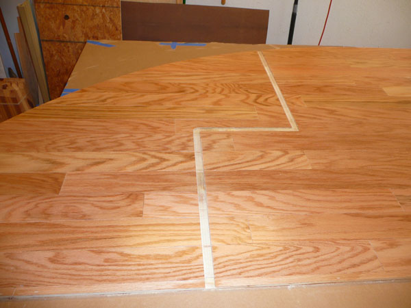

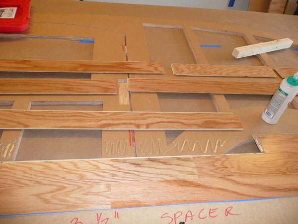

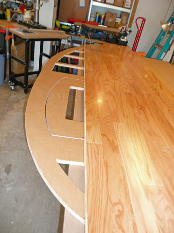

Since I love woodworking but don't like finishing wood, I thought I'd try something different on the interior. I'm using 5/16" engineered flooring - the multi-layer wood veneer product not the laminate fiberboard type. It is attached to my plywood "frame" by stapling the tabs and gluing the flooring with polyurethane glue. The edges are glued with Titebond III. The flooring sat in my garage for almost 3 months so the moisture content should be the same plywood frame. Here are some pics:

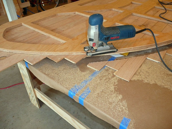

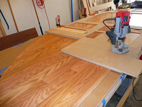

After the glue has a chance to set, I'll use my jigsaw to rough cut the flooring edges and cut out the door and then I'll use my router with a template bit to finish the edges to the profile and opening.

Postby Anthony J Grant » Wed Apr 22, 2009 5:16 am
Love the look of the wood :thumbsup: Ive been considering using it for the countertops, Keep up the good work. :applause:

Postby bbarry » Wed Apr 22, 2009 6:18 am
Now that's a unique approach! :thumbsup: :thumbsup: How thick will your final wall be?
Congrats on getting going again. You'll get a second wind when you get the walls up and see it starting to come together...I promise!

Postby aggie79 » Wed Apr 22, 2009 9:01 am
Anthony J Grant wrote:Love the look of the wood :thumbsup: Ive been considering using it for the countertops, Keep up the good work. :applause:
Thanks Tony. We too like the wood look. I'm hoping this may be a viable alternative to using hardwood ply on the interior. I caught the flooring on sale at the blue box, and stacked a 10% coupon that I got from the post office, so the total cost won't be much more than the hardwood ply plus cost of stain and varnish or poly.
bbarry wrote:How thick will your final wall be?
Brad
Thanks for the encouragement Brad! :applause:
Our wall section is 5/16" flooring + 3/4" plywood (actually MDO plywood) + 4mm Baltic Birch Ply + .040 aluminum. To many units of measure and decimals for me, but that would make the wall around 1 3/8" thick if my calcs are about right. (The 3/4" MDO is just "framing." I am using Grant's method of insulated wall construction.)

Postby aggie79 » Sat May 30, 2009 8:52 pm
:applause: Finally, after a job change, vacation, honey-dos, etc., I finally got a little more teardrop time.

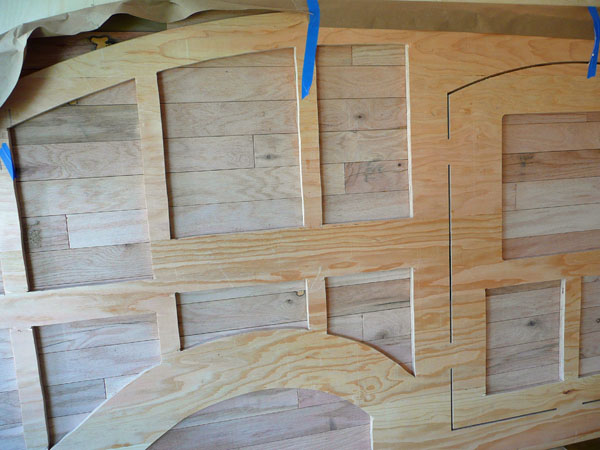

I finished applying the engineered flooring to the plywood sidewall "frame." This is a picture of the flooring from the back side (street side.)
I let the flooring run "wild" then trimmed to the profile with a jig saw followed by a router with a template bit.

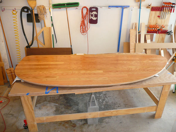

Here is one completed interior wall. (Both sidewalls are complete.)
:thumbsup: October and LCG IV are coming. I've got to get moving along!
