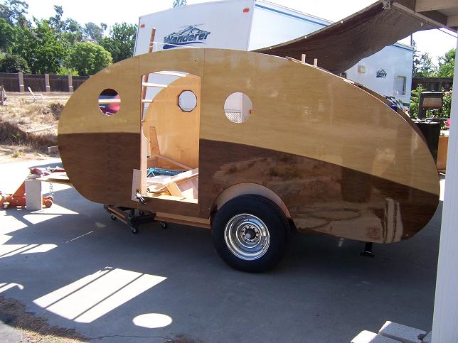

Your tear is going to be beautiful! :thumbsup: I'm surprised at the triple digits in San Diego. I wouldn't expect that, with the ocean breezes and all.... I guess we've all been suffering through the heat this summer.

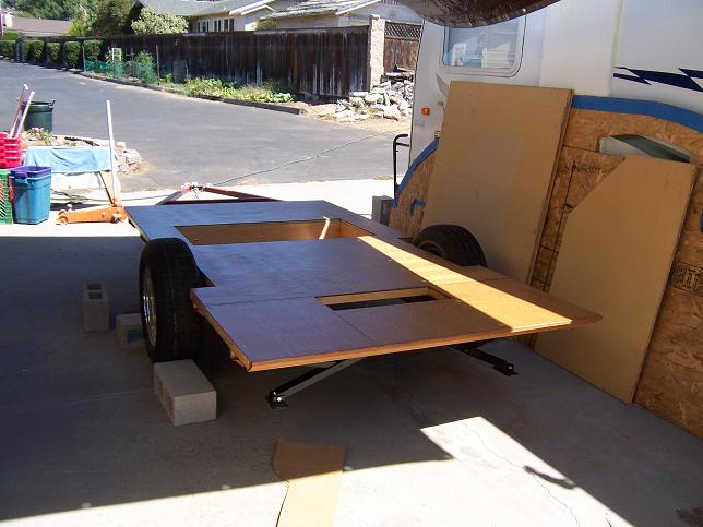

Postby kennyrayandersen » Sun Aug 30, 2009 6:21 pm
Nice progress – I like the windows too – what are you going to fill the holes with?

Postby Wolfgang92025 » Sun Aug 30, 2009 11:04 pm
Kenny,
Bought some 1/4" rubber molding from JC Whittney. Plan on using tinted 1/4" poly carb sheeting for windows. Won't buy that until I have the windows for the doors. Want to try to match the tinting.

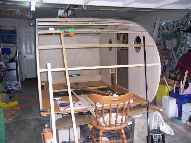

Spend a lot of time in the garage last weekend.
Finished building the spars and routing out the pockets for them to fit into the sides.
Next started to work on the inside fender wells.
Started to think about possible galley layout.
Monday took everything apart and started to sand. Got a couple coats of CEPS on one side today. This will take a while since my brother is doing to do a surprise visit on my mom.

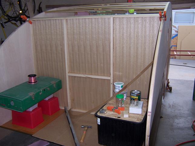

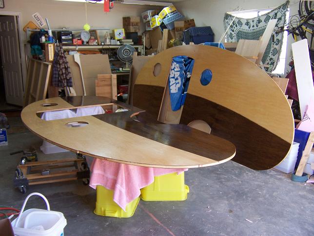

Postby Wolfgang92025 » Sun Sep 20, 2009 2:41 pm
Update,
Had my brother visit from the Detroit area last weekend for 4 days. :) :)

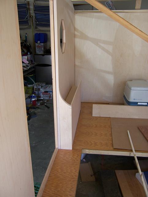

Spend a couple days working on the tear while he was here. It was good to spend time with him. Finally got the floor mounded to the frame. Also installed the foot well permanently.
Feels like I have been painting the sides for the last month. 2 coats of CEPS and 2 coats of spar varnish inside and out.
Only two things I would have done differently.
Apply CEPS to both sides and edges before moving on to the varnish.
The other is stir the can of varnish. I bought a gallon of semi-gloss, and after I put on the first coat, it had a gloss finish. I took a while for me to realize I forgot to stir the varnish. When I did, could see the anti-gloss pigment had settled about an inch deep in the bottom of the can. One good thing is I decided to paint the outside in gloss after all. It makes the grain of the wood pop a lot more. I think I will still go semigloss on the inside. :thinking:
What do most of you have for inside finish?
I'm thinking the gloss would reflect the lights to much?
Now I have to wait for the CEPS to try and 2 more coats of varnish.
If things go well next weekend the sides go on the the fun part of making sawdust starts again.

Postby Wolfgang92025 » Tue Sep 22, 2009 12:25 am
Burke,
As it turn out, it is only one stain on the the lower half (walnut)of the tear. The top half is maple and the color is 2 coats of CEPS and 2 coats of varnish on natural wood. The finish made the walnut lighter from dark brown to what I think of as a medium dark brown. The maple became more yellow and a little darker. I made a punch of different samples before the staining/finishing the sides. It can be surprising how much the color can change just by adding finish.

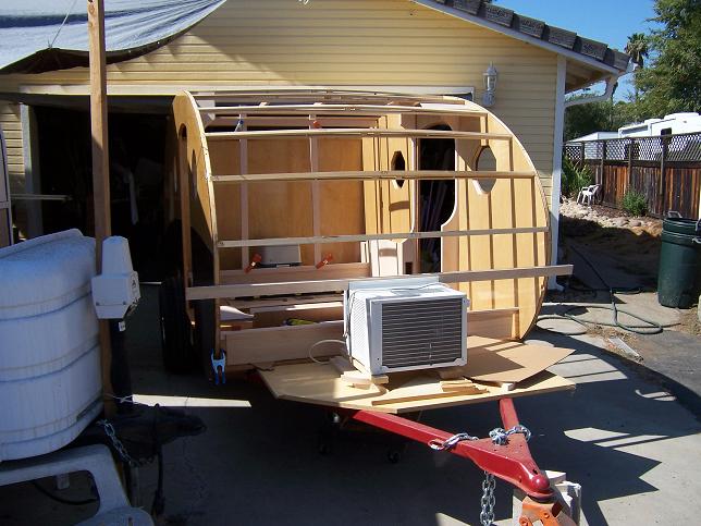

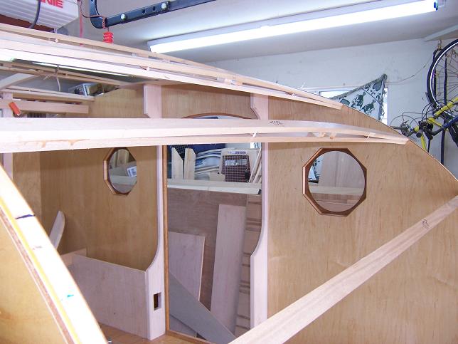

Postby Wolfgang92025 » Sun Oct 11, 2009 8:41 pm
My brother wanted some more pic's............
Sound familiar ?
Aside from more varnish, got the side mounted permanently to the frame.
Installed all but one spar.
And set the AC where I think I want it. Somehow it never looks quite the same as when you draw it out.
Oh yea, also got a couple of coats of CPES on the inside roof panels.
