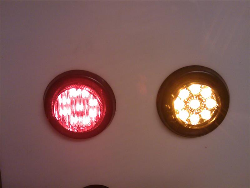

I came across these LED stop and signal lights at Harbor F. they work great and also unexpensives... :D

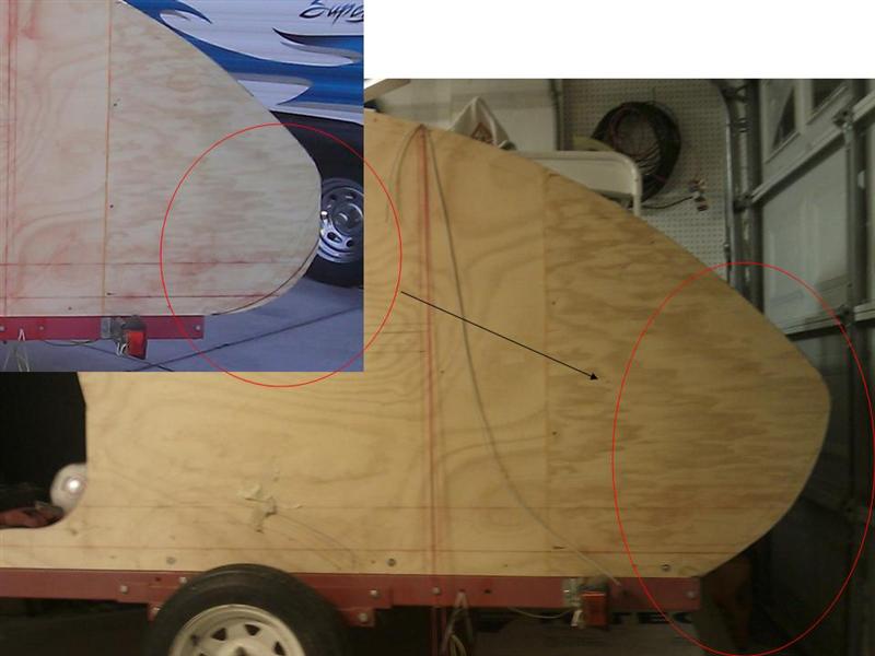

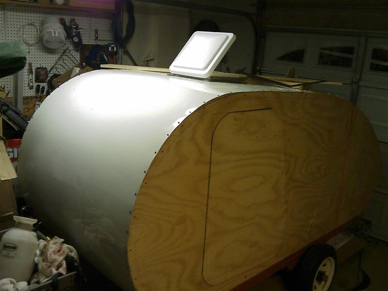

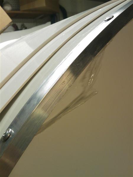

Postby Rusty drop » Tue Sep 14, 2010 6:25 pm
The saga continues,, here are some of the new photos of updates on the Rusty-drop construction,,, boy, these is getting tuff to finish.. :?
sorry,, I had to steal some ideas.. :oops:
ok,,, not so many but I will put more tomorrow.. the aluminum trim is kicking my butt... :cry:

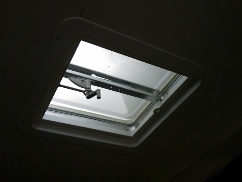

Postby Rusty drop » Thu Sep 16, 2010 1:10 pm
I got a lot to do,, I just received the two windows, a small cargo door for the tongue compartment, a larger cargo door for.... that's a surprice, I cant tell you yet,, stop light, got to finish the doors, get battery,, etc, etc.. but I'm very excited on how everything is coming along..

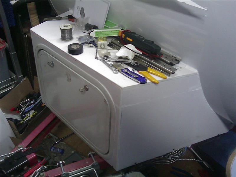

Postby Rusty drop » Fri Sep 24, 2010 12:14 pm
Well, I hope everybody feels the same way about "borrowing" ideas :)

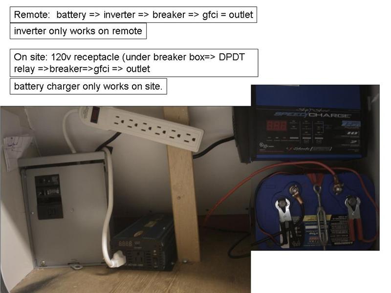

anyways, this is what I did the in the past days.
I finally received the small cargo door and right away built this small tongue box. (excuse the mess, I was just done)
In it, I installed the charger, gel battery, inverter , breaker/gfci box and inlet/outlet for electricity..
Inside the box there is also a DPDT (Double pole Double throw) relay that will automatically will switch between electricity from the battery/inverter to site electricity as soon as the cord gets connected. this will save me from switching them on or off manually.
it was a little nerv wreaking to wire it, since I am no profecional, but luckly everything went as planned. now I just have to run the wires to the cabin and galley.
