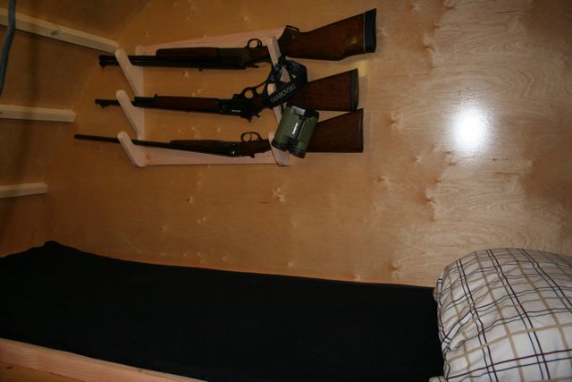

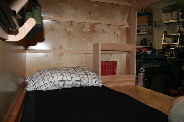

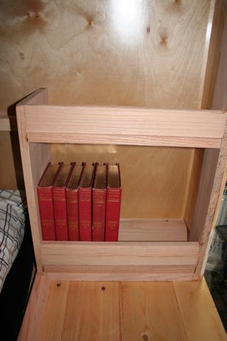

Another day and a little more done. I sanded the exterior again with the DA sander and did another coat on the Bondo. Then I built a curb to hold the cot in place. I also made a book shelf, I can't go anywhere without my books. Then I put some of my gear in to see how it was going to work and to check things out for the wood stove.
Looking in the door:
Looking forward:
Gibon looks good on the shelf, I'll add Plutarch and the Burton edition of 1001 Nights and I'll be set:

Love the gun rack, and the bookshelf. What a rockin' buggy. Keep it goin, bro.

I really like the bookshelf
Postby Alfred » Wed Dec 16, 2009 7:48 am
I really like the bookshelf, too...
