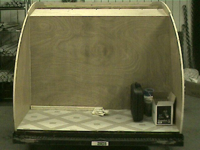

Here is a shot of the galley area, it's 58" wide x 30-1/2" deep.

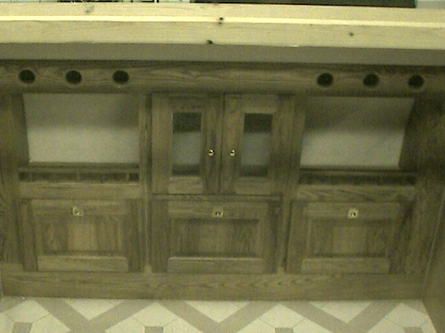

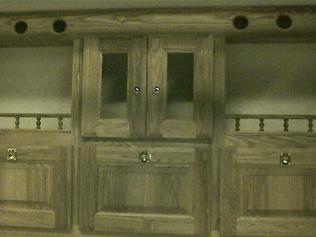

Here are a couple of shots of the front cabinets, The 3 doors at the bottom are hinged at the bottom so the mattress doesn't interfere with opening them. the upper doors have 1/4" plexiglass in them i didn't want real glass for the reason i think everyone knows? and the 2 shelves on each side are for drinks, cellphones etc...
I didn't take a pic of them but above the shelves on the inside walls are 2 12-volt outlets located at the top for charging cellphones or plugging in laptops etc..
ImageThe holes at the top of the cabinets are for the a/c, I ran pvc underneath the cabinets and up the sides to the vents and they have black mesh behind them. The pvc piping goes out at the bottom left of the camper and will connect to a petcool unit later on.

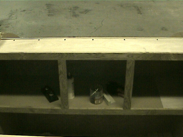

ImageThis is a pic of the back interior cabinets, each side is 22" wide x 16" deep and the center section is for the 15" lcd t.v. which will be mounted the the door and recessed to be flush with the finished frame.

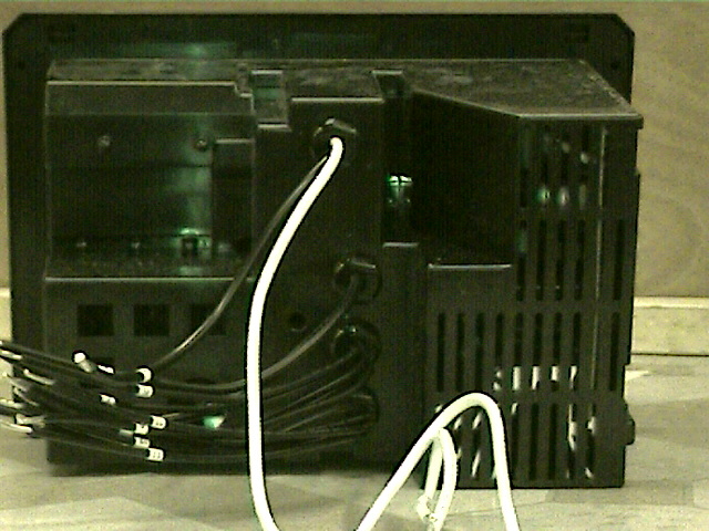

Behind the t.v. is where i'm going to put the a/c-d/c power unit i purchased from frank bear along with lights, doors latches etc....
I'll alos be building a drawer that is the width of the inside about 5" deep.

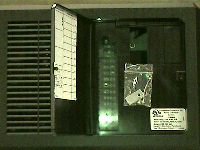

Image These are pics of the power unit, it has 10 slots for d/c fuses and is capable of having 45 amps put thru it. NICE!!!!!!! and looks fairly simple to wire also.

Love the power unit... :lol:
Once I found the right breakers, the thing works great. The breakers aren't special, but they weren't easy to find around dallas,tx. Ace hardware were the only folks that carried them and it would seem there are only a few ace hd stores left around here.
I'm sure some other types would have worked, the guy I got mine from said the type to use and that's what I got.
Keep going, your build is looking great.

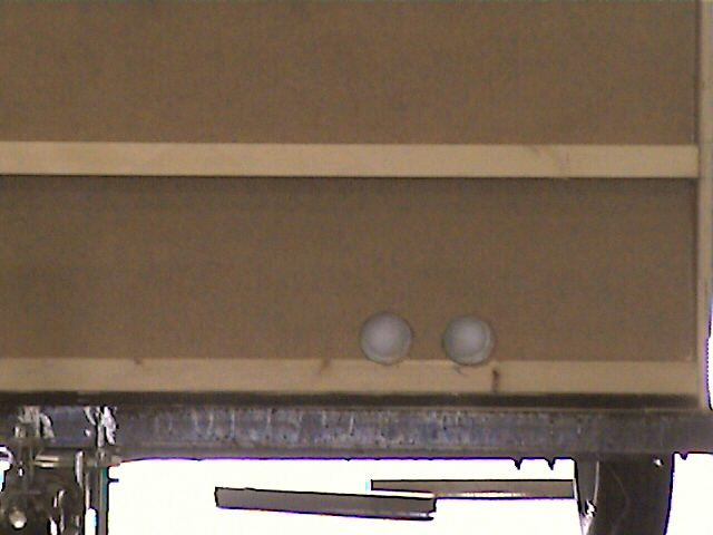

This is my power/converter unit installed, it will hidden by the upper galley cabinets and vented both inside and out underneath the cabinet.

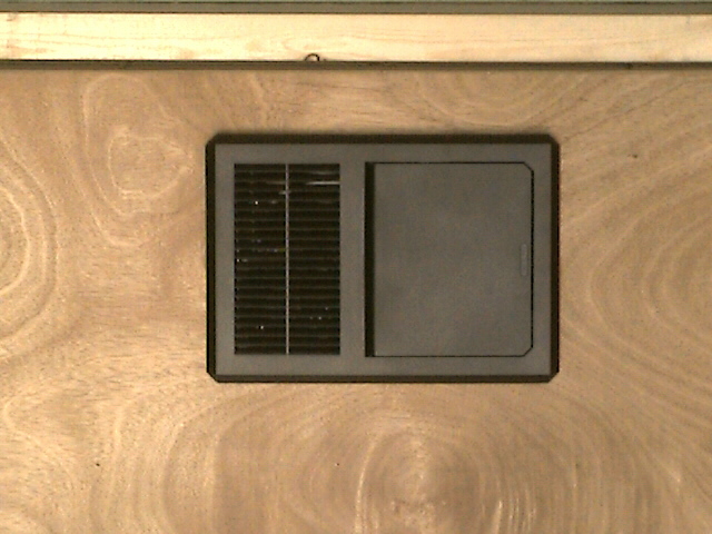

I got this idea from Dan Sutton and it's my a/c hookup. / WOOO HOOO!!!!
Cool Air coming sooooooon!!!!!!!!!

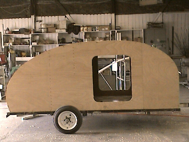

And here is a side shot of my new profile, this time i didn't curve the bottom front like the first one and i'll be building a tongue box to fit in front.
