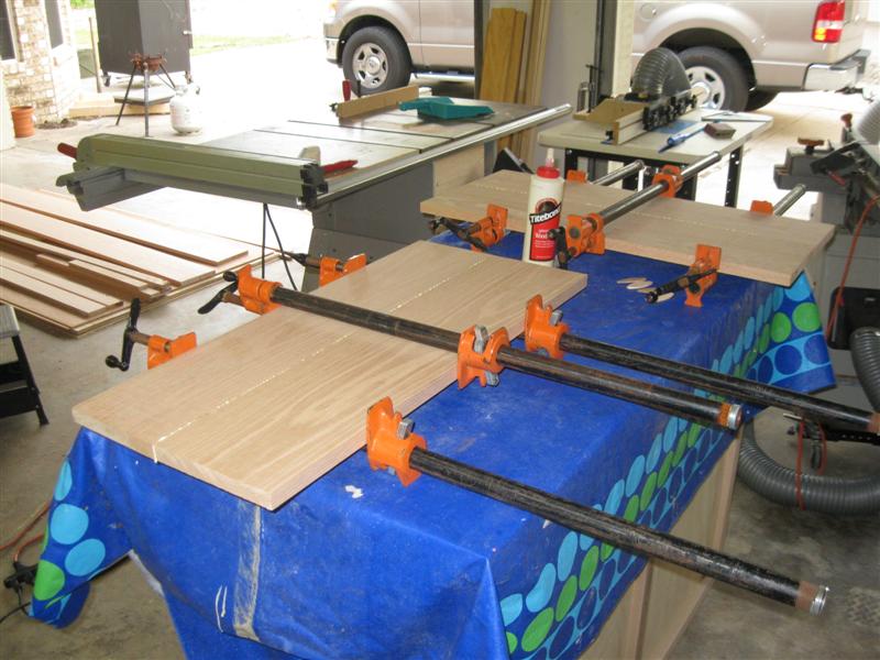

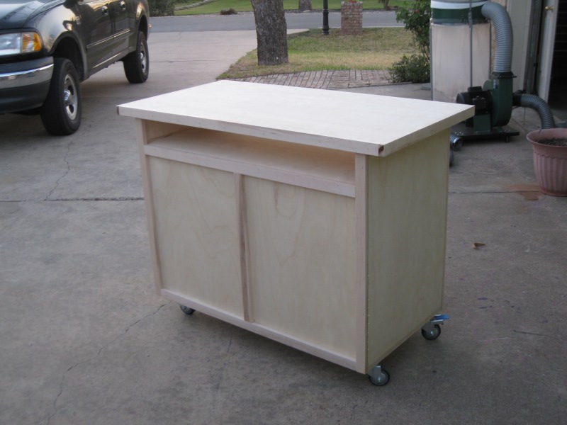

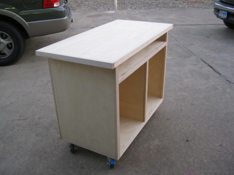

Building a work bench today, I got a wild hair. Soon y'all will realize I have a warped sense of humor. I couldn't keep from keeping it simple. I had a flashback of my mullet days.
Here we are working... Business in the front
Here we are getting ready for drinks.... Party in the back
I will be building the doors and drawers while building them for teardrop... 8) 8)

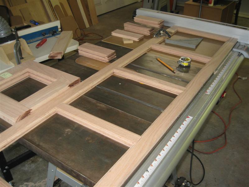

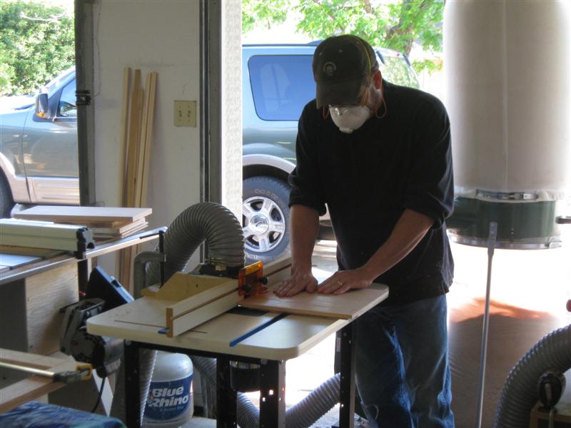

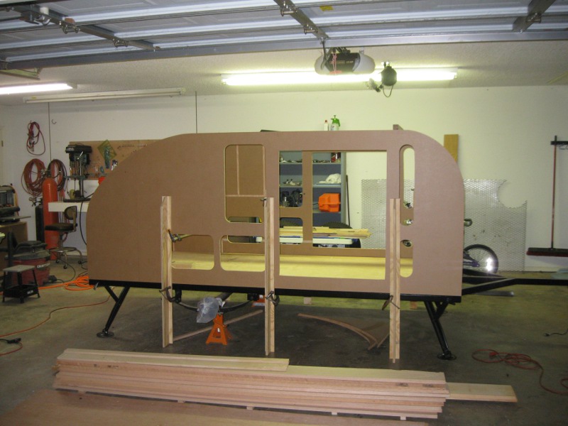

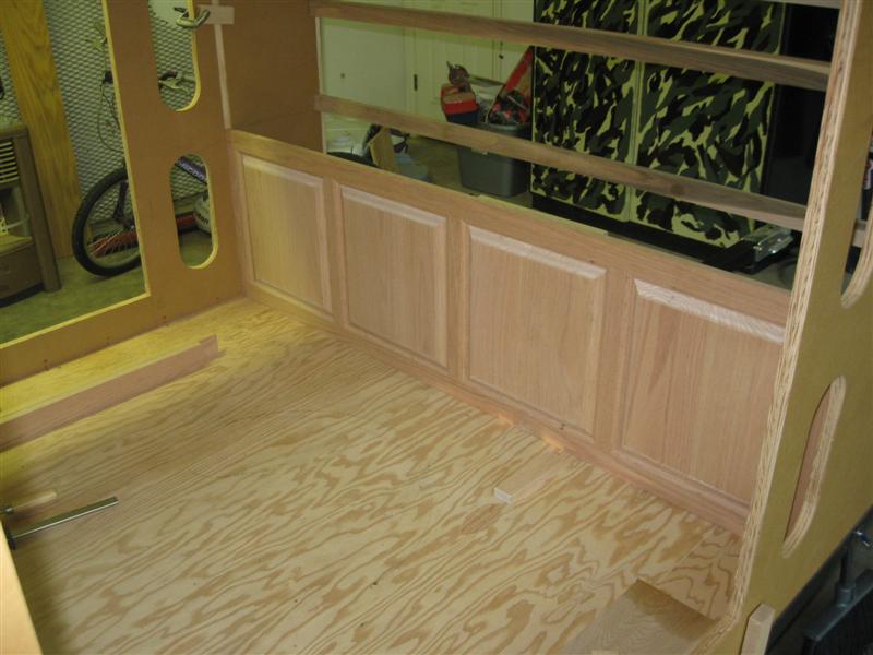

Starting to mill the rails and stiles for the cabinet work and built some jigs to hold the sides up.

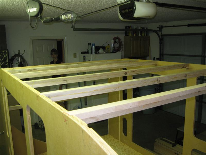

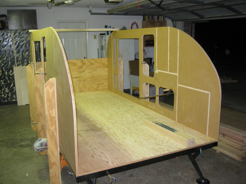

Postby aggie79 » Mon Apr 04, 2011 9:48 am
Kevin,
Your teardrop is really coming along. It's a great feeling to get the walls stood up, isn't it!

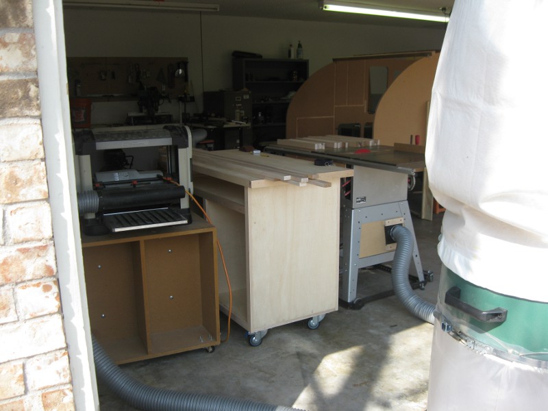

BTW, I like your mobile workbench/bar. I also spied your new HF dust collector in the background. After my teardrop is finished, I am going to re-do our 2-car garage, so it will work better as a part-time shop. Part of that is building mobile bases for my bench tools and coming up with a dust collection system of some sort. I like your workbench design and may borrow it.
Take care,

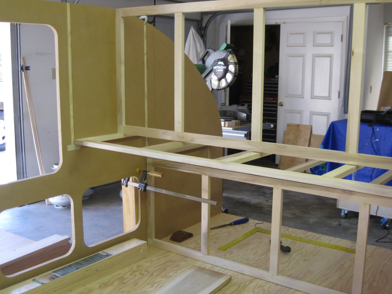

Postby kevingb » Wed Apr 06, 2011 7:48 am

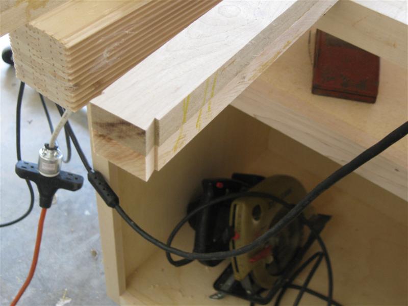

Tom... This is were its getting fun. Seeing walls up really helps the momentum. The workbench has been a positive addition to the family. I just can't wait to get the drawers in. I"m going to keep all my hand power tools, nail guns, blades, router bits, and brads. I also put a gang box on it to cutdown on number of extension cords. I decided to leave the top compartment open good place to put pieces while building.
I usually dont get very excited about Harbor Freight but the Dust Collector was a awesome buy. I did a ton of reasearch, just google HF Dust Collector Mods or HF Dust Collector Hod Rod. Right now I just pull it outside. With the bag filter you can see a fine dust coming off it. So the Wynn filter will be the first upgrade.

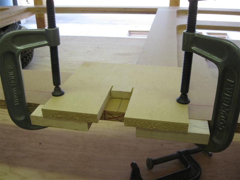

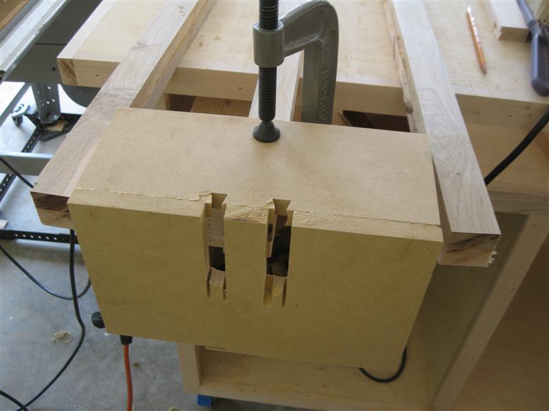

Well today was fun I added some dovetails maybe a little overkill but hey having fun is the main objective of building a teardrop

Postby TBuilder » Sun Apr 10, 2011 6:39 am
That's pretty cool! I'd wondered why more people didn't do that.

Postby kevingb » Sun Apr 10, 2011 9:25 am
TBuilder from other non-teardrop building experiences. If I was not using MDO plywood I wouldn't even think about doing this. Basically if the receipt for the plywood has 800 number for survey and chance to win $5000 gift card don't do it.
