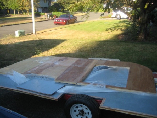

Received the window of ebay (42*26)

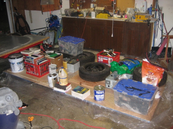

Closed a wall using laminating epoxy and PL foam glue and applied weight with whatever heavy stuff on hand:
Then cut out openings and applied CPES (stinky !):
Finished wall:

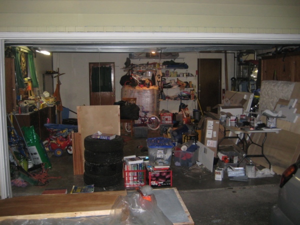

Messy garage .. gotta clean it up before the wife comes back !

@Cliffmeister2000 : When I posted the pic I had the same thought ... had to go double check ... the pic angle make it look that way, but no, it's not shorter (overhangs the same length at the other end), the radius and pic angle are deceiving.

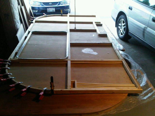

Continued working on wall #2
Cut openings and insulated:
Can you find my 3 years old in the picture ? (Hint: "caged") :)
Then closed the wall (epoxy/foam glue) and applied weight:
And applied stinky CPES to outer skin:
Painted the inside of the walls too, and added a last coat of epoxy paint on the floor.
Next steps are sanding the wall bottom, and dry fitting them to the floor.
Then I'll apply a bunch more CPES to trailer floor edge and walls bottom.
