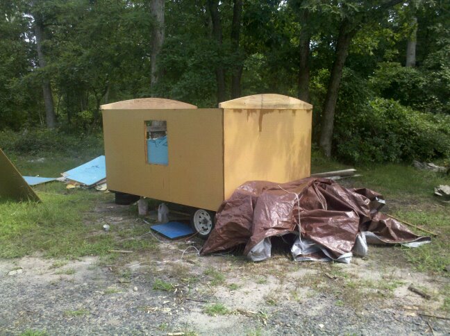

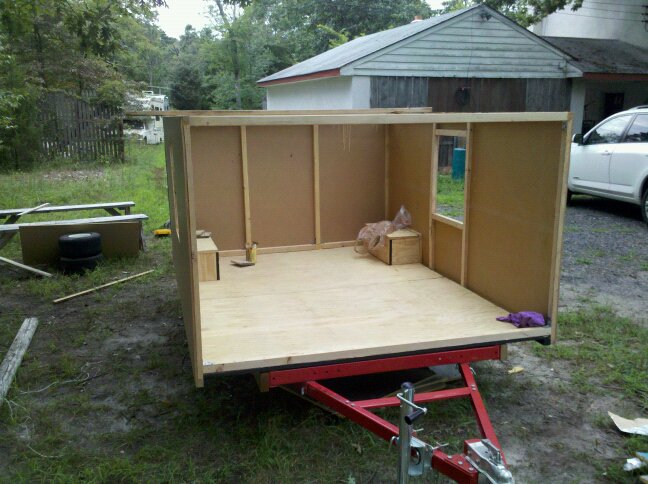

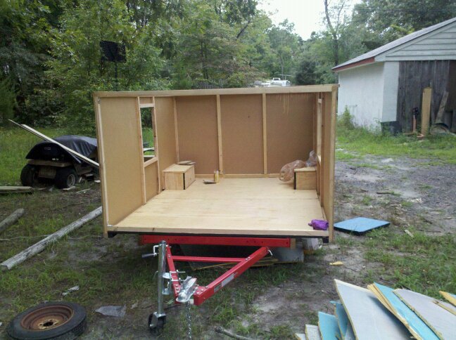

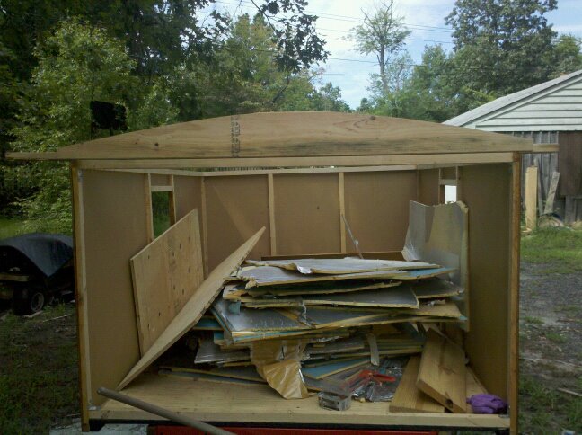

Well the forcast was bad for camping...so I went down to work on the vardo. Image Image Image
I was raceing a weather front so didnt take much pictures. Its looking real boxy now, probably wont get the arches cut next weekend, although I really want to...will see.
I got the door made, 28" wide by 39.75" tall, insulated it while building it. Hopefully next weekend the door will be in and the last outer wall done. The mdo plywood looks like cardboard in the pics lol. I did get to epoxy the edges yesterday but cant wait till the roof is done and its all painted and protected from the elements.

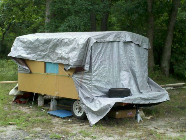

Postby Deryk the Pirate » Sun Aug 14, 2011 9:53 pm
Well got 1 short day of work done before the rain came and killed the weekend. I also saw 2 of my friends in a local production of Cinderella saturday nite...was nice to get out for a night!

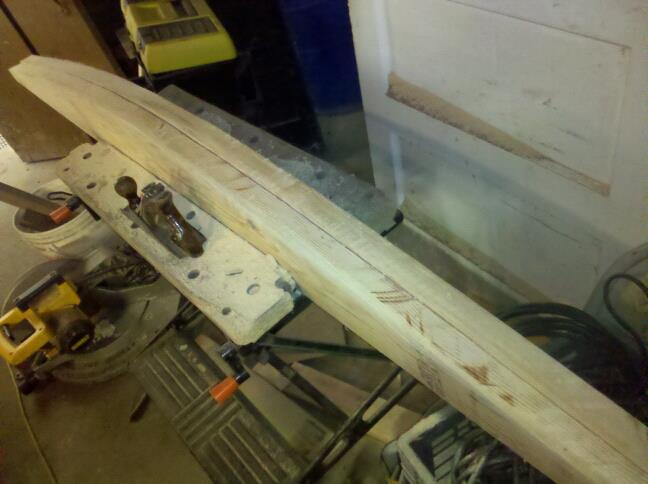

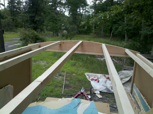

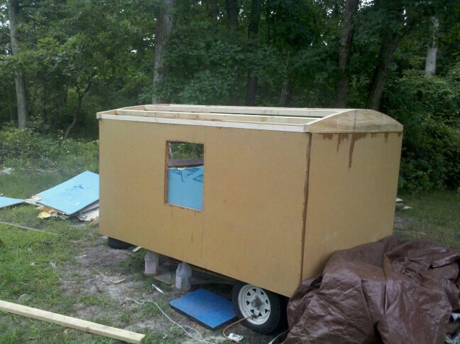

My friend Connor was at Pennsic, so I got to cut and plane and sand the arches myself. Wasnt so bad till I think I killed his old belt sander...guess I will be buyin him a new one...lasted about 3 minutes till it started smoking lol.
Image I ended up triming an inch off each side, was just too wide for what I wanted.
Image Lookin less boxy, more "vardo'ish" lol
Image Image The purlins are 2x4's cut in half screwed and glued. I added 1 on each side on my side walls screwed and glued in place, so it should help hold the roof down. There is about a dozen 4" screws and titebond 2 holdin each arch in place.
Image All closed up to protect it from the monsoon we got all day sunday...sigh
Hopefully I will have the plywood roof on next weekend, and whichever way I decide to go metal or epdm by the end of the month. Im a bit torn, might do the metal roof, a bit more costly but would be less subject to damage then the epdm...any opinions?
