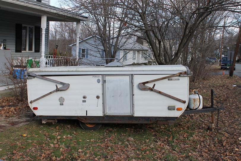

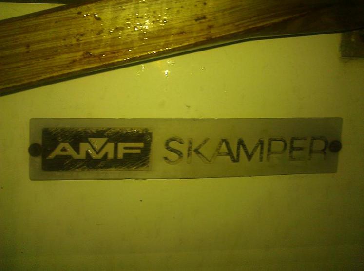

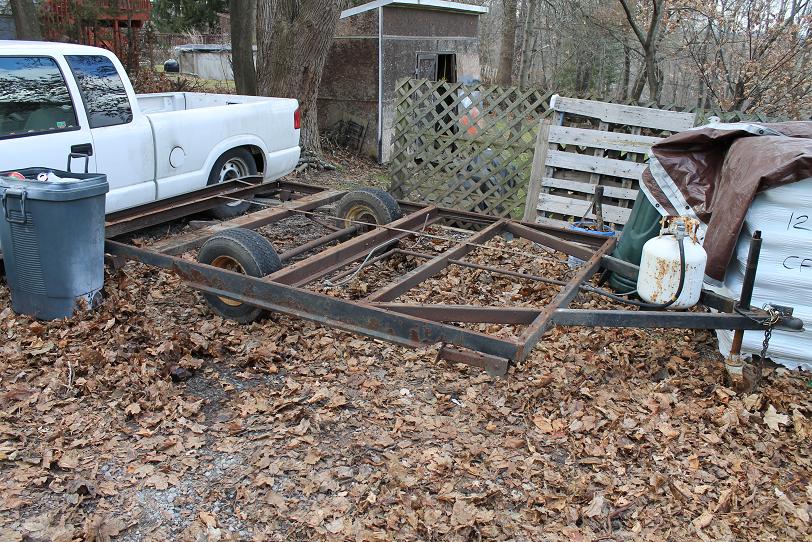

It was delivered after dark, and in the rain, so this is just a little tease until I can take pictures tomorrow. I found a pop-up on CL for $150.00. 75" x 110" frame, ideal for what I want. The axle has flanges so that brakes can easily be added. The tongue was so heavy that I convinced the guy to deliver it to my house (20 mile trip). Tomorrow I'll start tearing things out of it, some of which I may be able to make use of, sink, stove, cooler (i don't think it's a fridge), and it has a propane heater.
The best I can tell from my research is that it is circa 1970. Here's a pic of what it looked like before many years of neglect.

Postby Woodstramp » Sun Jan 01, 2012 6:34 pm
Paul,
Did you get to check out the shape of the frame? If not rust rotted or bent up I say you scored purty good for $150.

Postby parnold » Sun Jan 01, 2012 6:46 pm
When I went to look at it, it wasn't raining yet, so I did get down on hands and knees from several angles. It appears that there is surface rust, but none of the steel looks rotted.

Postby StPatron » Sun Jan 01, 2012 9:24 pm
Nice score, Paul! :thumbsup:
That chassis looks very similar to the Chuckwagon brand pop-up that I used, particularly that... not sure of the proper name... metal strip running along the frame, below the door. Rayvillian (if memory serves me correctly) warned me that it served a structural purpose and that modifications could impact the frame integrity. Just something to consider, it's of such similar design that it may apply to your model also. I cut part of it away in order to make wheel removal less frustrating. Another tip, you will probably find that when you attempt to remove that wheel, placing the jack under the frame vs. the axle is the trick.

Postby parnold » Sun Jan 01, 2012 9:32 pm
Gary:
Thanks for the tip. When I went to look at the trailer, the tire was flat and had to have the spare put on. Not only does the jack have to be under the frame, but the tire has to be slid upside down under the trailer, then raised up into postition from underneath. If you try to do it any other way the trailer has to be jacked way up.

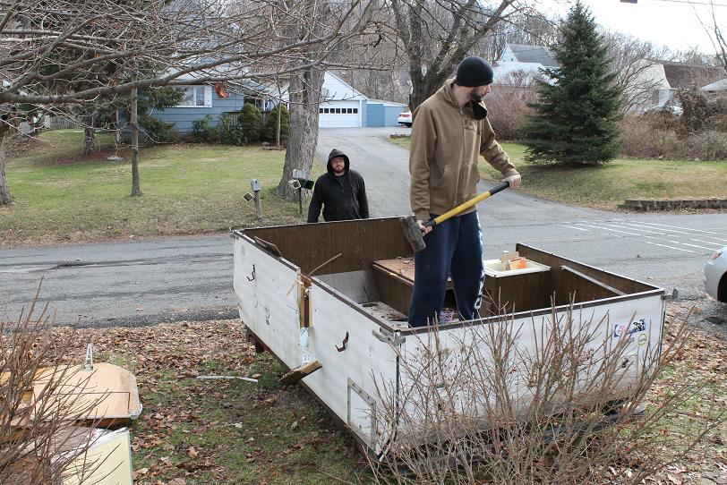

Today was Demo Day!
The trailer started looking like this:

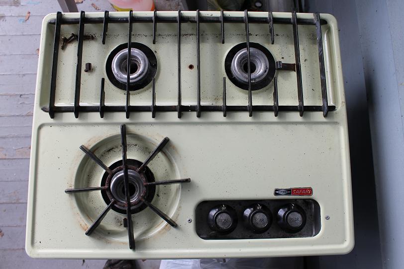

One nice find, this odd yellow colored stove looks like something I can use.

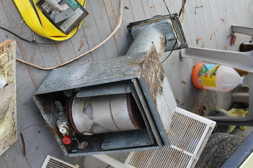

I'm not sure about the furnace, I will try to get it working. It might just find a place in my new trailer. It sure would open up a lot more camping time if I had a reliable heat source.

Postby Colemancooler » Mon Jan 02, 2012 8:06 pm
make sure there is no spider webs in the gas line, (spiders like the smell?) and clean the part that senses the pilot flame with some Scotchbrite, and you should be in business :thumbsup:

Postby parnold » Mon Jan 02, 2012 11:11 pm
I had help with the demo.
