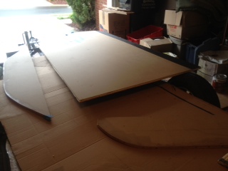

Well I have made some progress the last couple of weekends. I have my sides (MDO stretched to 5 x 9) completely cut and sanded. Thanks for the post on stretching my plywood. It worked beautifully for a first time router user. I got a great deal on a 1x used router with 6 brand new bits for $75. Of course my slot bit was $27. The splines are so beautiful even if I say so. My profile doesn't really look like a true profile. In my mind, it is a weekender with curves. Looks a bit like the whale profile I've seen. I freehanded it based on my material, trying to make the most of material. I'm sure many folks have changed their plans along the way.
My trailer went to the welder Saturday to be cut down, ammended and painted. I thank the member who posted his trailer picture featuring his bike rack hitched to the back of his trailer. I would have never thought of that without the great posters here!!
I will begin my coats of CPES this week on the profile ends. My trailer may be back this weekend (Memorial Day) so I should make a little progress. I will post many more pictures when i begin attaching the sides to the trailer.
Here is a picture of my profile. I had a volunteer to pose for the shot. I think I will have plenty of headroom and I am happy about that! As soon as I get the exact width dimension, I will order my doors, hinges, etc.
Thanks for everyone who has helped me so far. I visit the site daily looking for more inspiration, ideas and answers.

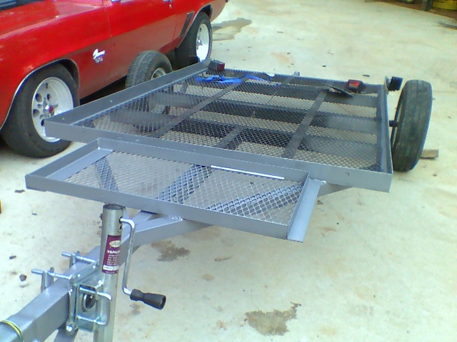

Got my trailer back after having the sides cut down and the tongue box added. The guy also extended my tongue to allow enough room for the jack. The rear leveling jacks are going to have to be moved. where they are they won't allow my sides to attach as planned. I will have those moved on Sunday. Hopefully next week I will be attaching my sides. Need to have it campable by the end of July! it is going to be hot work this summer. Still May and the heat is brutal.

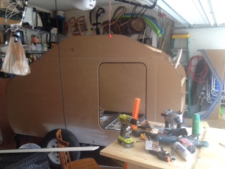

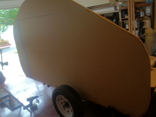

Last Sunday I spent a couple hours getting my leveling jacks moved out further away from the sides to clear the side walls. You can see the levelers pop up nicely on the side.
Today I got the first side completely bolted to the sides using 5- 3/8 bolts. I recessed the heads so i can cover/conceal them. It was a real sense of accomplishment but in the process of hopping on the trailer to tighten the middle bolt, i had my other side laying on the trailer propped on the tire where i had applied the alsphalt at the bottom of the inside and I carelessly put my weight on the side and the splined pieces popped. It was a sick feeling but within an hour, i had them routed out again and i have the top piece setting up with the spline glued back. I'll go back in a while and reglue the front piece. It could have been a lot worse.
I glued each side with different glues. I wonder which one was the one that snapped? The garilla glue or the titebond III? Any guesses? I reglued with titebond III.
Here are the pictures. I call the first one, The Thrill of Victory
:lol:
And the second, The Agony of Defeat.
:cry:

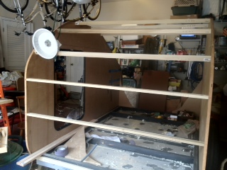

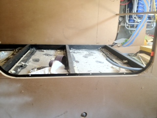

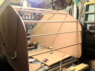

Postby CHUNKYMONKEY » Sun Jul 08, 2012 2:31 pm
It has been about a month since I last posted any updates to this build. Mid June I took a camping trip to make sure I was building all the amenities needed in my teardrop. Unfortunately I had a few misfortunes on the trip. I was stung by a yellow jacket, had an allergic reation, passed out as I was trying to get to the ER, as I fell to the ground I severly twisted my ankle and my leg. The moral of this camping trip was to be equiped for any camping trip with an EPI pen. My ankle is still not well but I've managed to get a few hours of work in this past week.
Second wall up last weekend and this weekend spars cut and attached and first door cut.
I ordered my doors, henge, fan, from Vintage Technologies and they arrived in about 5 days, just when I was laid up with my leg. I also purchased my air conditioner just prior to the camping trip. Last week I ordered the AC/DC panel on eBay. I'm about ready to begin running the conduit under the floor for the AC wire. I also puchased some primer to begin priming the sides before I get too much obstruction mounted to them.
It has been so hot I've been blowing the air from the house into the garage with the door closed. It still is hot but much more bearable. I don't look forward to seeing the Georgia Power bill! :sweaty:
Here are a few pictures of my slow/go progress.
:pictures:
Thanks for your continued feedback. I could never have gotten this far without the resources of this forum.
