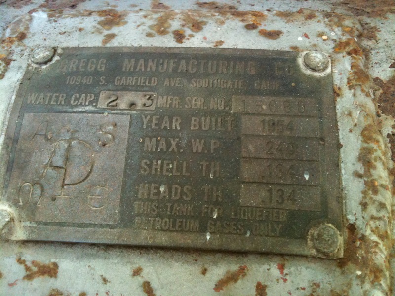

Postby stevegsmith » Wed Aug 01, 2012 4:04 pm
Tank tag close-up pic.
I'll stop posting other crap now. Ted, keep on keeping on and let me know if you want any more shots.

Postby TRP » Wed Aug 01, 2012 10:10 pm
Steve,
What tank is that plate for? The water tank? or the propane tank? That company on your name plate is the same company who makes the propane tank on my Benroy.
You and Real550A are pretty fortunate to have purchased trailers with complete or nearly complete kitchens/galleys. Luuuuuucky!

Postby stevegsmith » Thu Aug 02, 2012 8:52 am
TRP wrote:Steve,
What tank is that plate for? The water tank? or the propane tank? .....
Cheers,
Ted
Propane tank.

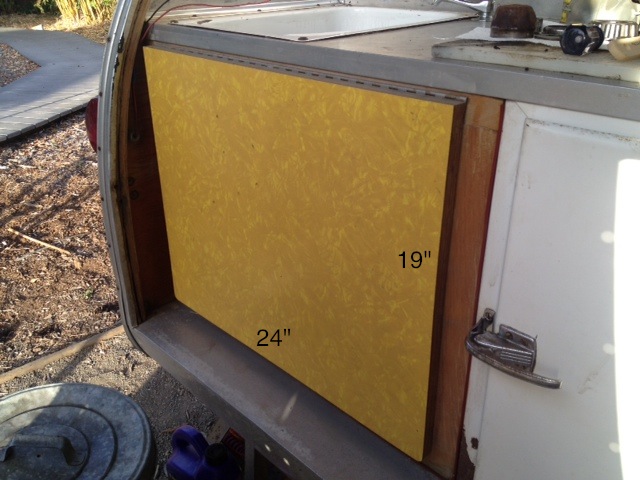

Postby TRP » Fri Aug 03, 2012 5:59 pm
Steve,
What are the dimensions on that flip up table?
T

Postby stevegsmith » Fri Aug 03, 2012 10:09 pm
TRP wrote:Steve,
T
Hi Ted.
3/4" Ply with formica top.
24" wide x 19" long.
When I began reading your first line in the last update, I thought you were talking about the skin on your finger. What a relief.
