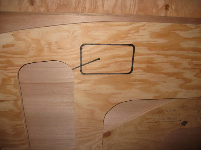

After the walls, I had to figure out where all the interior and exterior lights were to be installed. After positioning them I outlined them all and drilled holes through the sidewall sections for the wiring before I put on the interior wall skin. This is for the porch light.

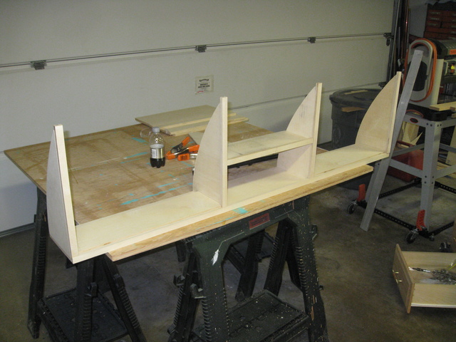

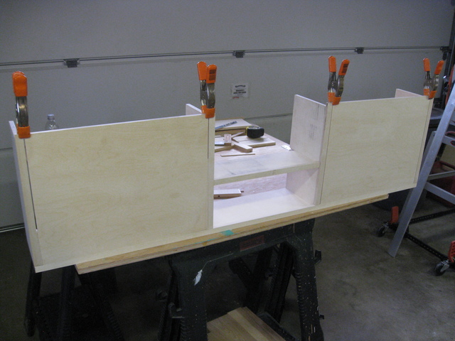

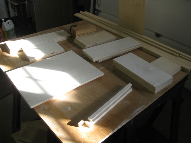

We started by cutting out the pieces for the front cabinets! They are mostly 1/2" birch ply with one section of 3/4" birch for the head board section.

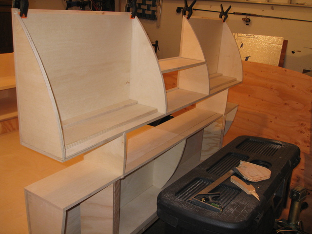

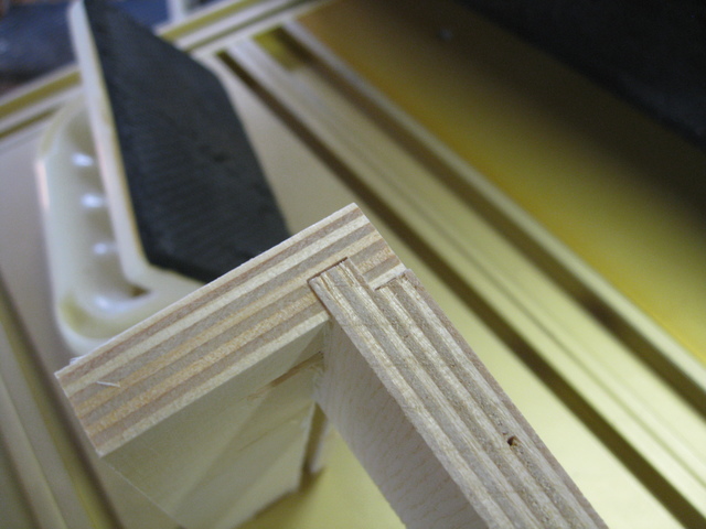

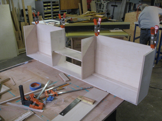

We decided on tongue and groove which I must say is very cool and adds much stability. This also adds a bit of work to get the height settings of the tongue and groove bits correct so the pieces match up correctly. It also took some extra time to cut the groves in the middle of a few pieces with a straight edge and a 1/4" straight bit. Chip out was a problem as well but we managed to fix that by taking a shallower cut first, and reducing the speed of the router on the groove cuts. I am learning a lot!
And here we have finished cabinets! I love the way they just snap together, it makes dry fitting that much easier!
Using the template for the inside section of the wall I was able to trim the cabinets to fit the profile nicely.
Next weekend work on the back set of cabinets begins! Now that all the experimenting is done these should hopefully go much quicker!

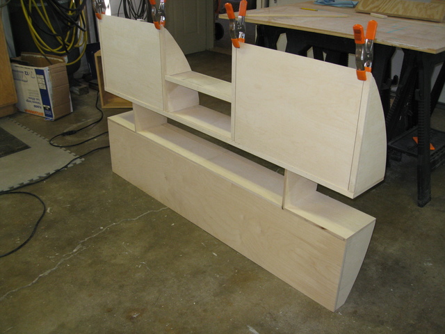

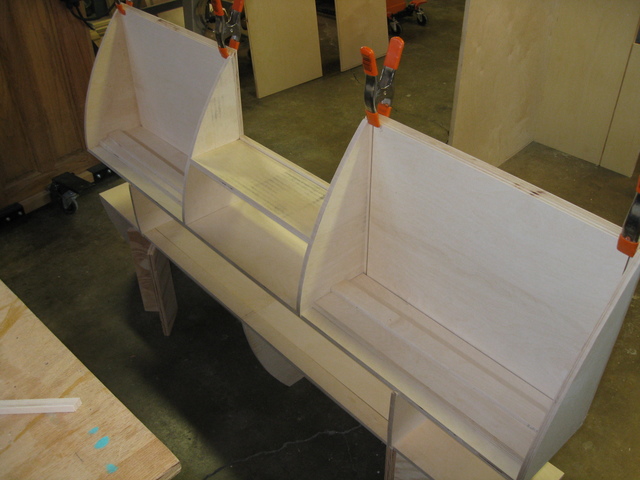

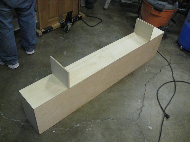

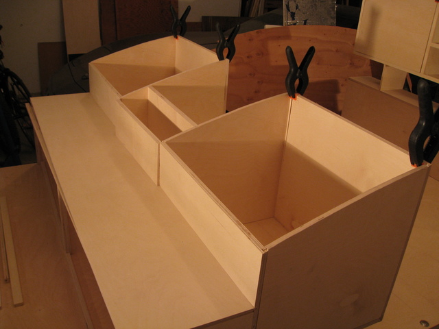

Another update from the last couple weekends, the galley cabinets are now finished for the most part. All cabinet panels and pieces are cut and matched to the profile of the inside wall, tongue and grooves are cut, and the edges are bevelled to match the curve of the profile. Whew that was fun, and it went a lot faster than the front cabinets now that I had a better idea of what I was doing.

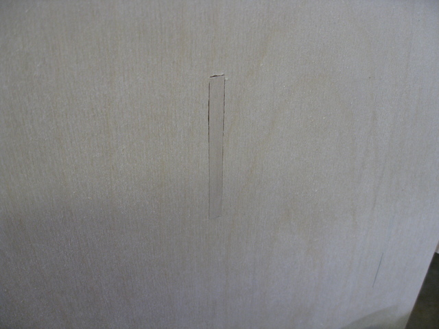

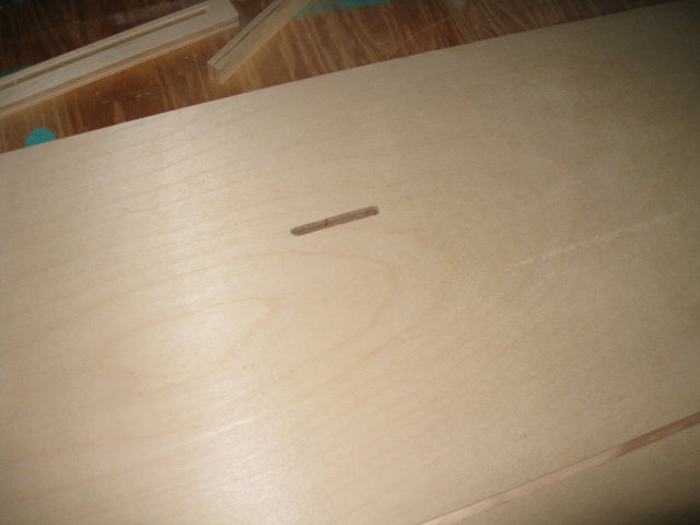

In all that I managed to make a couple mistakes. Actually the only big one wasn't all my fault, when cutting a groove the router bit slipped out of its collet and went through the other side... :(
The good news is that it will only show on the inside of a cabinet so we went ahead and made a plug to hide the mistake.

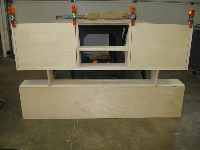

The finished front cabinets.
As you can see the back of the cabinets match the curve of the profile. If everything goes well I should be able to drape the headliner panel over this curve and make my life easier down the road.

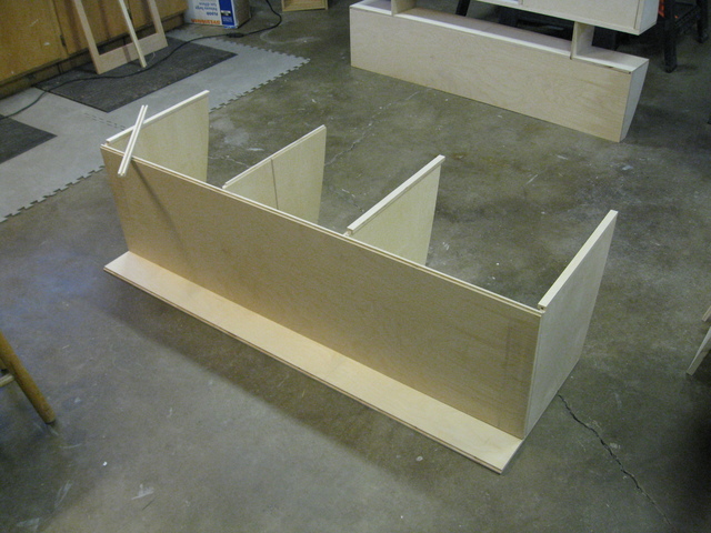

Since this is all dryfit at the moment the back/galley cabinets don't support themselves with just the tongue and groves. Here is a picture of part of the back cabinets laying on the floor.
The next step is sanding all the pieces and making sure every joint fits flush before gluing it all together. Soon enough it should look like a teardrop and not just a bunch of parts in a garage! :D

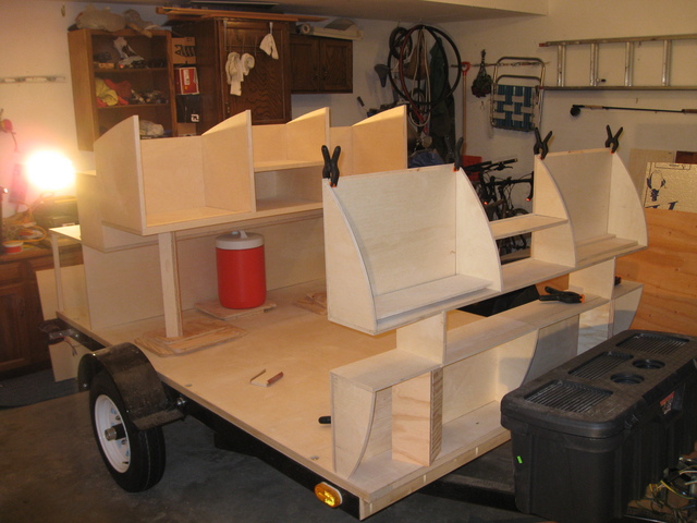

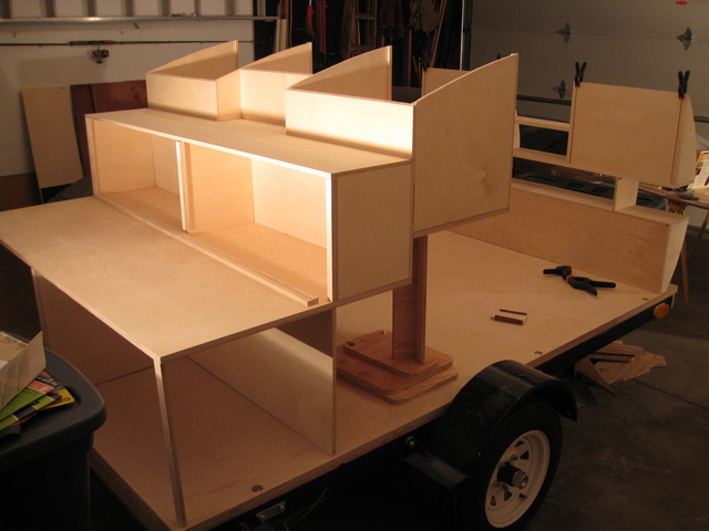

I was so fired up completing the cabinets I decided to take some time this afternoon to get them set up on the trailer. I couldn't stand to wait until this weekend before I could get back to building. :D
Getting the galley cabinets up was a bit of a pain, as they are held together by tongue and groove and a few braces and clamps. One good thing about getting them completely assembled was that it allowed me to spot a couple places where I will need to spend some time getting everything flush. Besides a couple small issues I couldn't be happier!

Ha, yes looks rather different but cool. Doing it this way lets build, assemble, and square everything beforehand, then when I put it in the trailer as long as it is square and to the proper width, it should (theoretically) fit very snugly.
