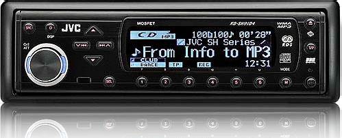

Like you all, I've been telling everyone about the project and bouncing ideas of technical folk. Stewart, a maintenance engineer I work with, is no exception. We had a long discussion about sound. Turns out my radio does not have an input connector as I thought; it has a subwoofer output. We discussed the options at length and I decided I would hunt for a 240v mini sized HIFI in the local tip. They have a skip designated for electrical waste. This morning he walked in and donated a radio to the TD build. "It was cluttering up my shed" he said. It's ideal as it has an aux in port so I can connect Ipods and pc's into it.
My trips this weekend to the dump should realize speakers. The good stuff people throw away is frightening.
Last weekend, I picked up a rusting towbar, with a good towball and a well used griddle that needs a 2 seconds work with a welder. I've since seen the same "antique" griddles for £30 or £40 .....
