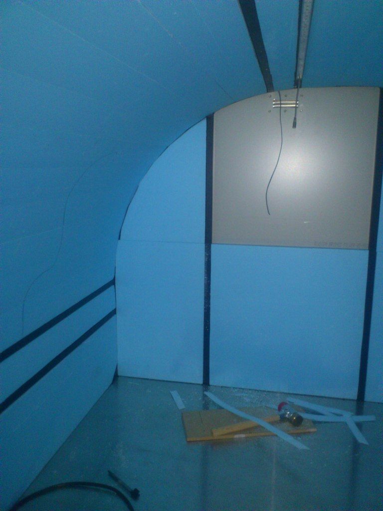

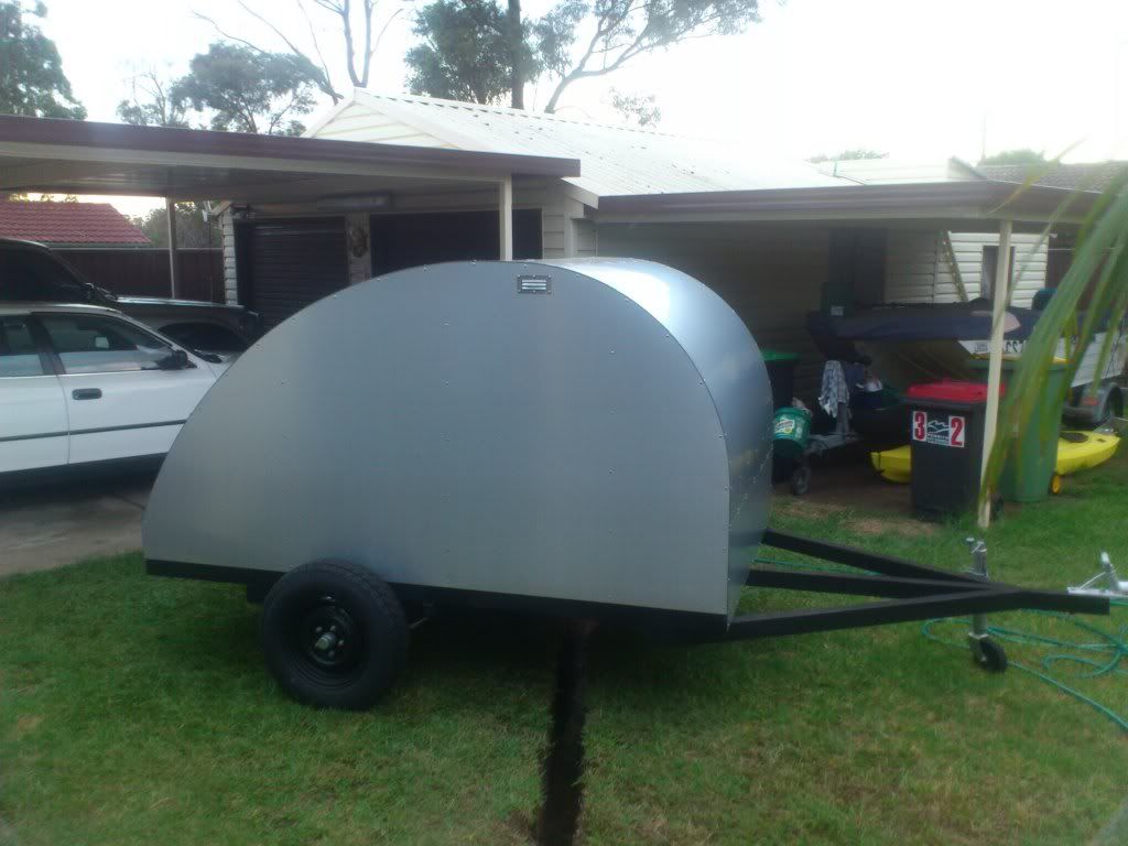

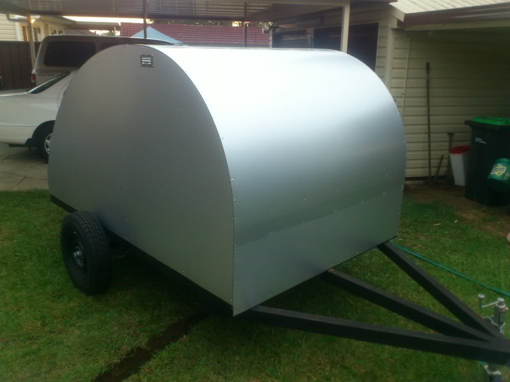

i just thought id up load a few pics of the teardrop after we removed the plastic skin
i also chased up a few internal leaks with some sicka

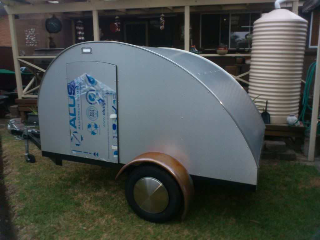

i went out and bought the sail track during the week i could only get a 6.5m length so i got it docked in half took it home measured it from rivet to rivet and it works out like i knew what i was doing with no waste no daggy end and mounts perfectly to the van shell making it bend to the profile of the van was the biggest problem as it is thicker on one side than the other as i curved it around the vans edge it twists and pulls but nothing a extra set of hands couldn't fix
the sail track now covers the join that the side wall and roof sections made and with enough over hang to stop rain run off down the walls as well as providing somewhere to mount the awnings off

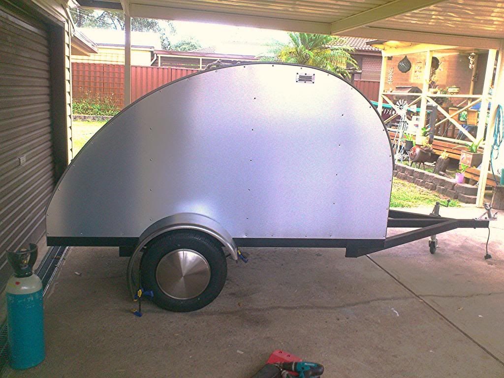

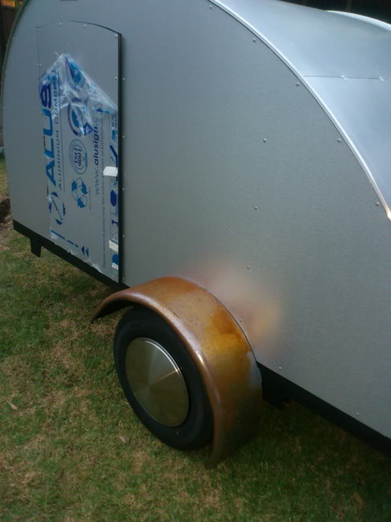

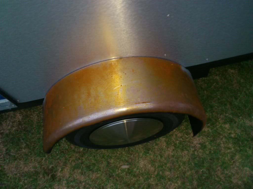

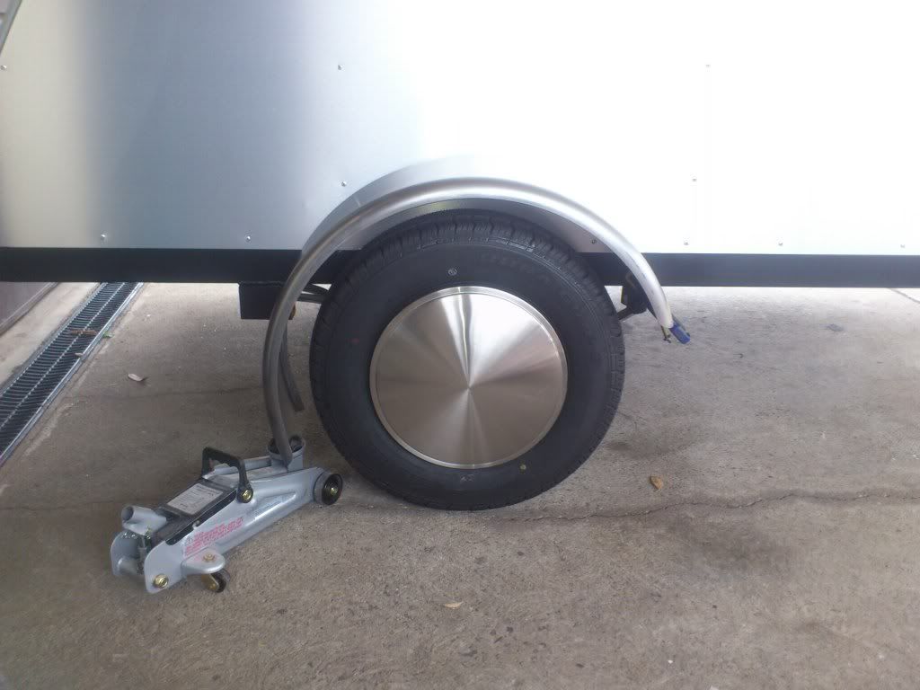

the guards turned up today i mucking around with fitment of them im planing on leaning the guards back so the front of the guard is level with the bottom of the frame of the trailer and the rear of the guard is lower so i might not need mud flaps
have a look

Postby dean_petley » Sat Mar 29, 2014 4:47 am
guards all mounted uo and left in the rain over night

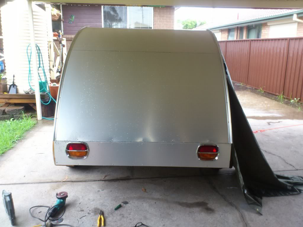

Postby dean_petley » Sat Mar 29, 2014 4:52 am

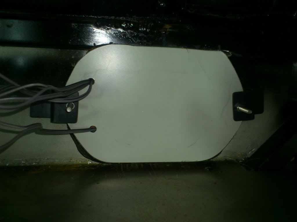

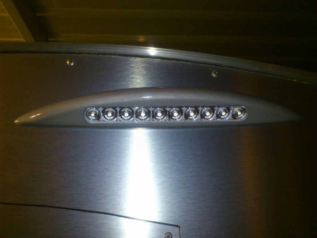

i have been a bit slack lately i got stuck in today and finished mounting the rear ej tail lights i have a few swear to impart to who ever put the thought im my head about using ej tail lights there was a lot of cutting grinding hammering welding and o so much swear
but there in
well just sitting there at the moment until i make some mounting brackets
i had to remove the buckets in order to fit the lights the bucket was simply to big to work so i made my own backing plate and i am now going to run led strips inside the lights to save some room over the old incandescent lights

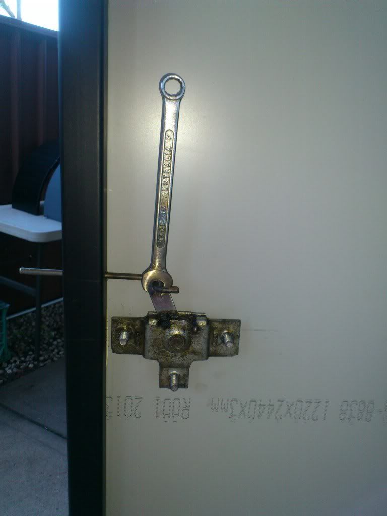

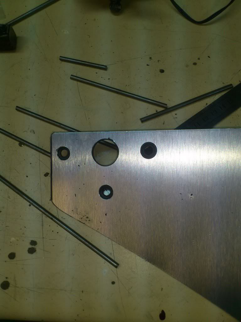

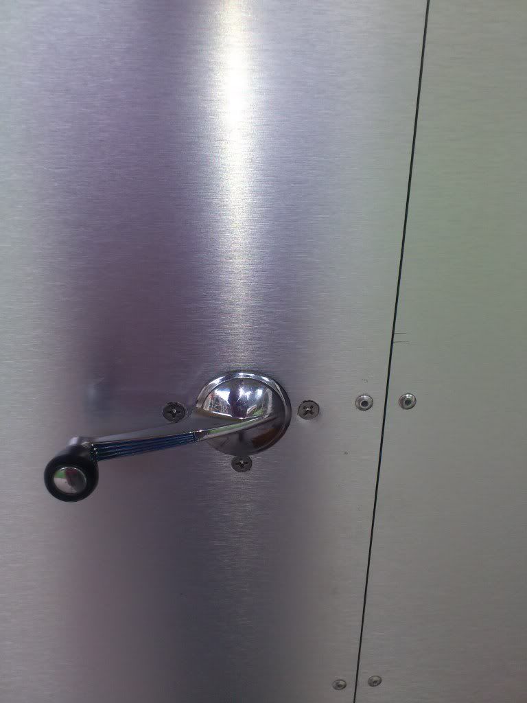

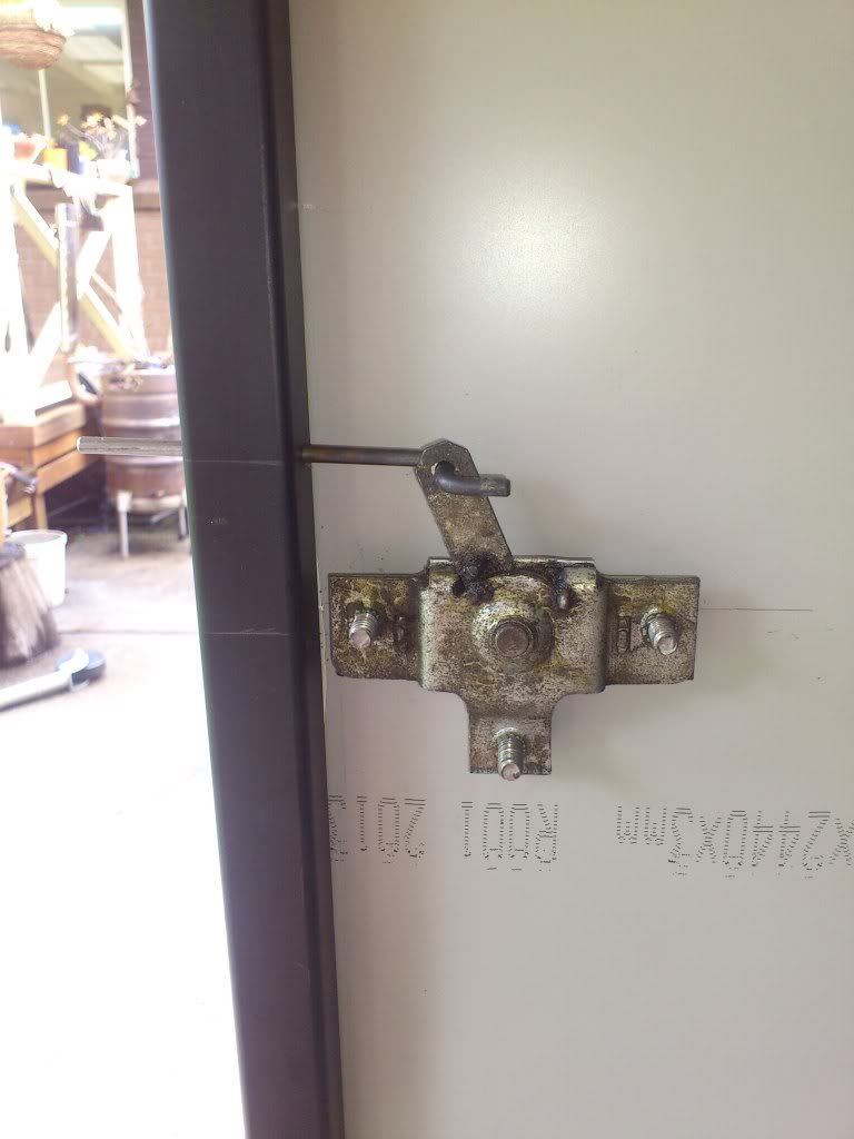

and the next job was a door handle now i wasn't just going to bungings and get on off the shelf thing like the old man was telling me that would look like :thumbdown:
so i raided the parts draws and found an old door mech from an ej :thumbsup:

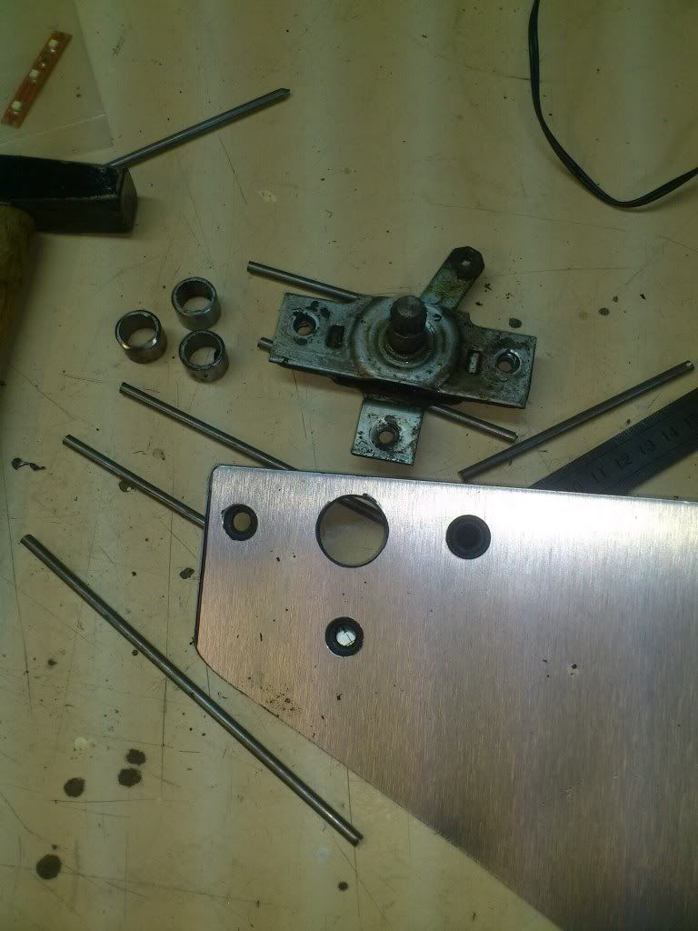

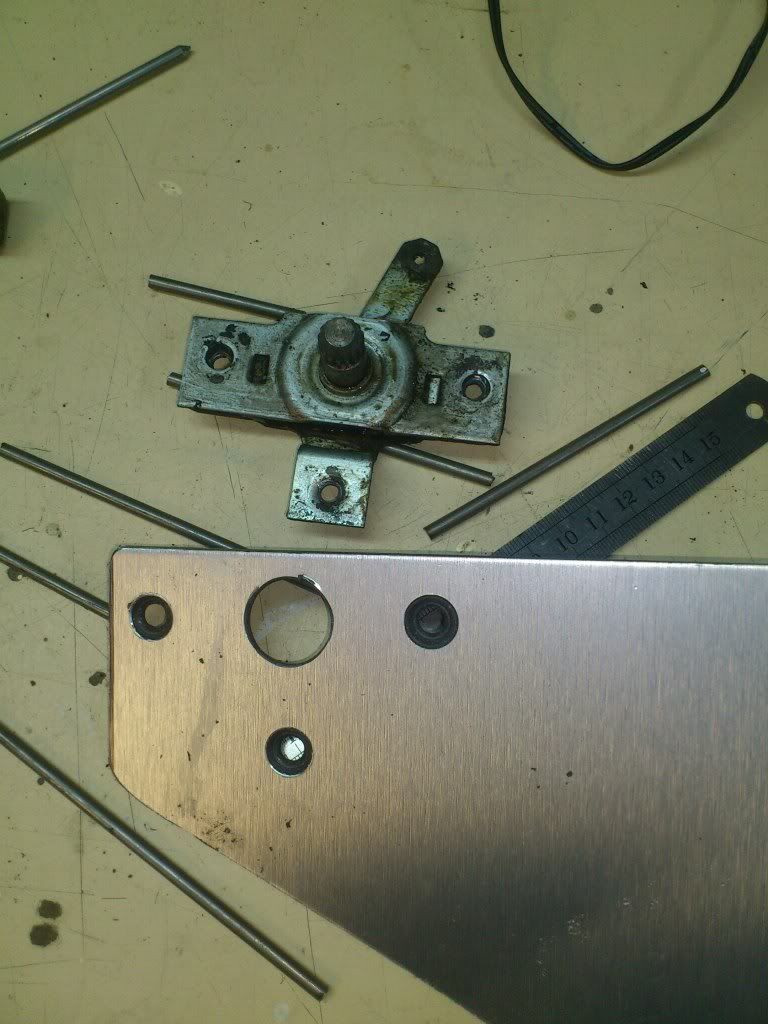

i made a temp and started drilling
then i made spacers to move the mech back a bit so the handle wasn't so far from the face of the door
then i marked the door
THEN reboot the phone went flat so ill get some more pics tomorow

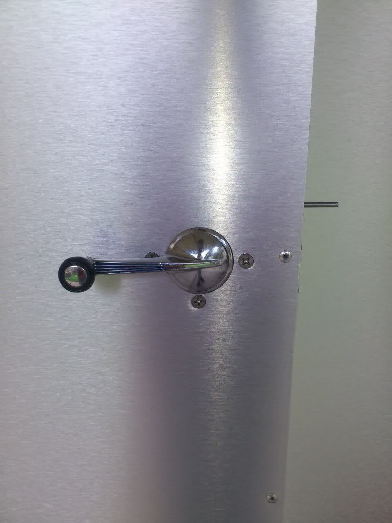

Postby dean_petley » Sat Mar 29, 2014 4:55 am
i have a window winder handle on it at the moment looks a bit stupid but the door works

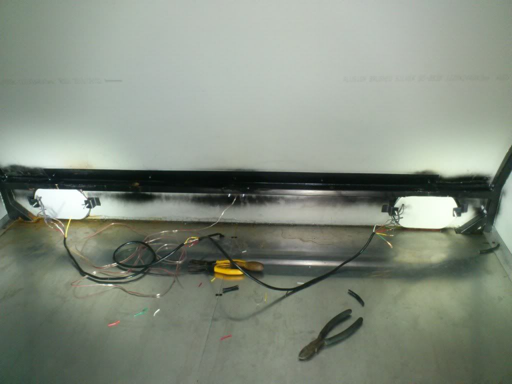

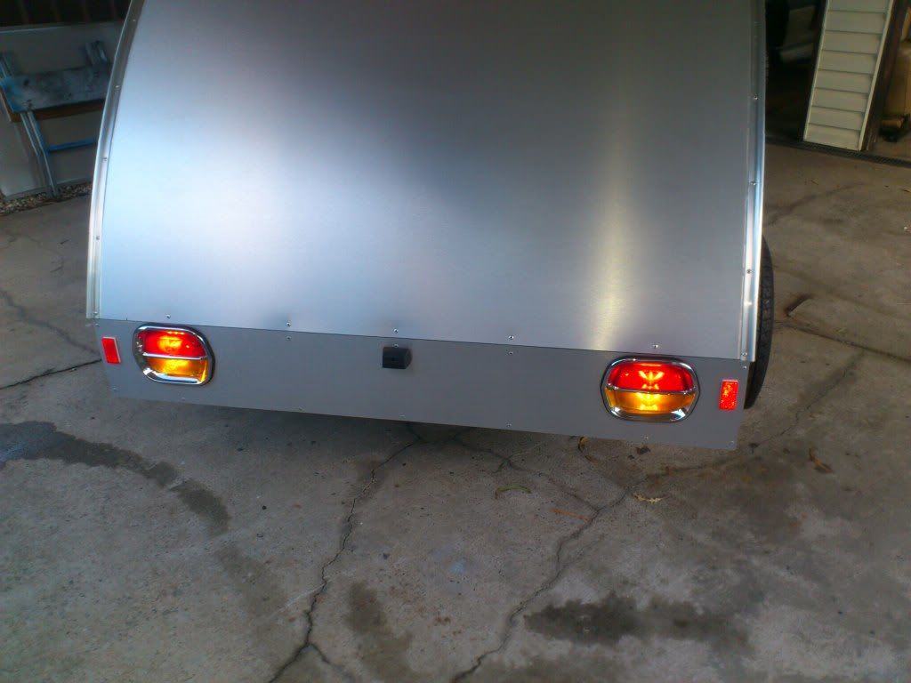

today i made the mounting plates i made a new rear cover for one of the lights i finished the led conversion and tested the lighting as ell as that i took a photo of the inside handel on the caravan
this is the rear of the light assembly with mounting brackets
this is a better overall shot of the back from the inside the wiring is only to test the lights
this is the internal door handle made from an odd spanner from the odd spanner box
and my lights all wired up and working first go i still have the touch when it comes to wiring Laughing

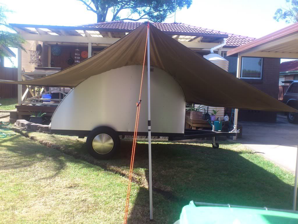

Postby dean_petley » Mon Feb 08, 2016 6:16 am

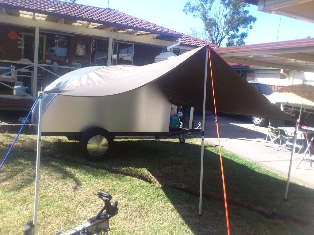

its realy been a while bit its all done dusted driven and sold
i sold it to my old man he wonted it from the day i built it
so im going to have to make a new one but here are some more pictures
i have done a few km in the van three trips to aulbry one to tumit and two bendalong three to coolendel best part of 7000km with no issues at all
